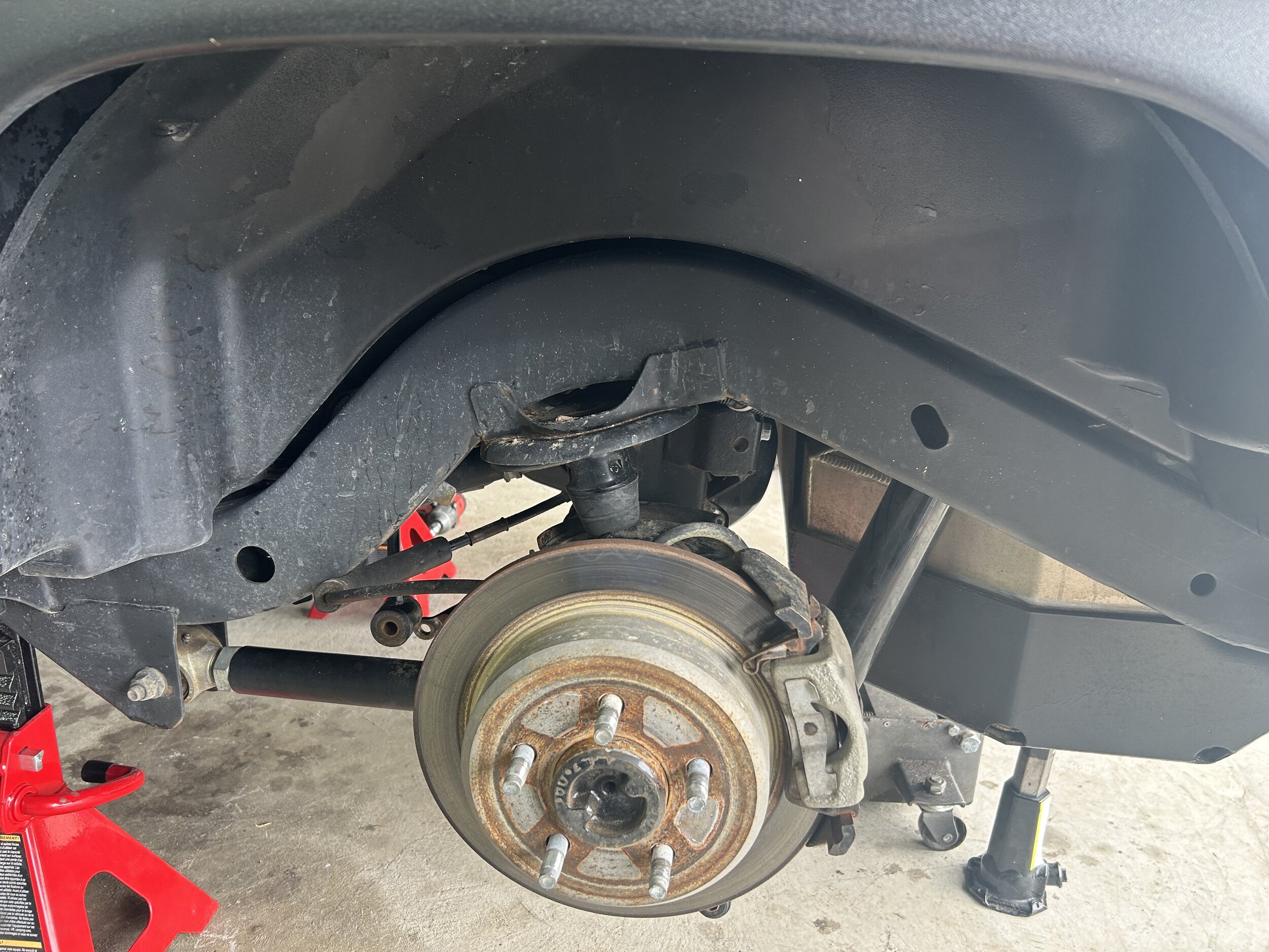

So bringing this back up. I am now debating on doing this after cycle testing. With the short arms I can maybe max out the bolt on Fox 8.6” travel shocks. Some kind of bind stops droop even with disconnecting the sway bar and shocks. Raising one side I do get more down travel on the other side, but there are more times where I need the down travel with both sides simultaneously. And also trying to retain the track bar looks like a PITA but it looks possible?
So now I am looking at the idea of a long arm, I was thinking of using a UCF bracket with some preferably used RC arms and get some Johnny Joints in there. Which I think this wouldn’t be such a bad idea since I can move the double adjustable Johnny Joint short arms to my LJ that is going to do more conventional Jeep stuff. Thoughts?

I do more higher speed stuff like in sand and have been airborne before. Its my wannabe pre runner that does pretty well over smaller washboards and bumps but could use some extra travel in the rear for the larger bumps I have hit.
As it sits, I can get about 5 to 5-1/2” up and like 3 down with the axle staying level through out the travel. Pushing one side down, I can get it to go 7-1/2” down from ride height which exceeds my springs free length by about 1” and would exceed the bolt on shock I am looking at but not by much, and with the LA making it a more straight travel I think it would fall within the shock travel a lot better since quite a bit of the shock travel is the axle moving forward.
I really wish there was a way of seeing where the binding is, but there’s nothing visibly apparent where it is binding. All the joints and arms are not rubbing on anything. I just know after I get to a certain point it really fights me I’m trying to push the axle further down..
I understand most of the people’s lack of love for long arms out West and thats why I am keeping my LJ short arm since that will be used on trips out that way, but I don’t do the crawling they do with this particular TJ. I just go 5hrs north into MI, go have fun out in the sand dunes for an extended weekend or 2hrs south and enjoy the many of the large dirt trails around KY and Appalachia.

12" shock travel on rear short arms is common. I've done a few.
The track bar is creating the bind. However, when 3500lbs of Jeep weight is reacting against the bind, things will move effortlessly.

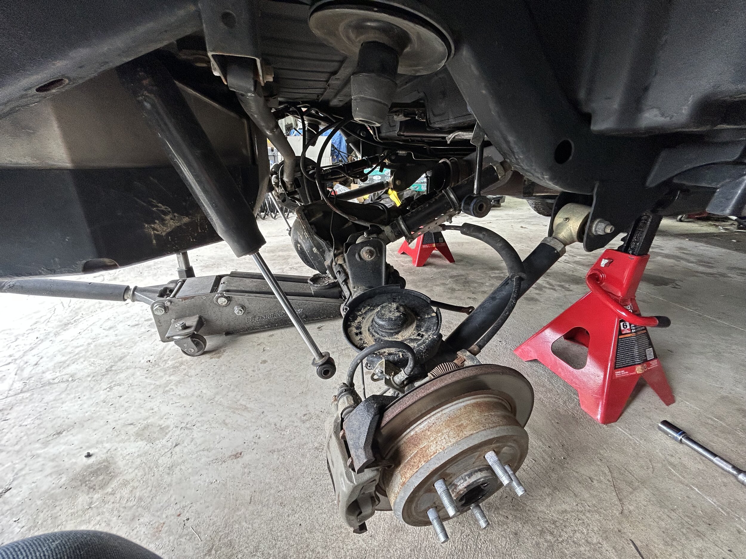

Loosen the track bar and stand on the drooped side
Loosen as in just back the bolt a little or loosen as in completely remove the track bar from one end? My track bar has JJs on both ends, so they should be spinning freely as is.
Then stand on the drooped side.

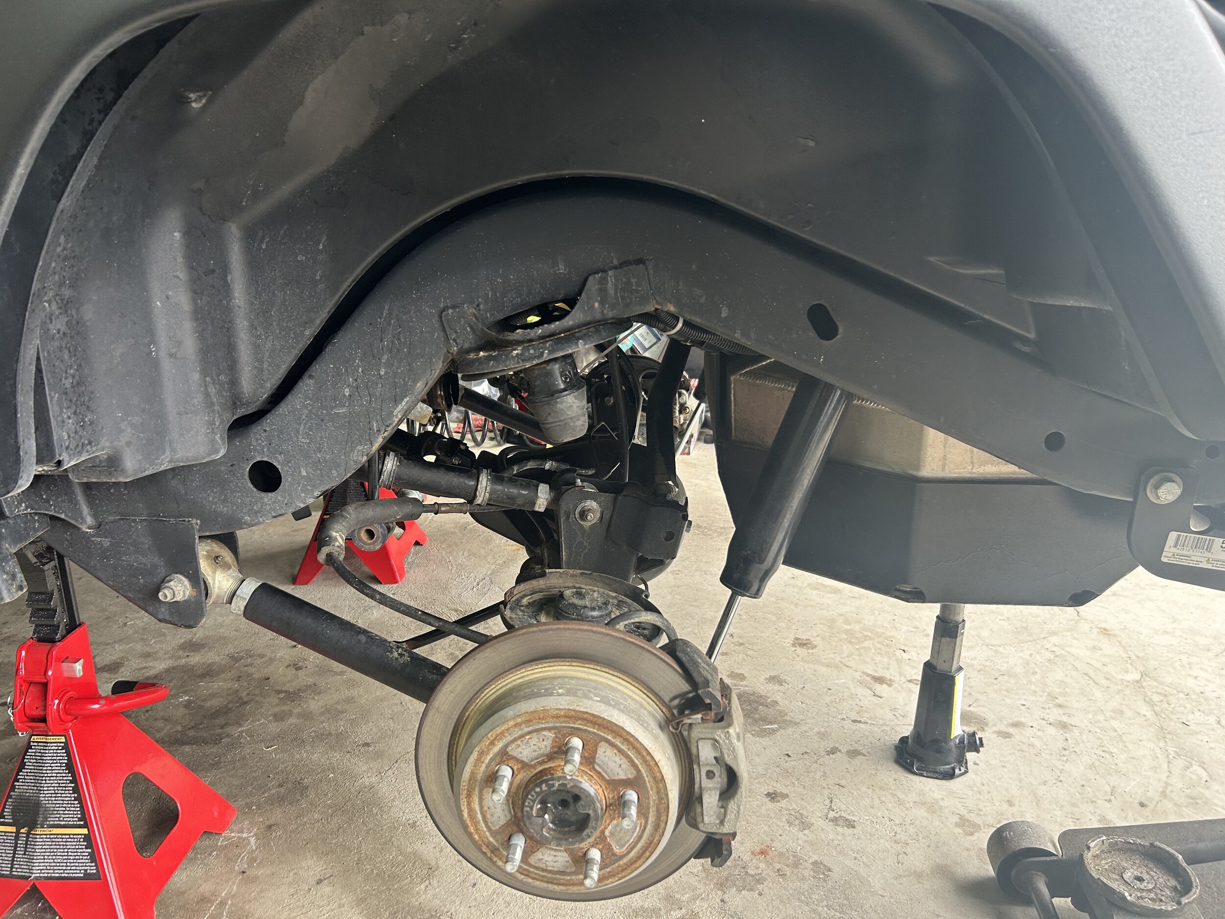

So this what I get standing on drooped side. Raises the other side up a little.
Measure between the spring seats. Currie coils are just long enough free length for 12" travel shock at about 17.75".
17.5ish” and a little extra force by jumping on it I can get it a bit more.
Then you are in good shape. No need for a long arm because that has no bearing on what you are trying to achieve.
