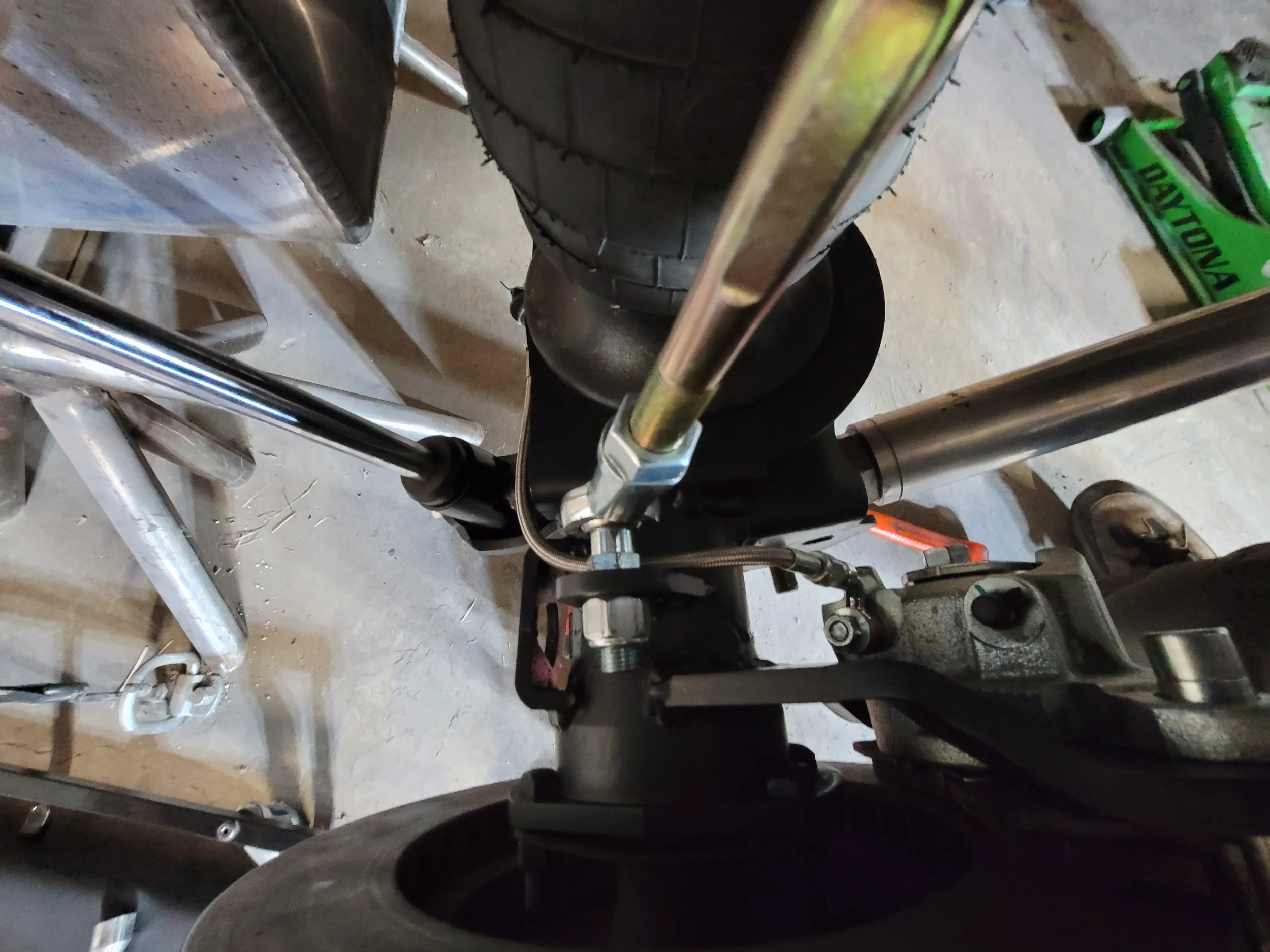

All 4 Wheelin' Jeep dogs are people too Original poster Lifetime Supporting Member Joined Jan 4, 2019 Messages 1,986 Location Washington State Today at 4:59 PM #1 Can outboard shocks and antirock sway bar exist together on the rear axle?

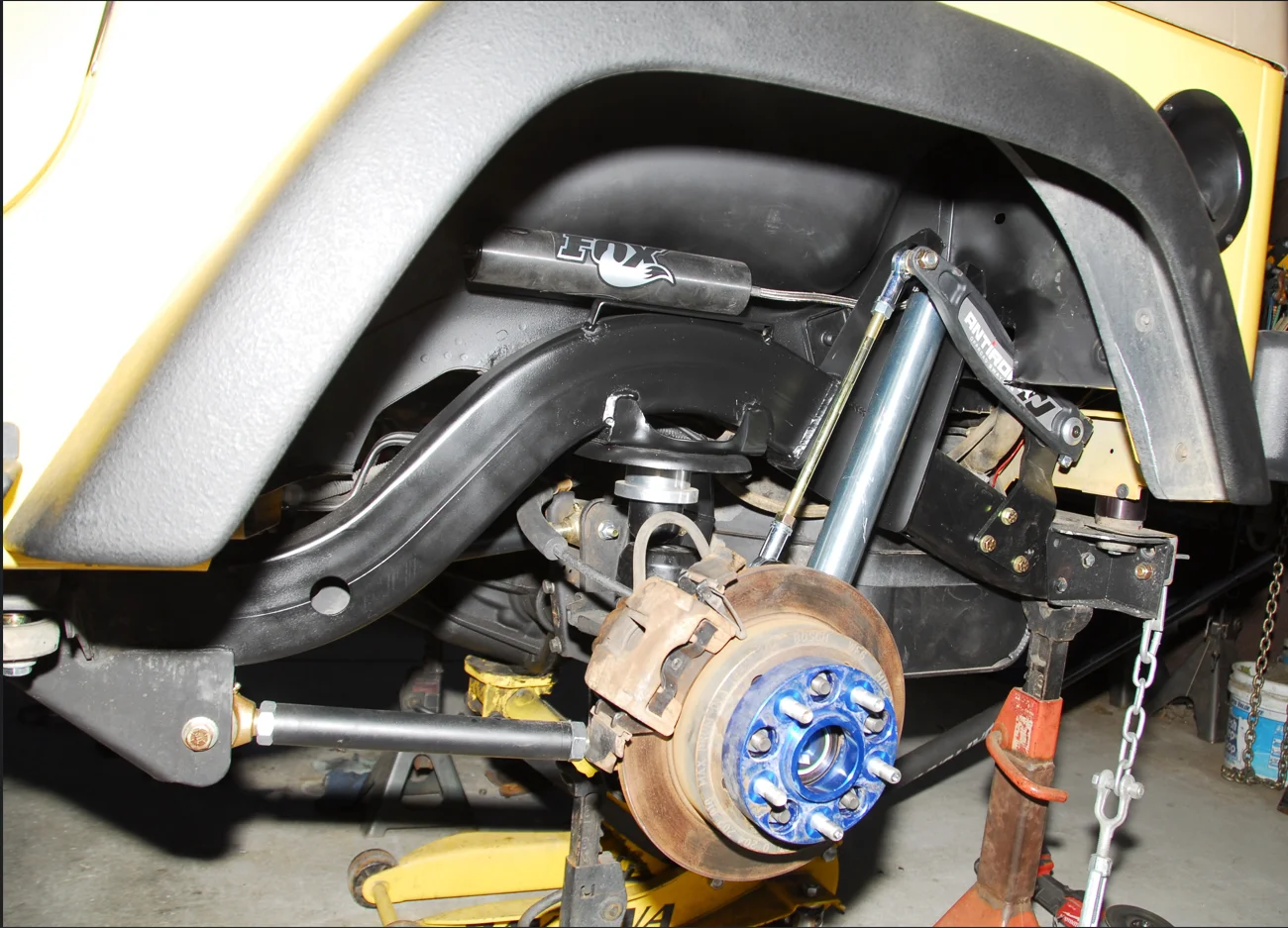

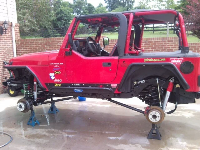

Wildman Over Analyzer Extraordinaire & Attention Whore Staff Member Supporting Member Joined Dec 12, 2015 Messages 58,215 Location In the hills of WA Today at 5:14 PM #2 All 4 Wheelin' said: Can outboard shocks and antirock sway bar exist together on the rear axle? Click to expand... Depends.... My anti-rock is forward of my axle since I'd stretched my rear axle 5"... But Blaine has posted more than one picture of a outboard and anti-rock.. Reactions: All 4 Wheelin'

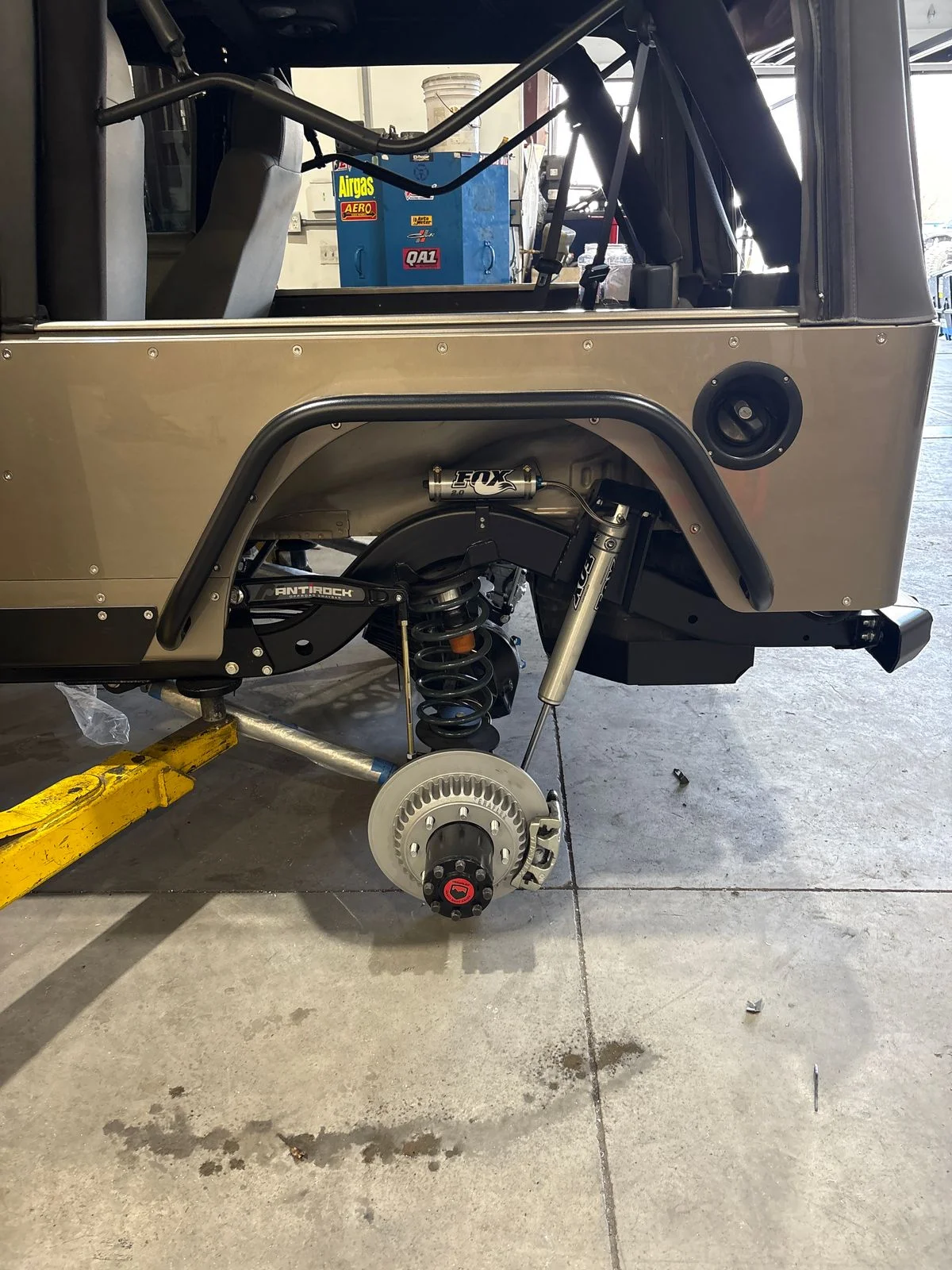

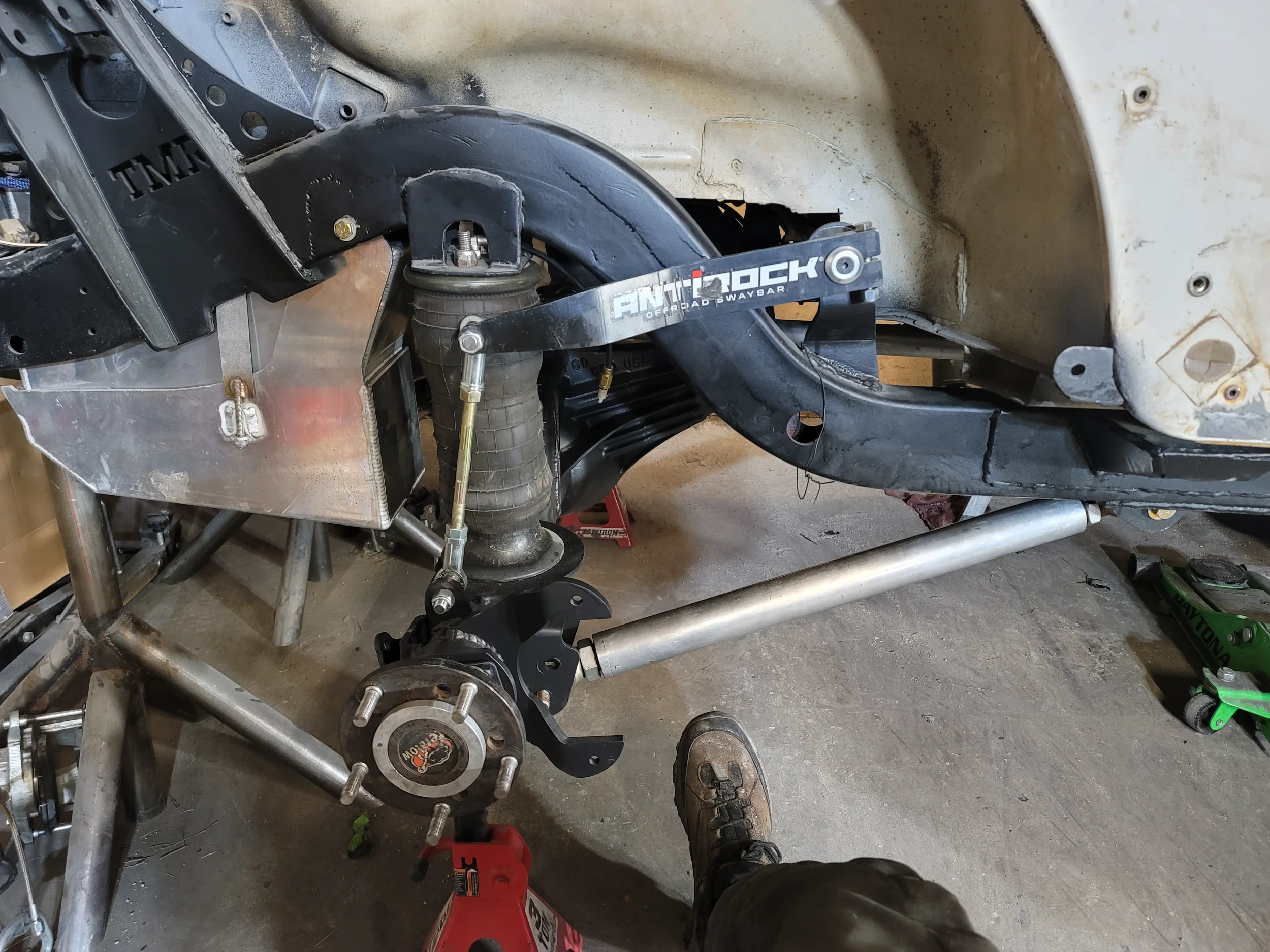

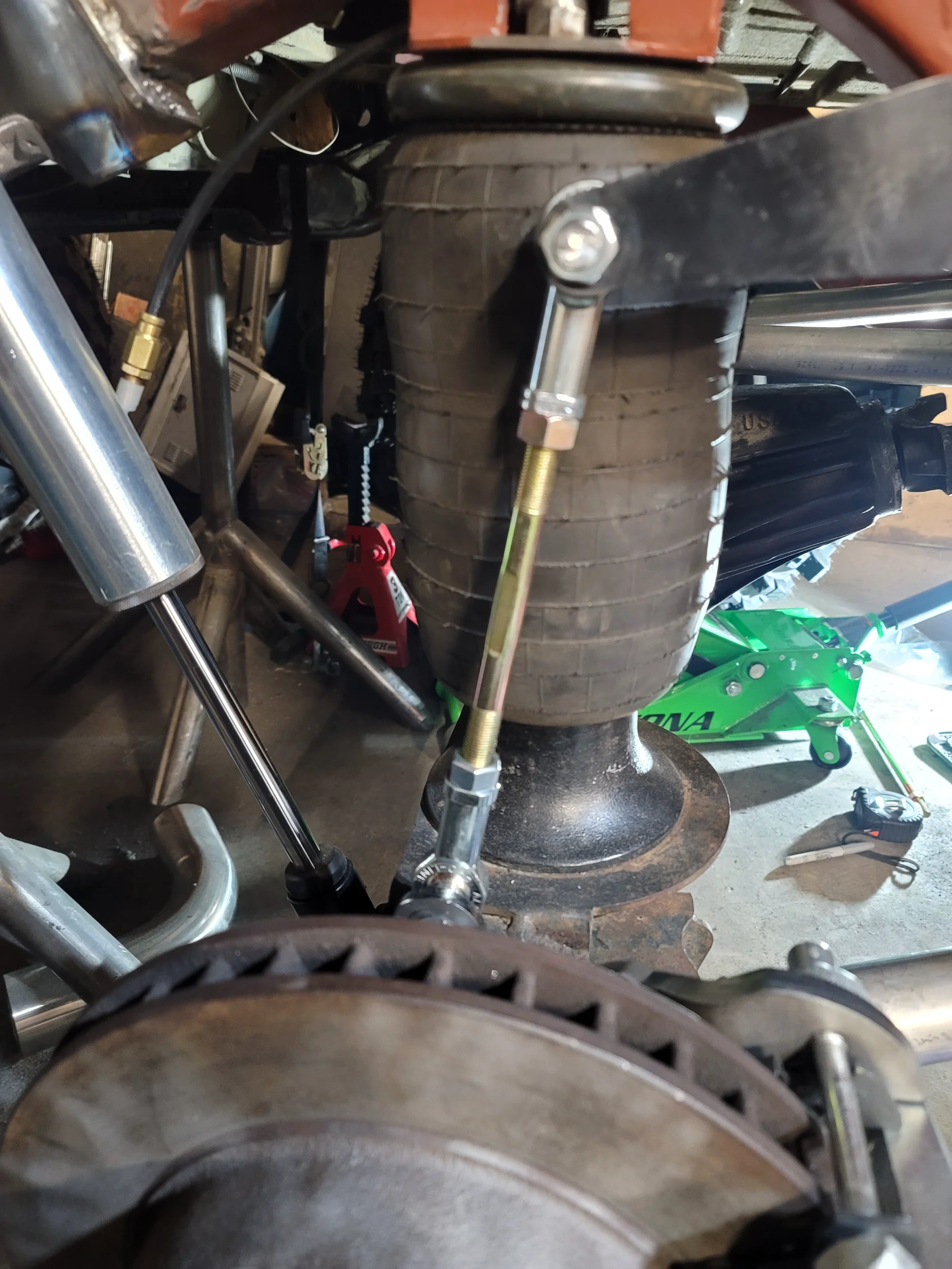

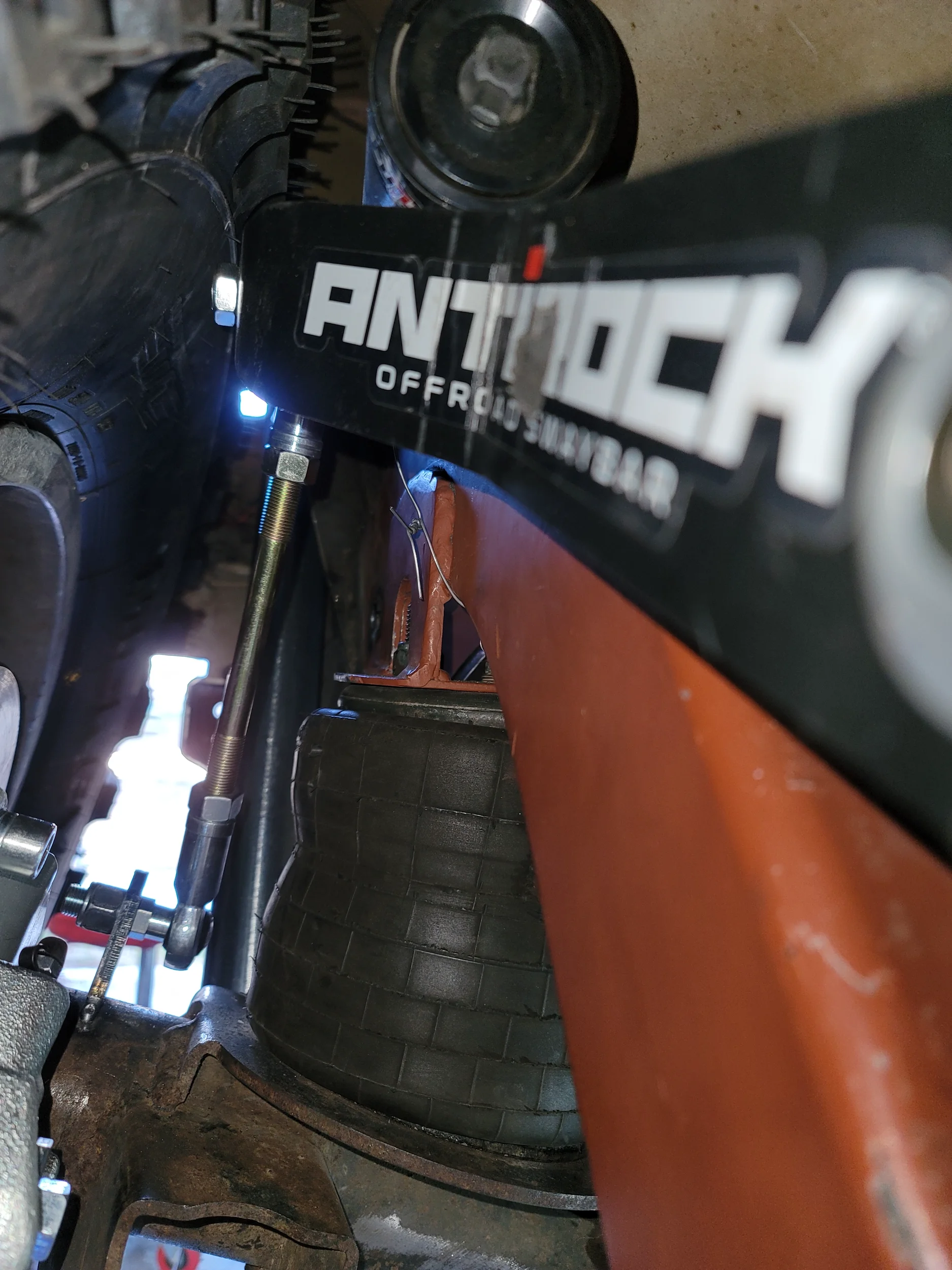

jjvw AI Moderator Staff Member Supporting Member Ride of the Month Winner Joined Feb 17, 2018 Messages 31,048 Location Colorado, USA 14 minutes ago #3 All 4 Wheelin' said: Can outboard shocks and antirock sway bar exist together on the rear axle? Click to expand... Here's one! Reactions: All 4 Wheelin'
All 4 Wheelin' Jeep dogs are people too Original poster Lifetime Supporting Member Joined Jan 4, 2019 Messages 1,986 Location Washington State 11 minutes ago #4 That's kinda what I was picturing as a possibility.
