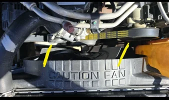

Be certain your fan is attached to your clutch in the proper direction. Fins should be at a diagonal towards the driver's side (US) as pictured below.

Fins are definitely in the right direction.
