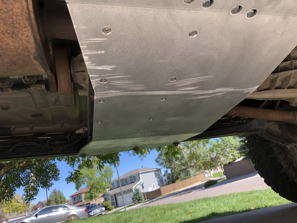

Doing that on a stock skid would have been difficult. The Savvy has a bunch of its first scars, which means the upgrade was worth it:

* Skid got a lot of nice gouges and the bolts loosened a bit. Do people use blue locktite on these ever?

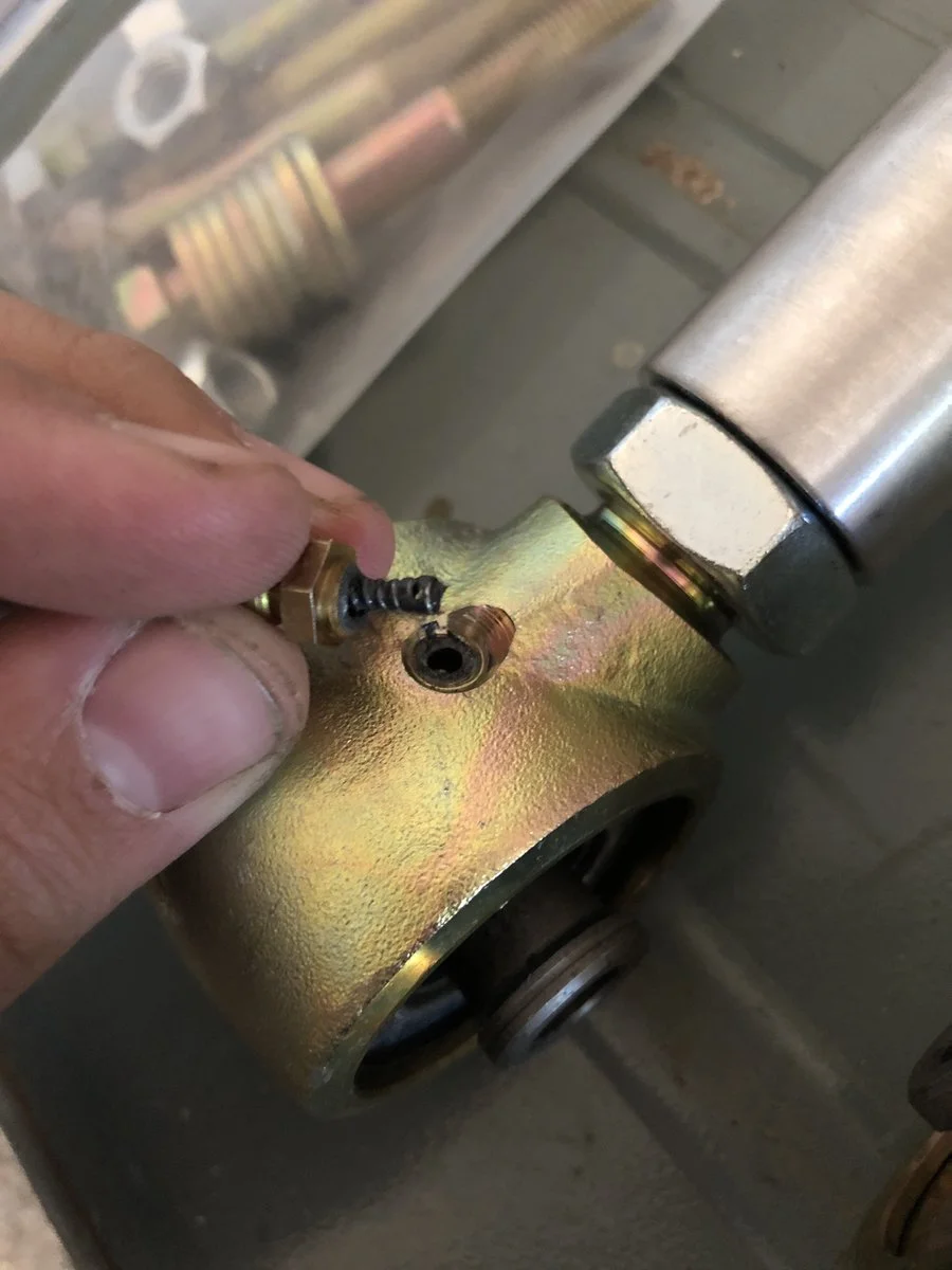

As a follow up getting home, the savvy UCAs got here. Looks like a grease zerk got damaged in shipping. Does anyone know the right size to replace these with?
edit: savvy shipped a new joint out instead of having me drill this out and replace the zerk.

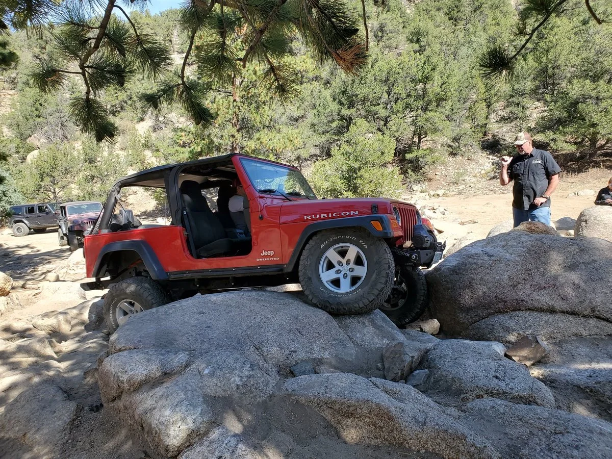

I am shamelessly stealing this image from @jjvw 's build thread for documentation of where my build currently sits and some follow ups.
1. The new skid is so close, but there is sunlight - neat. Some hex bolts made enough contact to tell me they wont stay as "hex bolts" for long - at least the rear bolt on either side.
2. The front passenger tire tuck is useful, I thought I was close but it's nice to see it under stress with deflated tires.
3. I should take my tires next run down to 10psi. I wasn't really wanting for traction, but I think more could be useful.
4. It's easy to see why body mounts could catch (looking at the rock on the driver side and some dings after).
5. I rubbed the AR a bit during turns, so I need some wheel spacers since the steering stop washers didn't do the job under flex. I thought I was hitting my LCAs when deflated...
The follow ups:
* Wheel spacers once I figure out 1.25" vs 1.5" (I may do all 4 for symmetry, even though only the front looks to need it)
* Sink the bolts into the skid
* Collab on bumping the body mounts and removing the BL spacers
* Cycle the suspension more and maybe add the 0.75" spacer up front (not obvious from this image)
* Evaluate rear clearance on future runs. Do I need to pull in the bumper and up the gas skid, or are they okay where they are?
