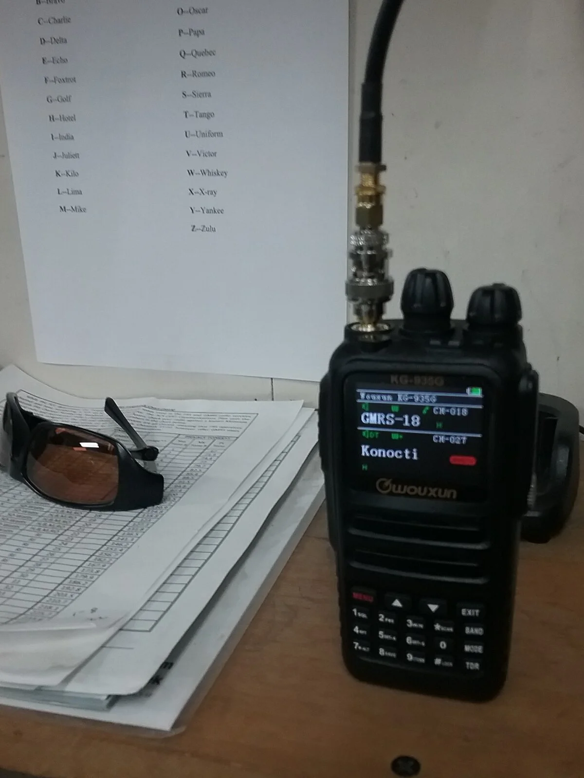

My sickness has progressed. Can't stop buying radios! I need professional help.
WTH is going on? How many radios do you need? 🤣
Check for some GMRS Anonymous programs around there.
I don't know. How many Jeep parts do you need? This will make 4 GMRS radios and 2 FRS radios to date. Oh, and a dual band HT on back order for when I get my Ham ticket. I won't mention how many antennas and other related accessories I've procured.

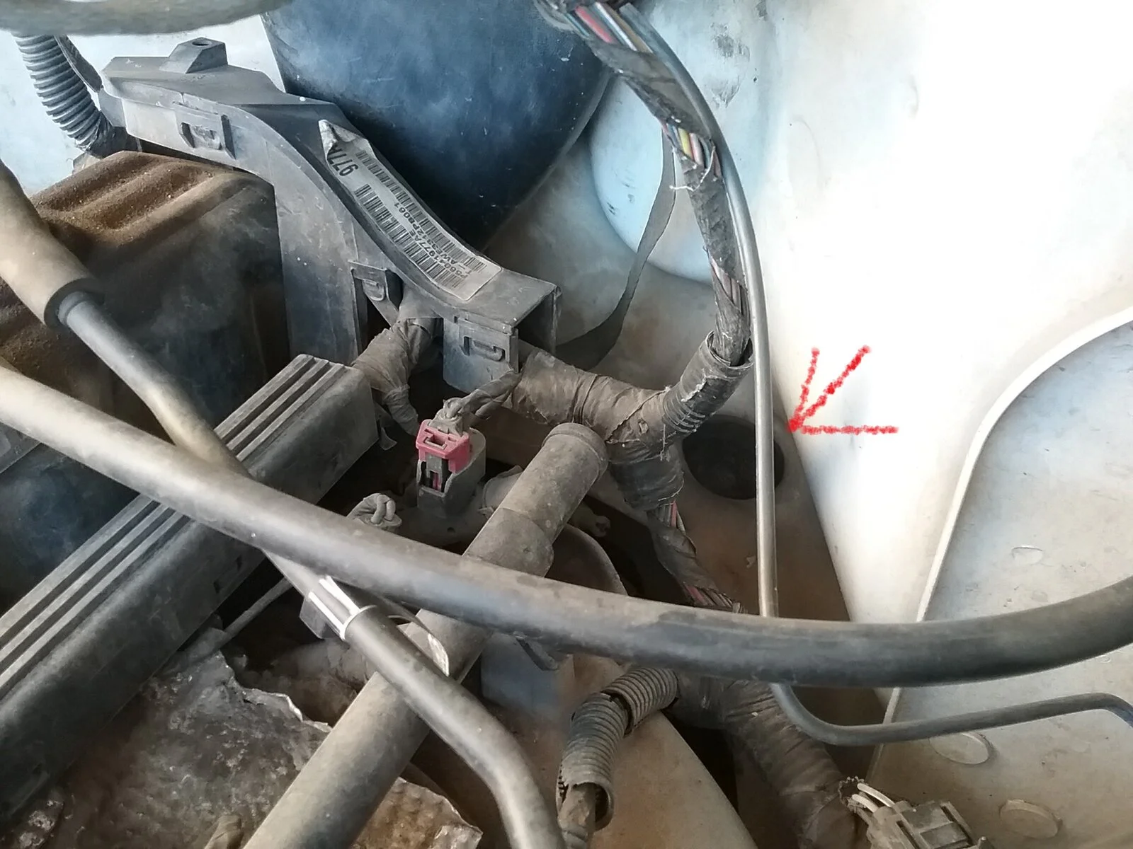

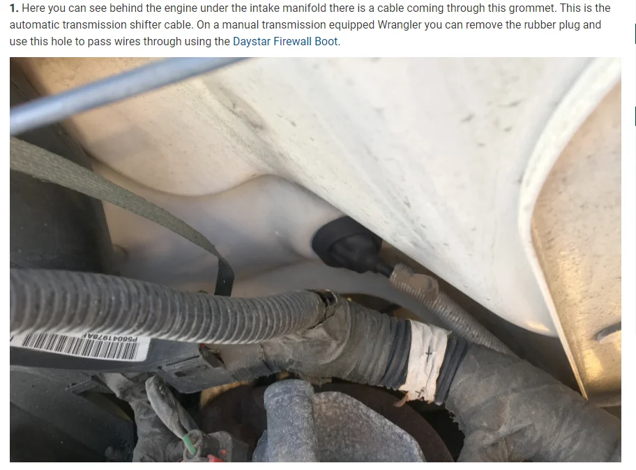

Question, there is a bulkhead plug on the firewall just to the right of the gas pedal, as you sit in the seat, about midway up the firewall. It's a fairly large plug, like 1.5"-2". Anyone know what that hole was used for that needed to be plugged by the factory?
Thanks @Alex01! I need to relocate my radio coax. I currently have it routed thru my main harness grommet, but it is too close to my 12 volt power wire to my stereo, so I'm getting some RF feedback in my stereo when I TX on the radio. Thought that would be a good place to route it. Just drill a hole in the plug and run the coax thru.
