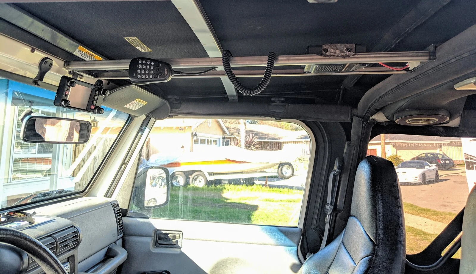

Welded up a quick mount for it. Controller is above the rear view mirror and the main unit is next to my head. Works very well since the speaker is right next to me. No need for external speaker.

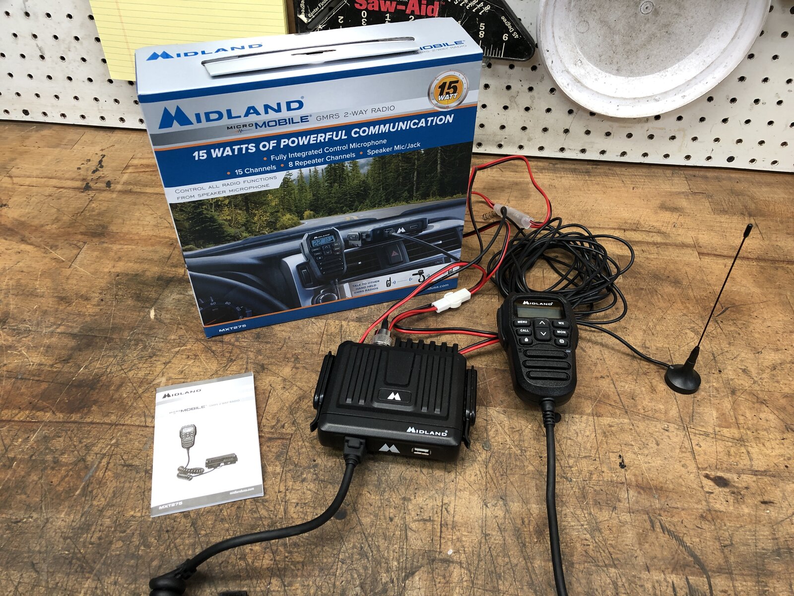

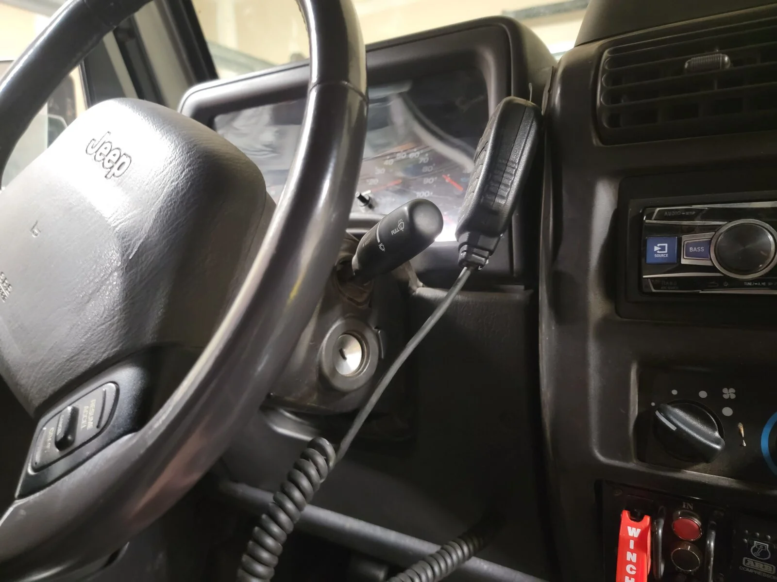

I run the Midland MXT275 GMRS, and have had good luck with it. All the controls are in the handset, and you can mount the box just about anywhere.

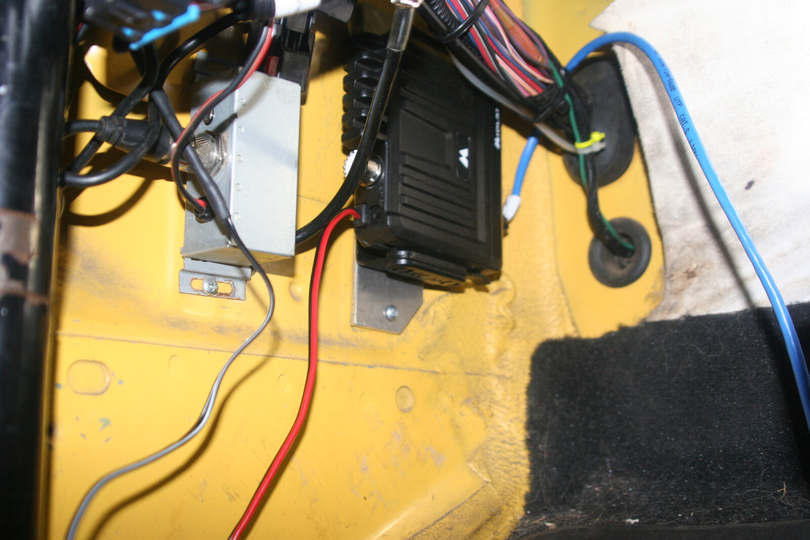

I mounted the box up under the dash in the driver's side footwell. I also have a similar type CB, the Cobra 75, mounted up there as well.

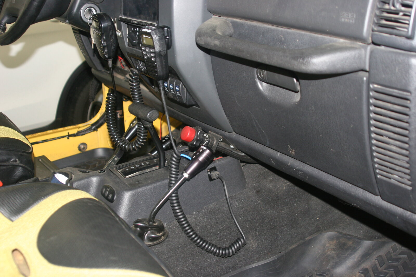

The mic hangs on the dash, and has a remote plug (RJ45, iirc) which is easy to disconnect when necessary.

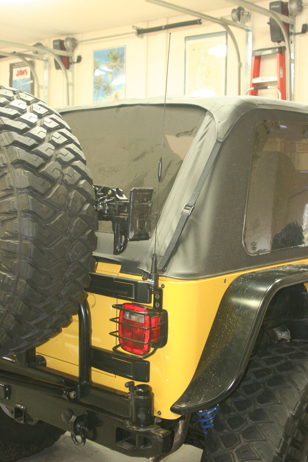

I ditched the small antenna which comes with the unit, and installed a Laird antenna. A good antenna makes all the difference.
I also run a remote speaker, which I mounted above the rearview mirror, which makes a big difference in sound.

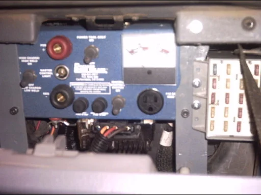

Let's talk more about that fancy throttle cable you gots there. We use those on our Durapatcher machines at work. They are not cheap!

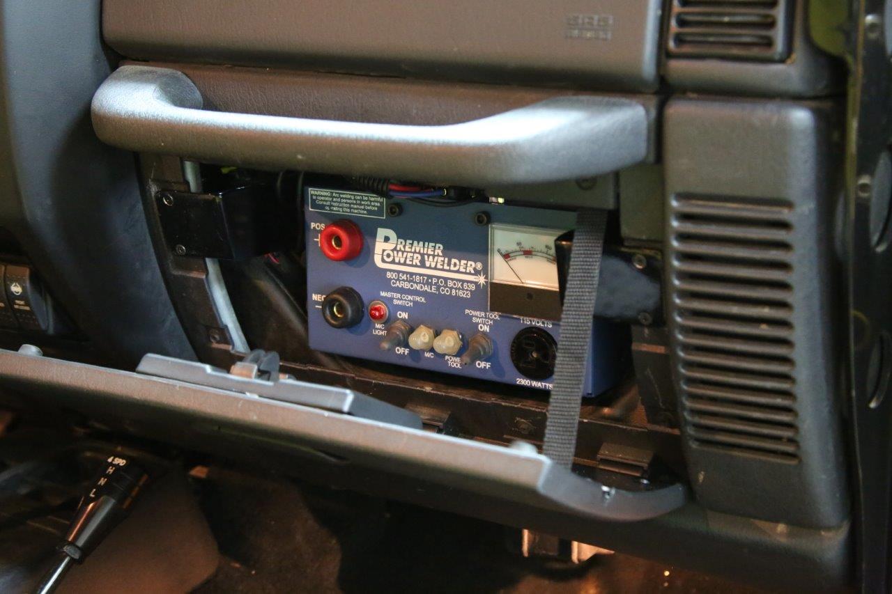

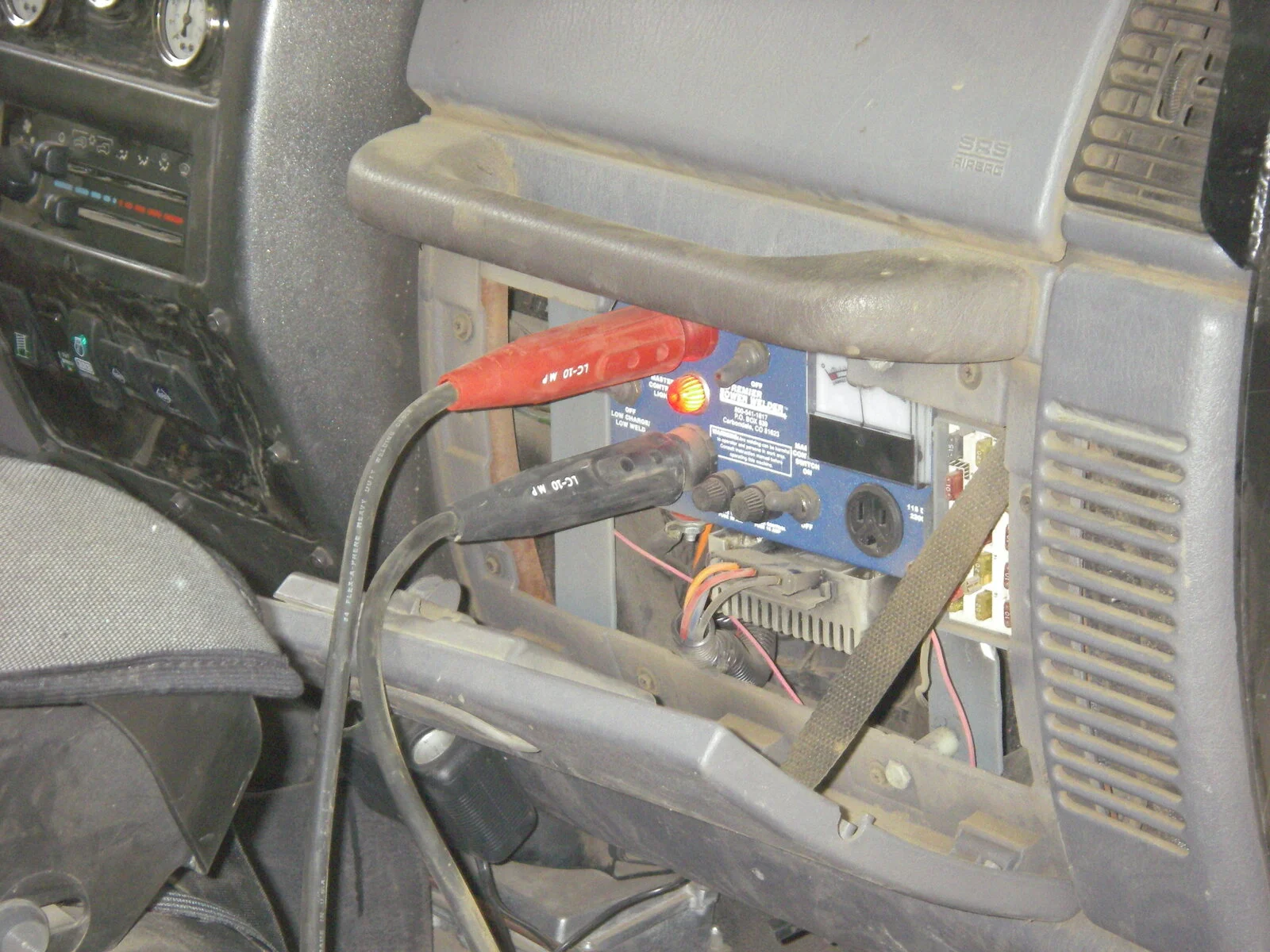

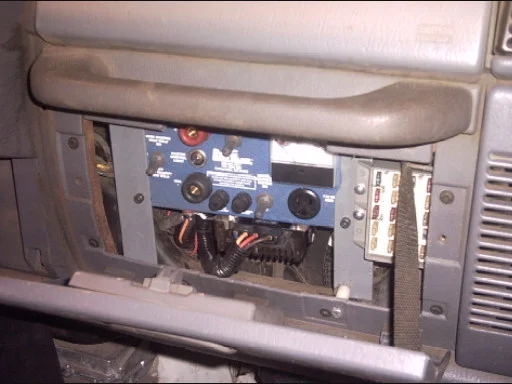

He has that for his onboard Premier Power welder that is in his glove box location. I've got the same cable waiting to get installed in mine. It comes with the welder kit.
