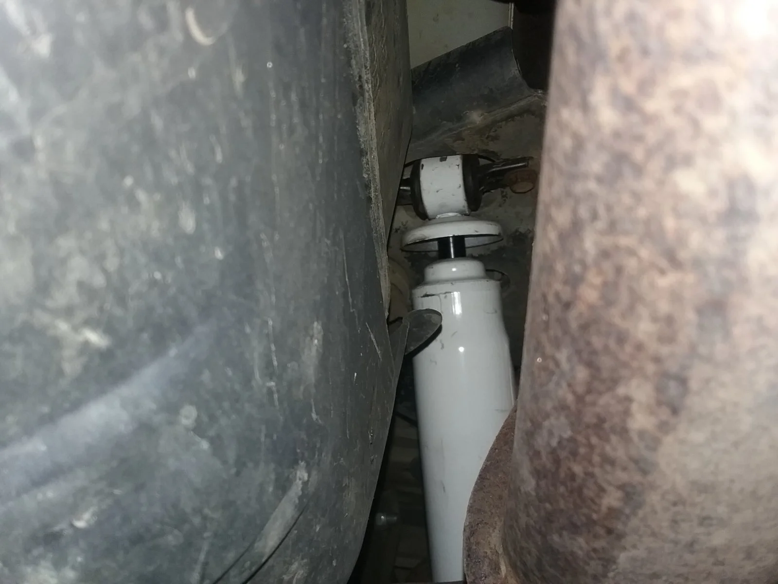

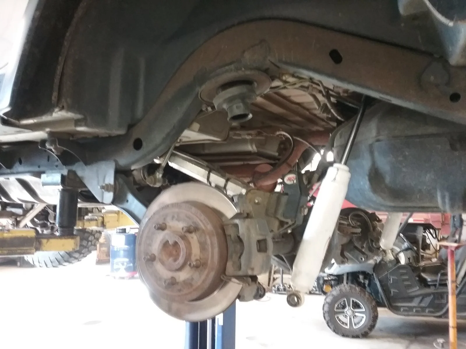

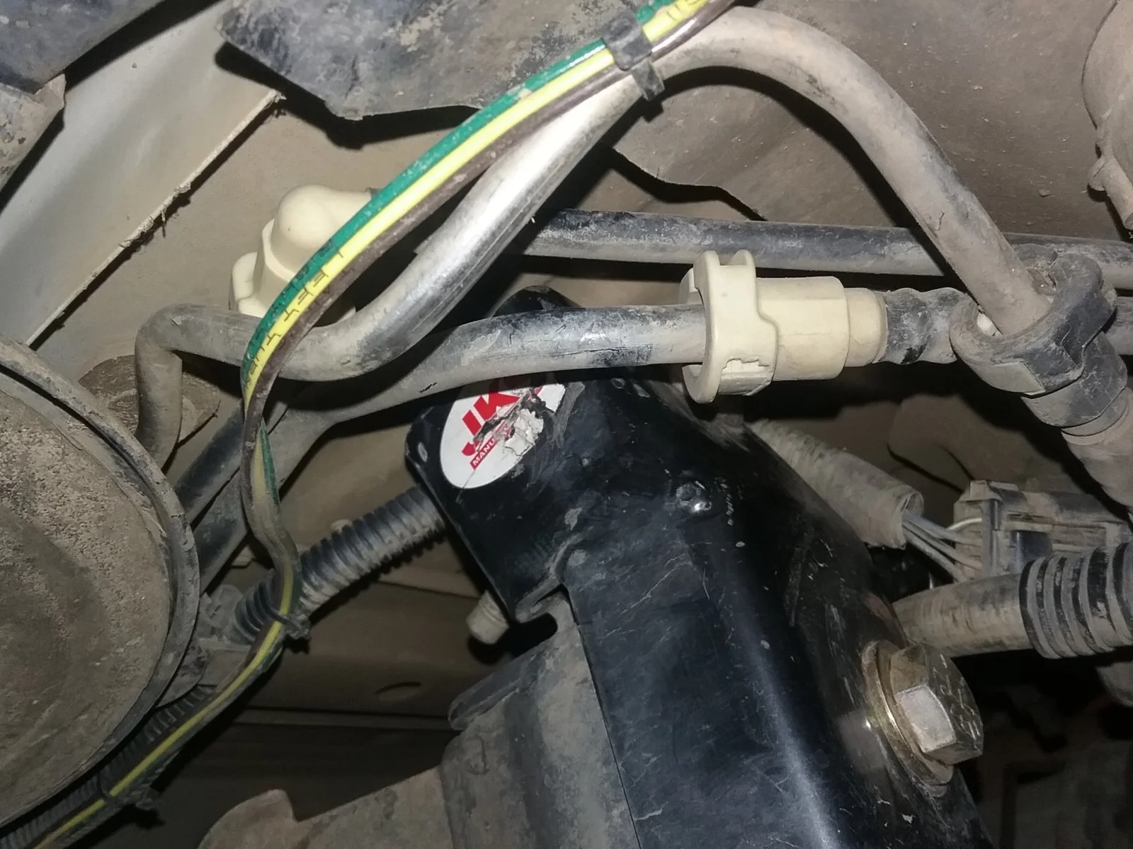

Today's project was to fix my screw up with the rear lower shock mounts. Pulled the rear springs/shocks, let er droop and measured for where to clearance the spring perch. Sparks flew.
Full bump
View attachment 29515 Got about 0.5" of shock travel left at full bump, so good there.

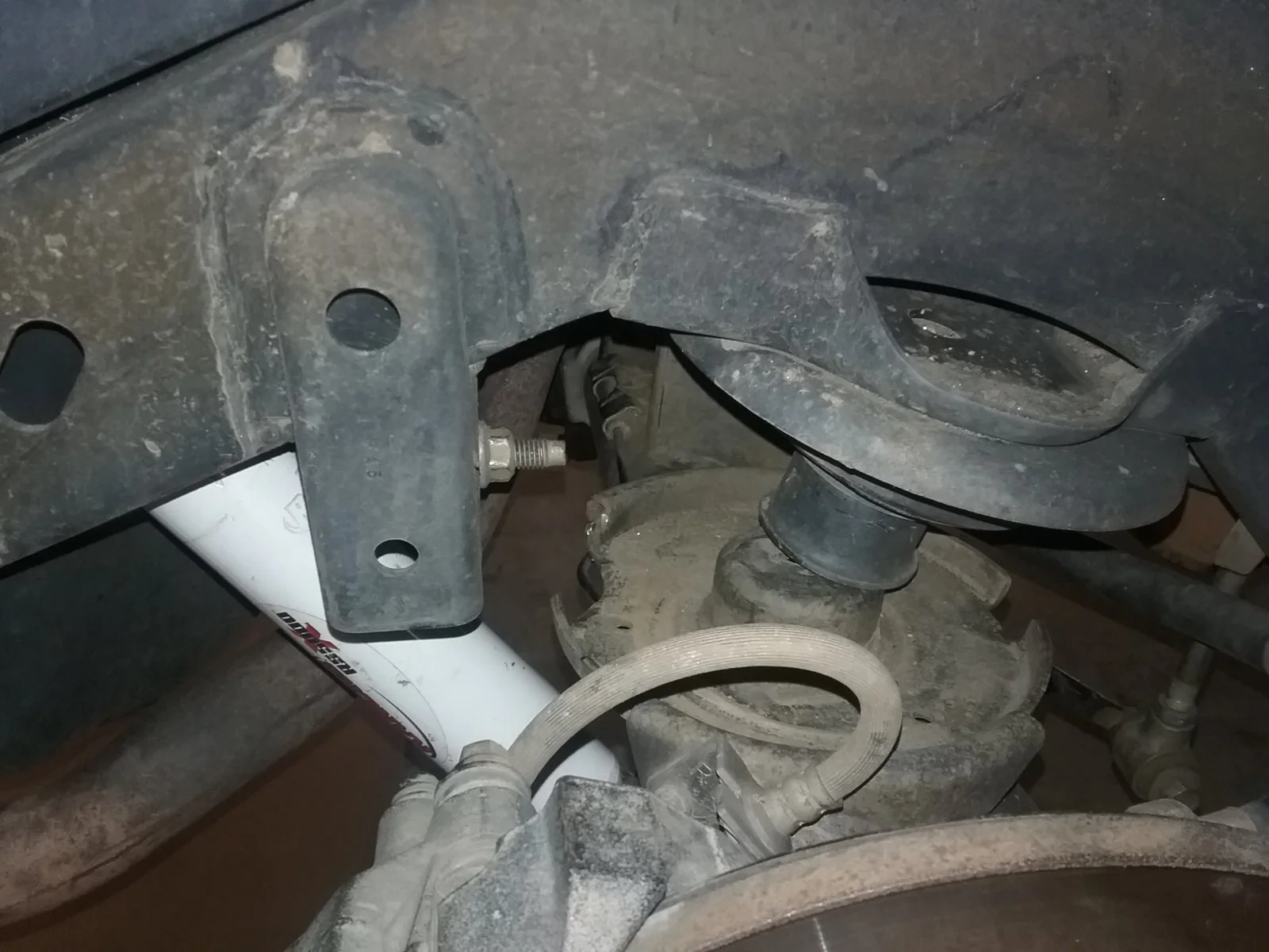

This was my limiter at bull bump. Damn rear track bar relocation bracket hitting the tub.

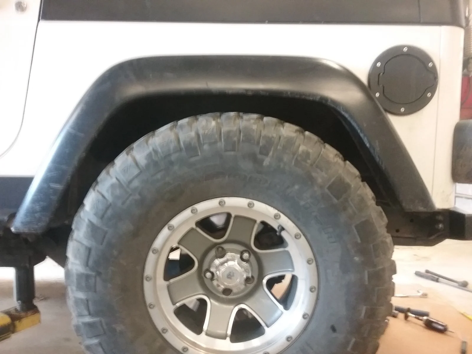

Both sides dropped to full bump. Tire clearance good.

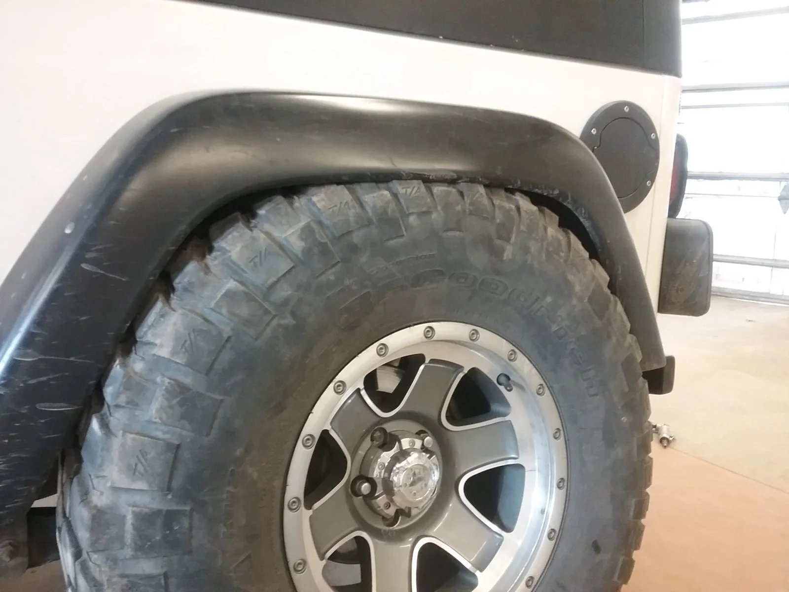

Full flex, a bit of rub on the outer edge of the flare.
All in all, not terrible, but some adjustments will be needed. I added another 3/8" of bump stop extension to the upper cup. I need to add another 3/8" to the bottom for a total of 2" of rear bump stop extension.

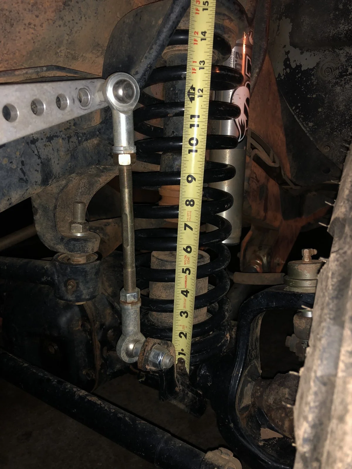

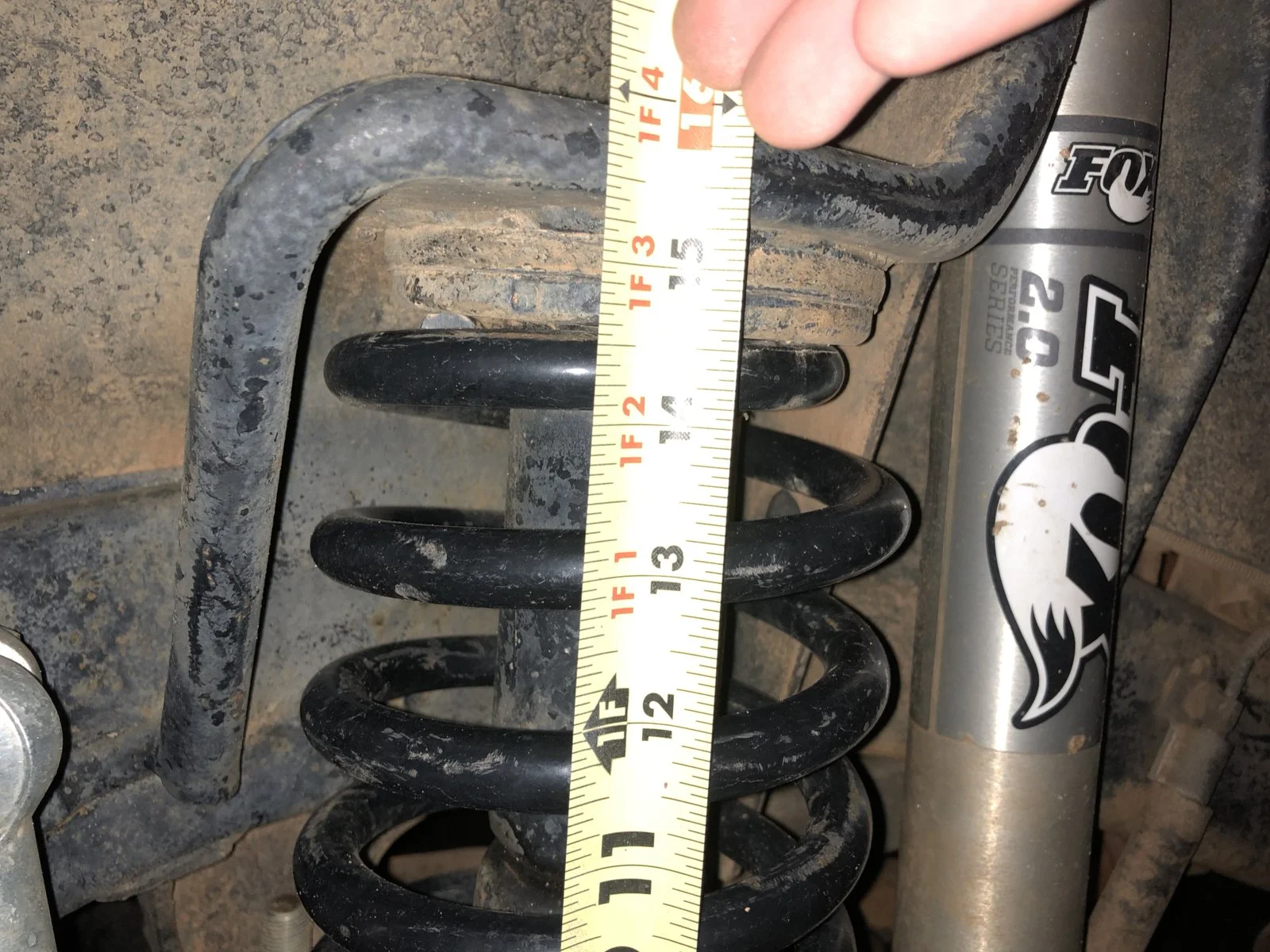

Epic fail Jimbo! Measure the front springs as it sits level at ride height when you get the chance. Thanks.
Looks to be right at 14.5” if my measurements are correct:
Reactions: bobthetj03
Thanks Jimbo. I'll measure mine again tomorrow. If we go by the precept that stock front coil height is 12", this means you're netting 2.5" of lift.
This tells me that my 2" lift springs have sagged 0.5" over the years, and that your new springs only net you 2.5" of lift. You may have lost 0.5" due to the weight of your winch?
