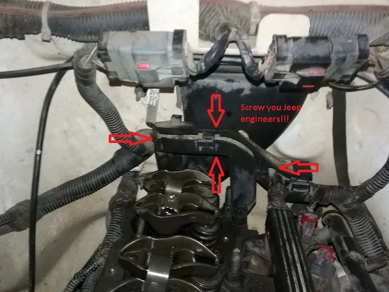

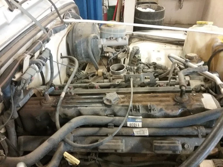

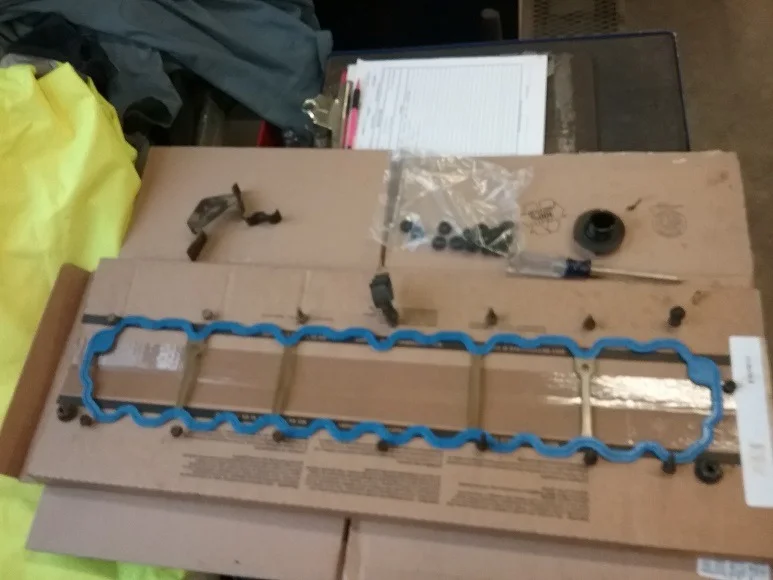

Well, I had delusions of grandeur yesterday. On the list of to do's was valve cover gasket, spark plugs, oil change, and tire rotation. The valve cover gasket part took me way longer than it should have. Kept fighting the wiring harness at the firewall, then lost one of the torque limiter washers, so what should have taken a couple hours tops, took me 4 hrs. Word of advice to those that want to replace this gasket. Try to remove all the grommets and torque limiter washesr before pulling the cover off so they don't end up in the trans tunnel out of reach. I'm wondering if I would have unbolted the trany mount and raised the drivetrain up if it would have given me more room at the back. Those 2 bolts back there were challenging to get to. Didn't get to the spark plug replacement or tire rotation. I was sore, tired, and fed up, but got it replaced and the oil changed.
Memory ain't what it used to be, so this.
I wonder if the engine bay is about 6 inches longer, this would be no problem.
and it may have been a better looking TJ huh?
You keep drinking the kool aid brother. Lol!
