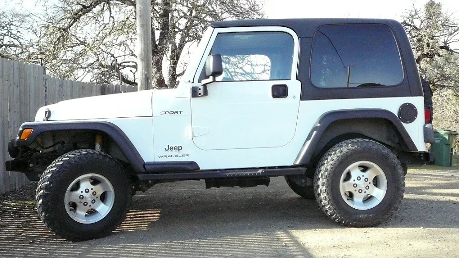

It all started a little over 10 years ago when shopping for my dream Jeep, not knowing what the heck I was looking for. My only criteria at that time was, 5sp manual, AC, and a hard top. Oh, and unmolested. Looking back, I wish I would have done some more research, but I think I got lucky for the most part. Couldn't quite pull off a Rubi, so I found a 2003 TJ Sport with 40K miles. It was bone stock, one owner with 30x950x15 all terrains, Dana 44 rear/lsd with disc brakes. And the bug hit me! Sadly, I didn't take any pics when I purchased it, so I'll start out with few of the first mods I added shortly after purchase.
View attachment 11394 As you can see in the photo, I added a OME 2.5" lift, 31x1050x15 BFG KM's(first gen),and a Bestop fuel cap cover.

I tried to find in this thread or maybe I read it in another thread that you are running a OME 2.5 lift with some kind of leveling coil spacer? Or is it that level only with the OME lift? If you are using coil spacer levelers what is the brand and size?
Yes, I bought the OME 2.5" lift 10 years ago. Got over 125K miles on it so far. Springs finally started to sag just a bit, so I bought 3/4" coil spacers when I transitioned to 33" tires.
https://www.amazon.com/gp/product/B001GH5OF2/?tag=wranglerorg-20
Just recently, I replaced my OME Nitrocharger shocks with Rancho RS5000X shocks. Pretty happy with them so far.
Reactions: JamesAndTheSahara
Did you only put them in the front or all of the way around?
Front and rear. My goal was to get 2-3/4" of lift, but then realized afterward that the springs had sagged 1/4", which put me back to 2.5" of lift.
Nice, Your jeep looks pretty level without any extra in the front. I am not a huge fan of the rake on a 4x4. I have a Ram 1500 looks like a 2 wheel drive. You would think it was if it weren't for the giant sticker on the side that says 4x4,
Yeah, I'm not a fan of a rear rake either. It sits pretty level as is now.
