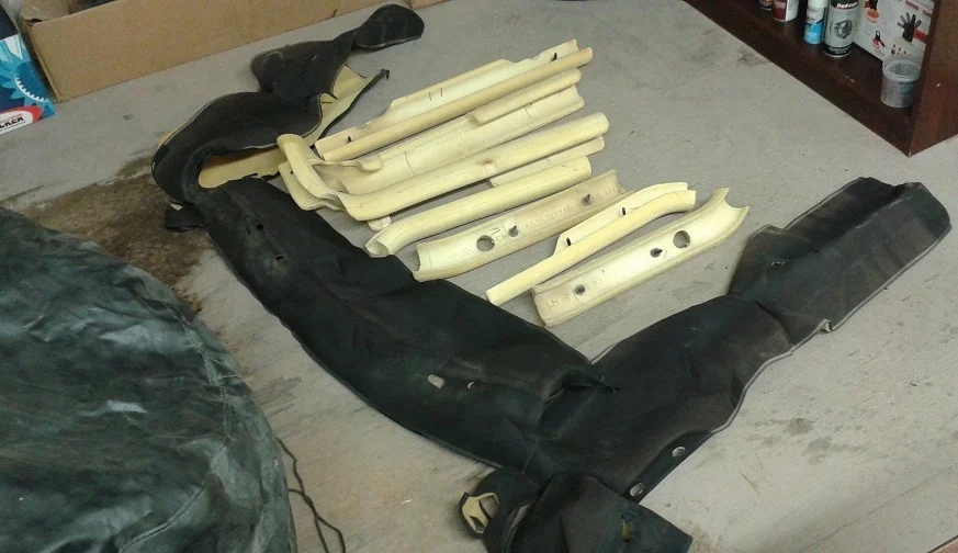

The coverings were starting to fade a little bit, so I took them off and liked the look. If anyone needs some 03+ padding, I have them.

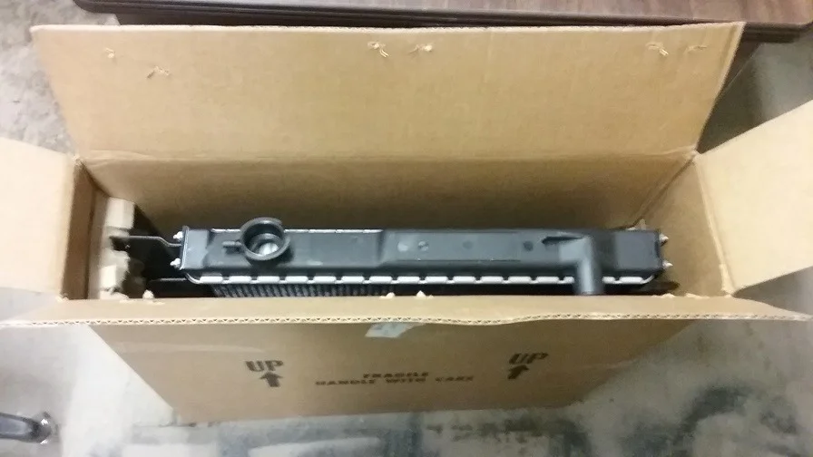

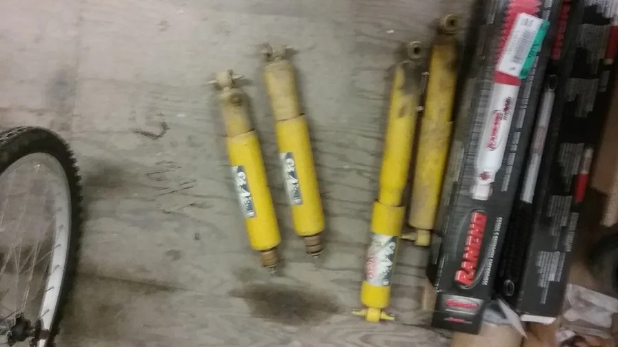

Small update, replaced my leaking O'Reilly's radiator with a new Mopar unit and a new Mopar cap. Fit and finish is noticeably better. Word of caution though, make sure you run the self tapping bolts that bolt the fan shroud to the radiator through to open up the hole a little before you install the radiator. Room is tight once it's installed and they can be hard to get started. Also installed my Rancho front shocks. OME's were just plum wore out. I got my monies worth out of them.
