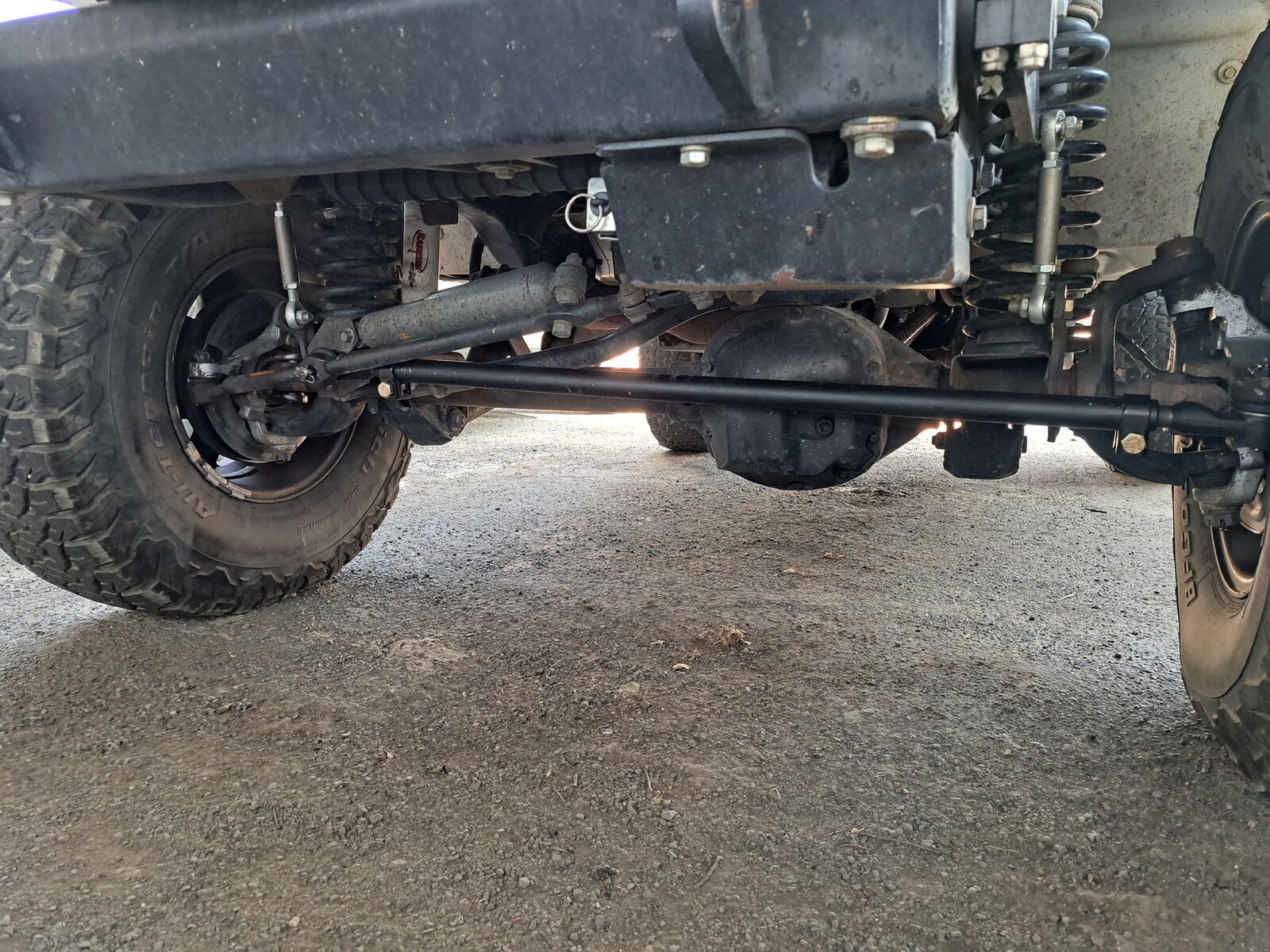

Ended up being the air line that goes into the firewall was cracked. 1/8 vacuum tubing to the rescue. While I was at it, I finally installed this beast!
Is there a preferred configuration for the clamps?
I prefer that configuration of the clamps on the passenger side because it avoids having contact with the steering damper under articulation. I'm not sure the driver's side matters, so I prefer to get it up as much out of the way as possible, flipped over.
