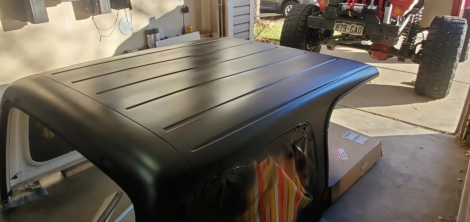

That looks awesome. I'm going to check out a Mopar hardtop in a few days. Glad to see there are options available if it needs painting.

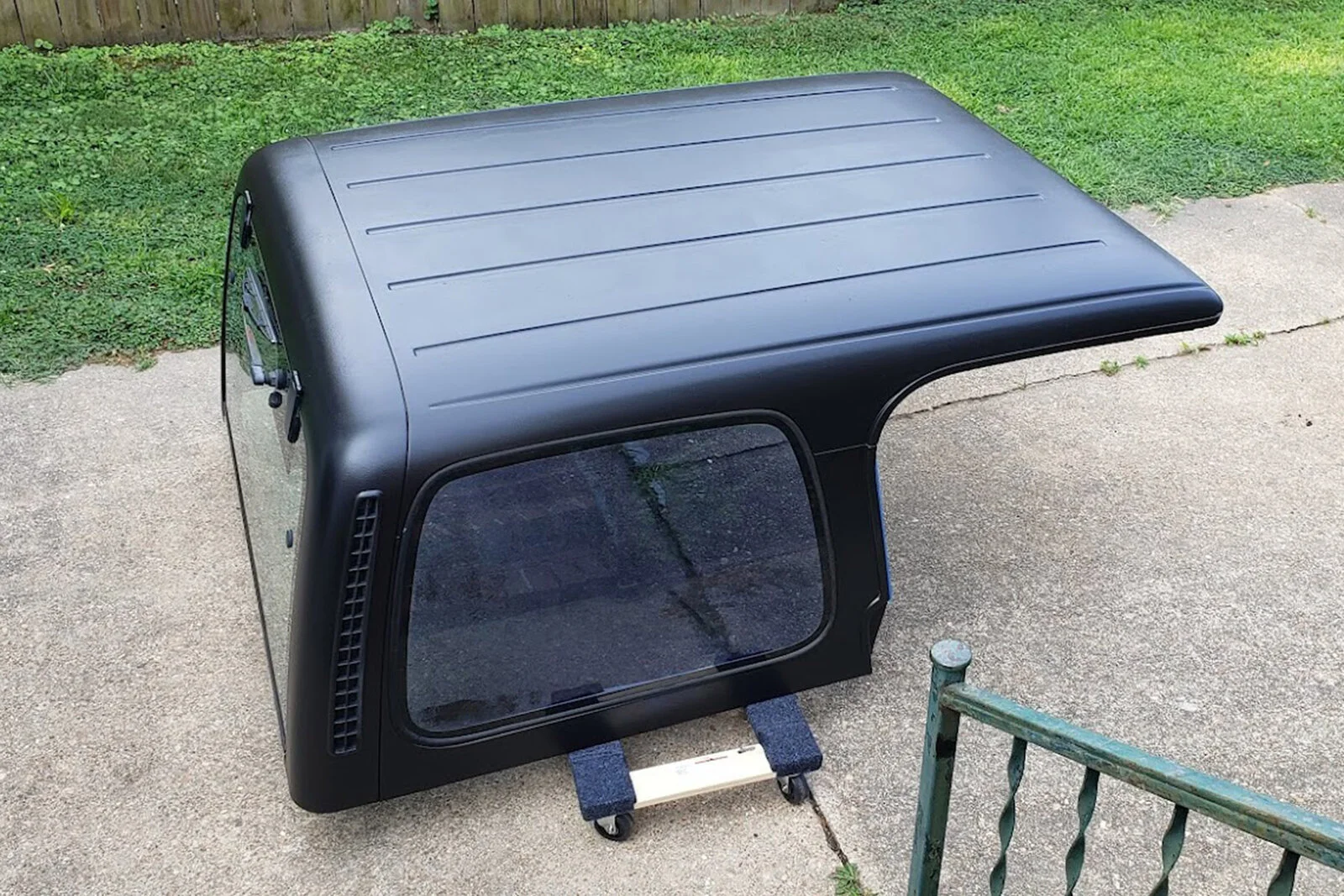

I painted my hardtop this summer. 1 quart of Sherwin Williams all surface enamel satin black. Used a roller and brush. Less than $40.00 and a couple beers.
Reactions: Irun
Nothing special, just took my time, used a cheap medium nap roller and brush for the tight areas and a couple coats of the Sherwin Williams paint. Let it dry real good in the garage before handling. It was very hot and humid when I did it. It's a good 20 footer paint job!

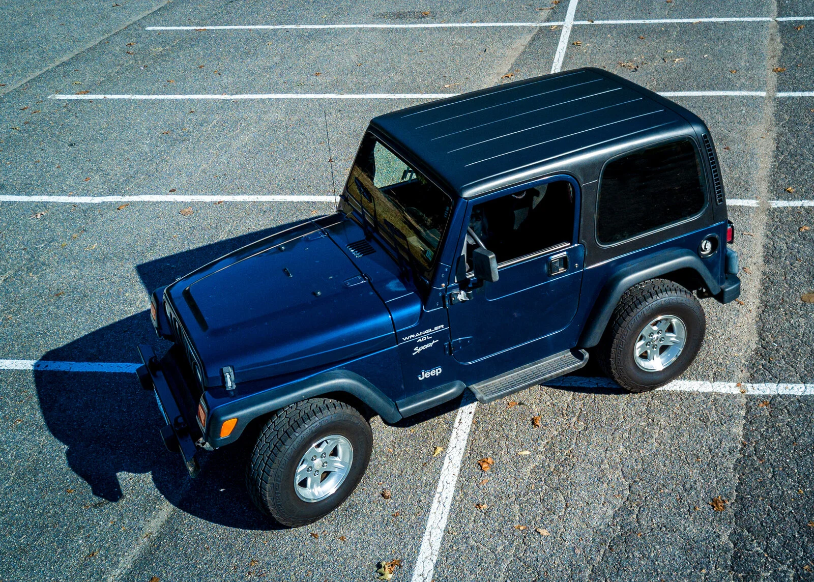

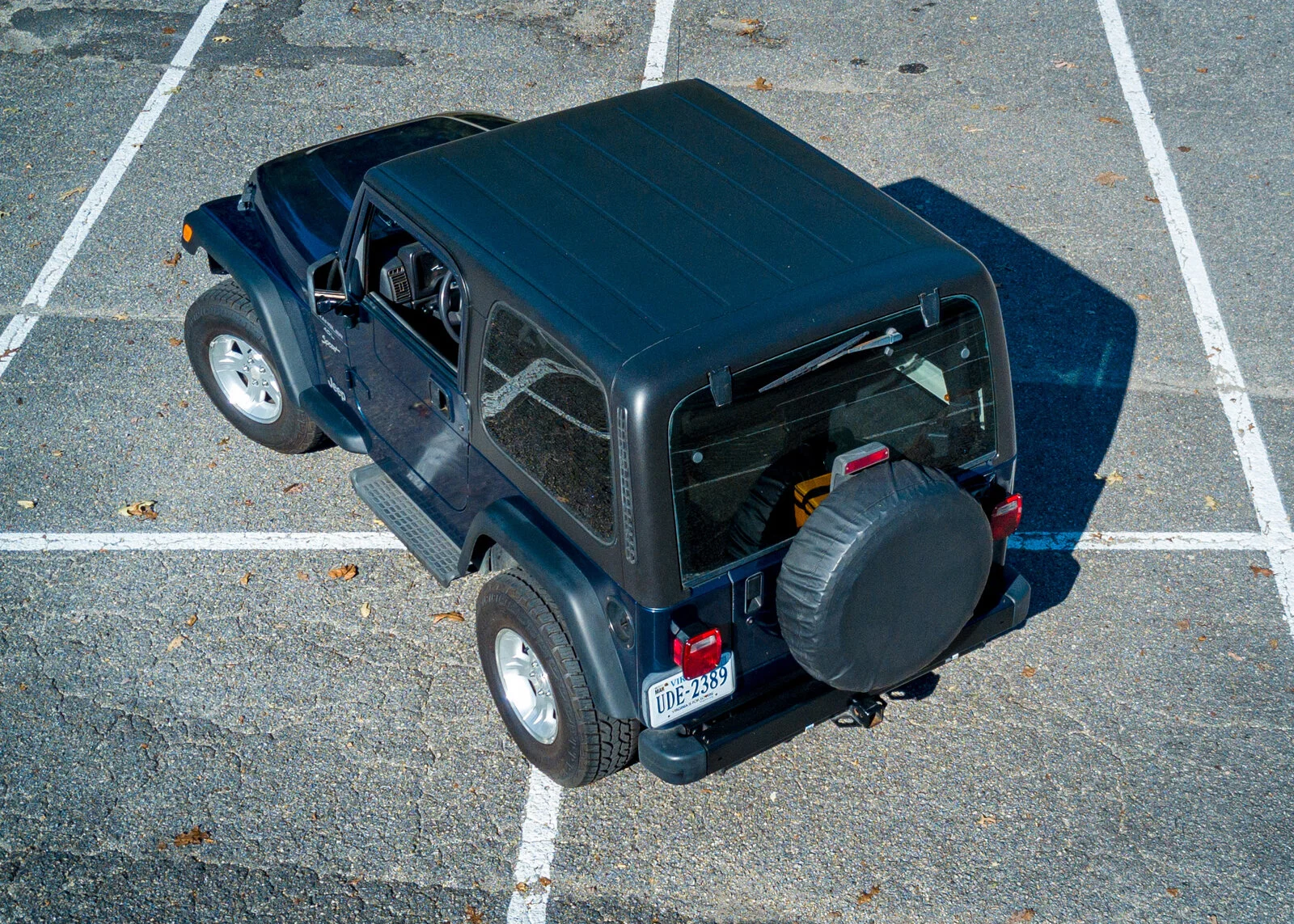

I did my black hardtop with SEM trim black I didn’t do anything but wash the top first and then paint it. I’d say 2 cans should work fine. Mine is looking good 5 years later and it’s not garaged and my daily driver in the northeast.
I needed to do something quick and easy to make a 22 year old top look better. Followed the above method. Scotch pads with mild soap. Rinsed and dried with leaf blower. Did 3 coats of the SEM trim spray paint (I used about 3.5 cans but my top needed a lot of coverage). It’s definitely not perfect, but a huge improvement. Thanks for the advise everyone!

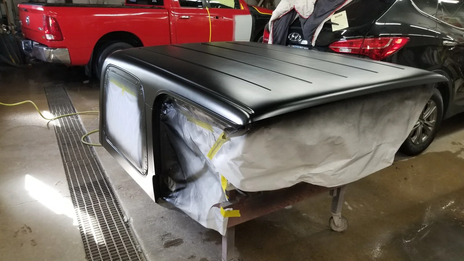

I had my hardtop painted earlier this spring. Found a local shop that did the whole thing for $350 cash. He used Hot Rod black which is a satin finish. Picture below is when they finished painting, it's not as shiny now and looks 100% like the OEM finish IMO.

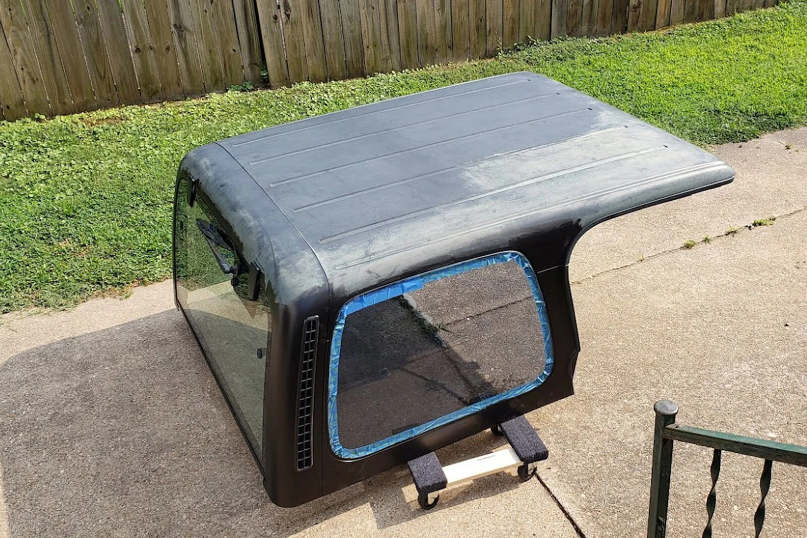

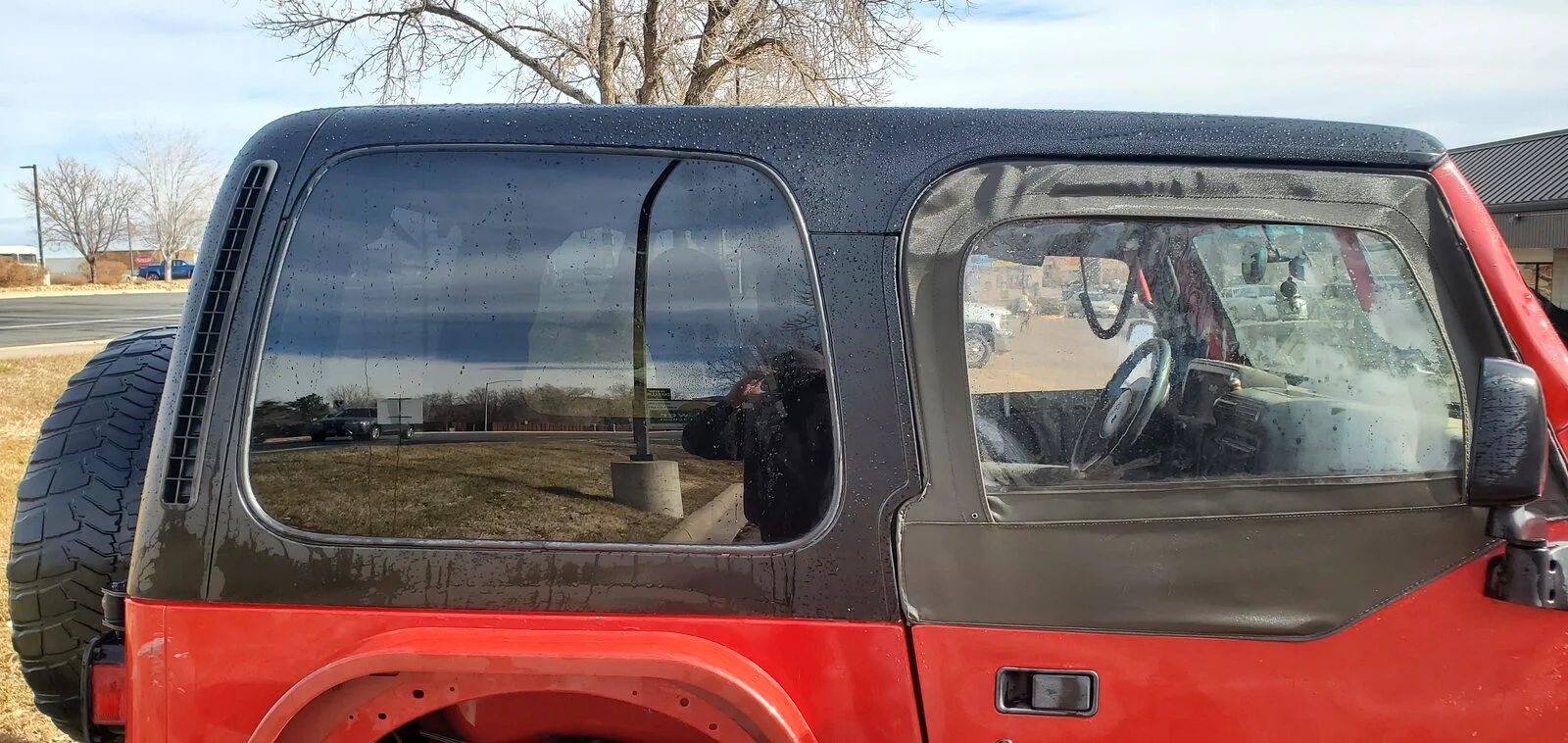

My TJ Rubicon came with a grey hardtop, I painted it black myself.
It took me about 4 hours worth of prep work (sanding and stripping the rear window off and masking). Then it took me a days worth of applying multiple coats of SEM trim black spray paint (the only stuff I'd recommend as far as spray paint goes).
Years later and it looks good as new. You'd never know that it didn't come black from the factory, it looks THAT good!
