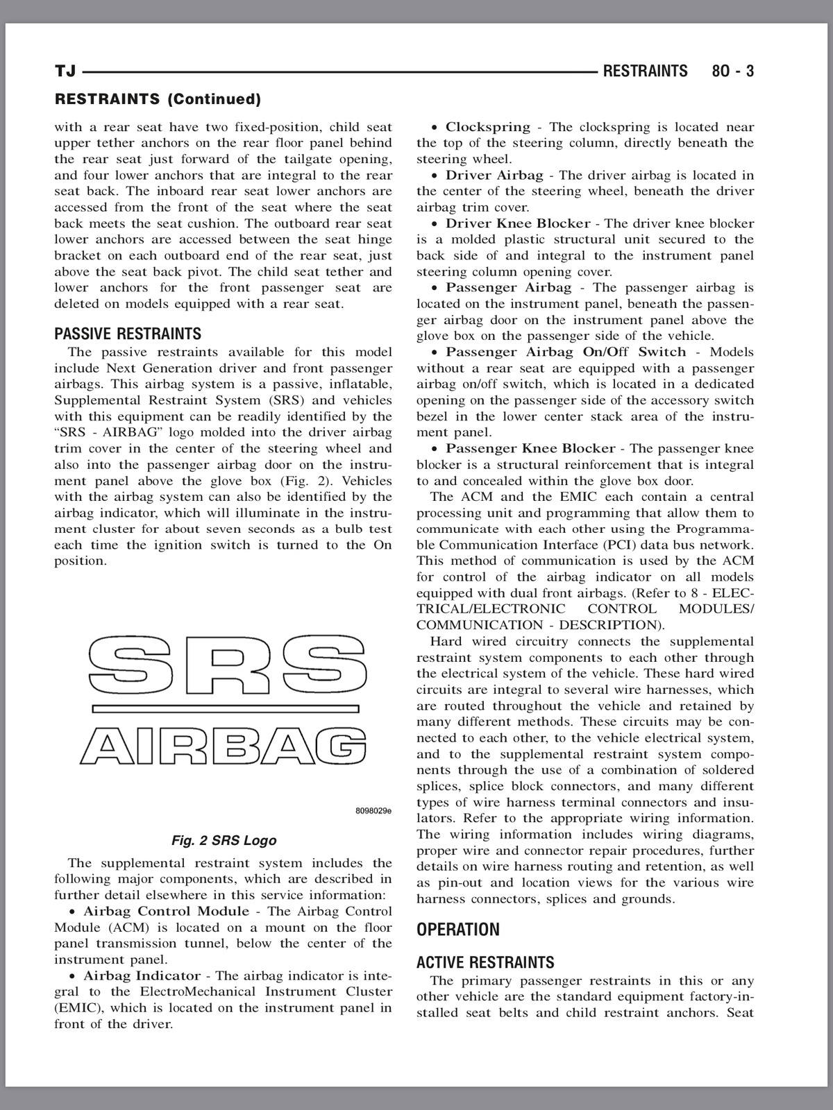

From what I’ve read the passenger side air bag switch was only installed if the customer didn’t order a rear seat. Check this paragraph out from the FSM.
• Passenger Airbag On/Off Switch - Models without a rear seat are equipped with a passenger airbag on/off switch, which is located in a dedicated opening on the passenger side of the accessory switch bezel in the lower center stack area of the instrument panel.

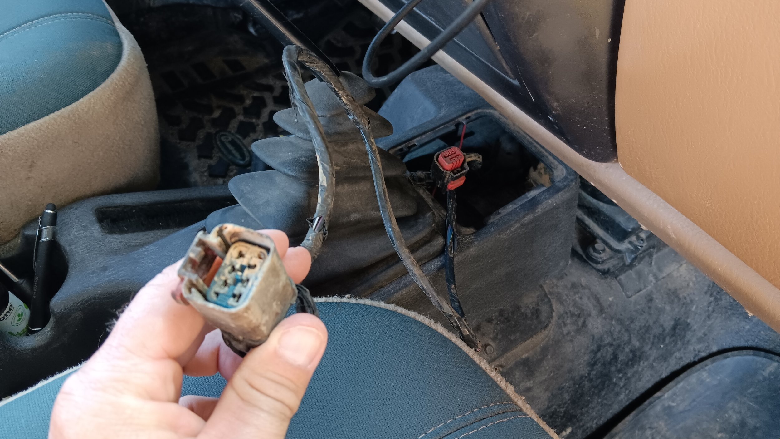

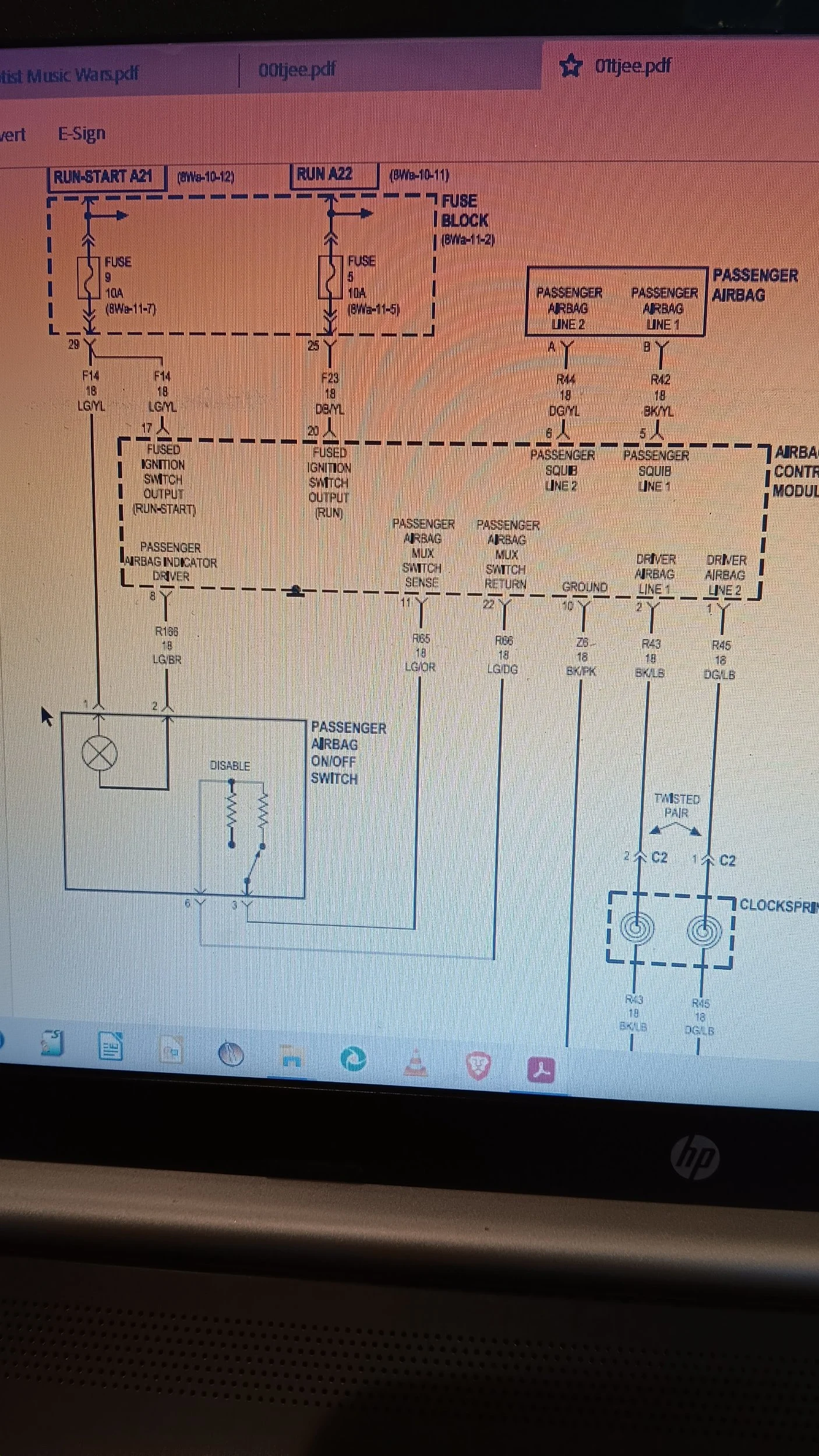

My son's 01 Sahara came without a switch and the airbag light is on (edit: it has all the wiring for the switch and an empty socket where the switch should be, but no switch itself. Sorry if there's confusion) . Which wires need spliced together to bypass the switch? Home electric I'm good with, but these diagrams are foreign to me.
Also, any idea what this 3rd wire is in the under-console location? Long enough to reach the storage/sub area. Factory console subwoofer wire?
In my head, it looks like yellow stripe gets tied with brown stripe and then orange stripe and dark green stripe get tied together. Am I looking at these right? Just tying together either side of the switches?
Any electrical gurus that might confirm. This 91 has connectors I'm not seeing a replacement for on ebay. Thanks

The Jeep came with no switch, just a blank hole where the keyed pass airbag switch should be. Clock spring is all good. Assuming there's no pass airbag if the light is on

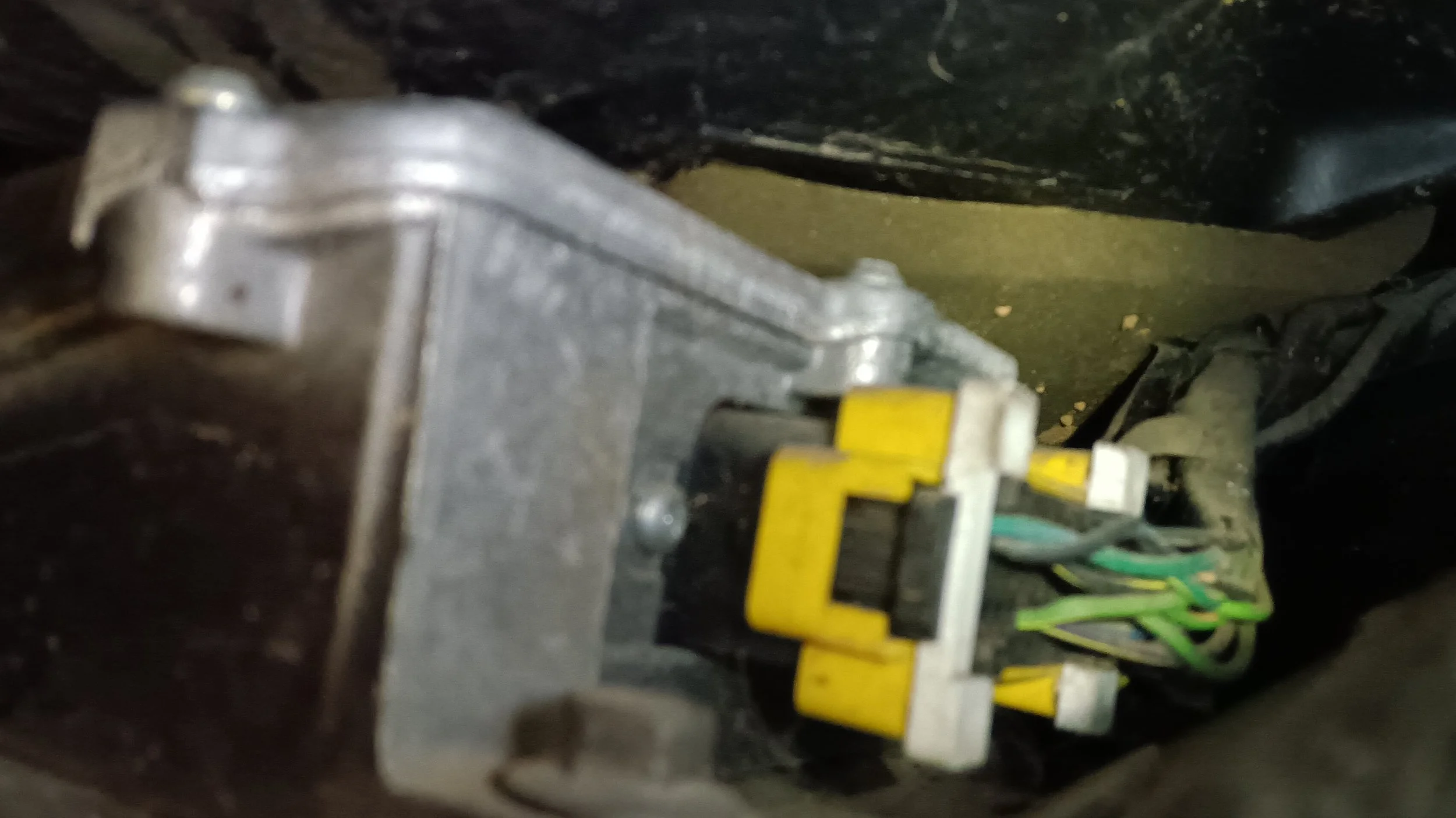

I was going to suggest installing a new switch, but everything I see online sells them for 97-00 only. Not sure if they stopped having it as an option at some point. Is anything plugged in to the airbag control module?
That's what i saw too.
I'll double check the control module when he gets home from work today.
Yes, both are plugged in properly to the control module

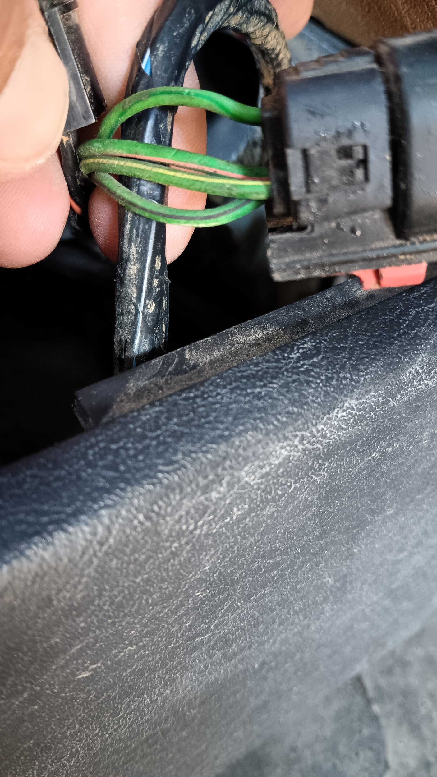

So, we finally found out Dbag PO had cut the wires going to the passenger airbag just before the connector to it, so we soldered on some leads, butt crimped back to the factory wires, put in the resistors and POOF!!! WORKED PERFECTLY!!
