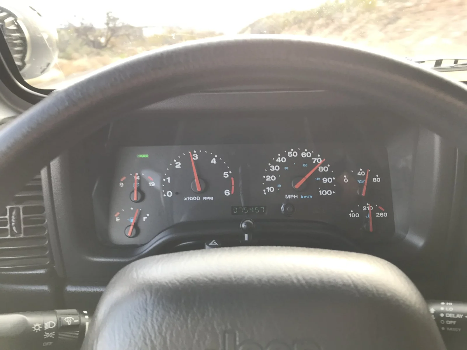

Did you know that with proper gearing a Jeep with big tires can go 60mph in 4L?

Pretty neat, right?4.0, 5 speed manual, 4.56s & 32" tires. 70 mph & I'm seeing 2600 or 2700 rpms, can easily pass another car & stays in 5th gear fine.
Yea, built by a previous owner, they definitely did that part right. I think there is still plenty of torque to go to 33s & not lose much power.Pretty neat, right?
