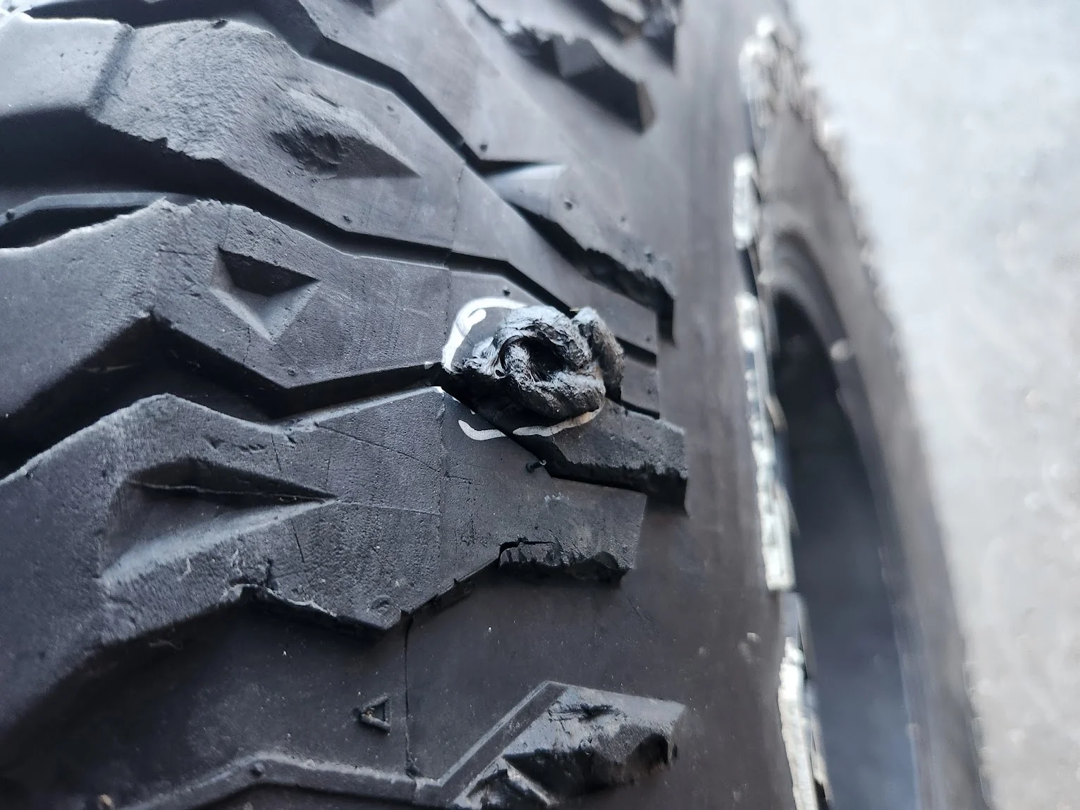

Got a short gash where the tread wraps around the sidewall.
My initial thoughts were "don't plug sidewalls," so I was going to try gluetread, which I carry but never use. But I don't see that working with the tread blocks unless I ground the tread off smooth. So I plugged it.
I've only plugged nail and screw holes before, where it's hard to get the reamer in at all. This was easy and the cut was only about 2 reamer-widths long. With 2 plugs I couldn't hear any air. Crammed in a couple more for 4 plugs total, and trimmed the excess.
Guess I'll see how it holds up. Anything else I should try? I got new street tires so these are for trails now.
Reactions: JMT
For a field fix, it's perfect, but I wouldn't trust it to hold air permanently.
Plugs / patches on sidewalls for getting off the trail are more than fine. Plugs / patches on sidewalls for the streets / highway are a no no.
Sidewall repairs usually won't last. I had a sidewall patch repair done by a service station, then one day the tire exploded on the interstate and the tire came completely off. I was driving at 75mph on a bare rim. It was like something you'd see in a cartoon. Yours is a plug and it's still in the tread area so it might work, but personally I wouldn't have put a hole in your tire because of a chipped tread block.

Obi is spot on here. Unfortunately, I’d recommend biting the bullet and replacing that tire.

Perfect candidate for one of these.
