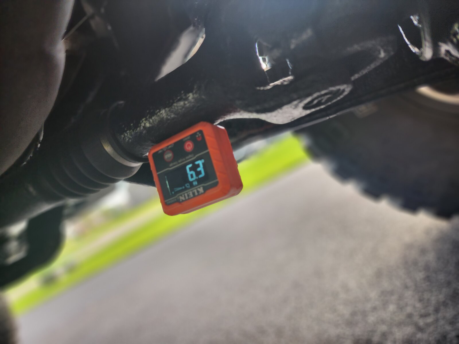

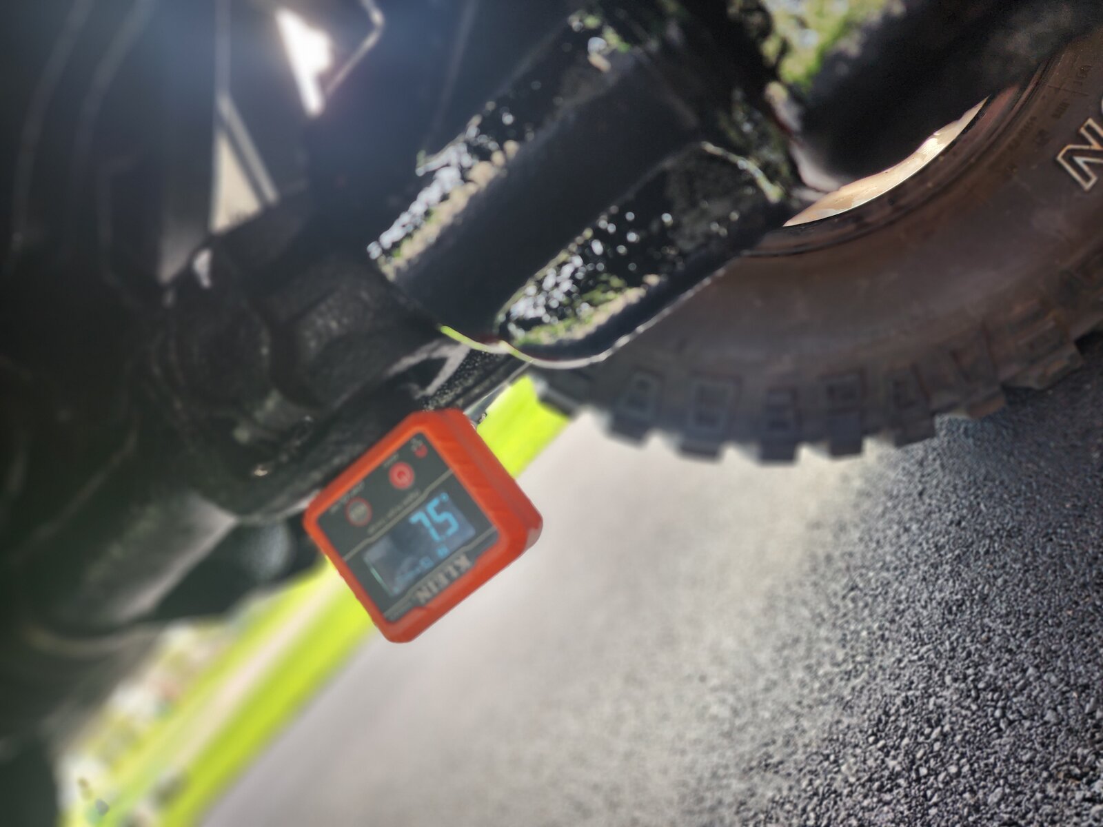

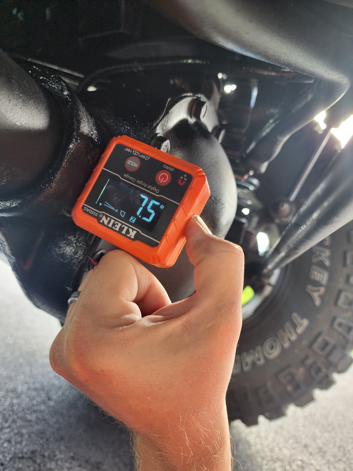

Wheels are at 28 psi cold per factory specs. Front axle angle is 7.3, driveshaft is 6.3, driver C is 7.1.
