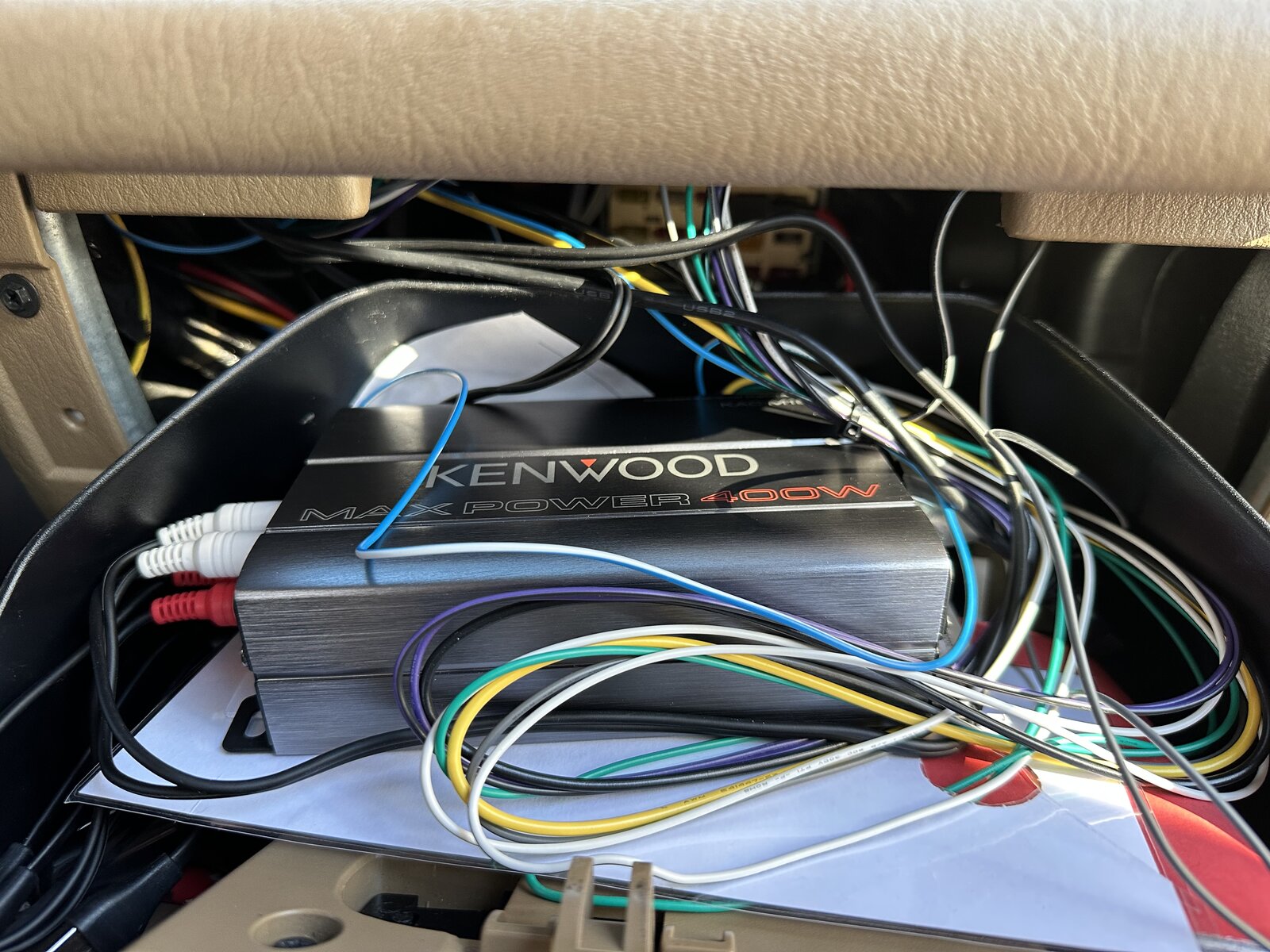

After the kicker speaker upgrade, it was obvious that a separate amplifier was needed. A regular recommendation on the forum is the Soundstream Picasso Nano 640D that I believe has recently been discontinued. I found a used unit with all the attachment cables on Ebay and ordered. 5 channels, small footprint and plenty of power.

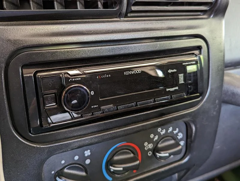

The next obstacle was my 10+ year old head unit. It had only 2 pairs of pre-amp RCA outs; one for the front speakers and another set that could be set to rear or the sub. There may be other solutions, but I opted to replace the unit with another forum recommendation: the Kenwood KMM-X705 with 3 pairs of pre-outs at 5v.
The Kenwood install was easier expected. Crutchfield supplied all of the required parts. I had it done in about an hour. No real change in sound quality running from the built in amp vs the old Pioneer.
The amp install was much more exciting. There are plenty of good examples on the forum (here and here are just two) for mounting the amp in the unused space under the steering column. The forum research and pre-planning made this install about as simple as it could be. I spread it out over a few evenings and had it ready to go for the weekend.

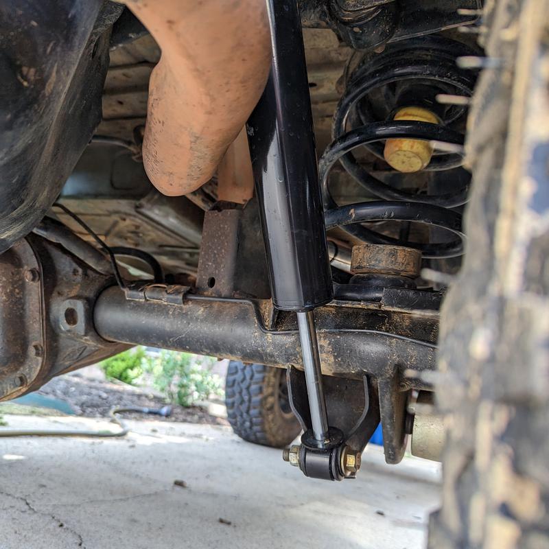

Somewhere along the way, I installed a set of Skyjacker Black MAX rear shocks (B8528) hoping to relieve stiff ride characteristics of the Rancho 5000x. They also run shaft down which allowed me to remove the Currie shock extension brackets. These have been a huge improvement in ride quality. I haven't noticed any ill effects from running different shocks front (still Rancho) and rear. At some point, I might get a set of Black MAX for the front, but for now, I'm happy with the improved ride.

Just saw your Ranchos post in the for sale section. How are you liking the Black Maxes so far? And how light is your rear end?
The BMs were a big improvement for me. I posted my thoughts over here. I run relatively light: rarely have passengers, soft top, factory bumper. I'm probably going to get a front set of BMs this summer.

  • It looks like one of my Black Max shocks is leaking. Not completely unexpected based on the experience of others here. I'll contact skyjacker and see what they say.

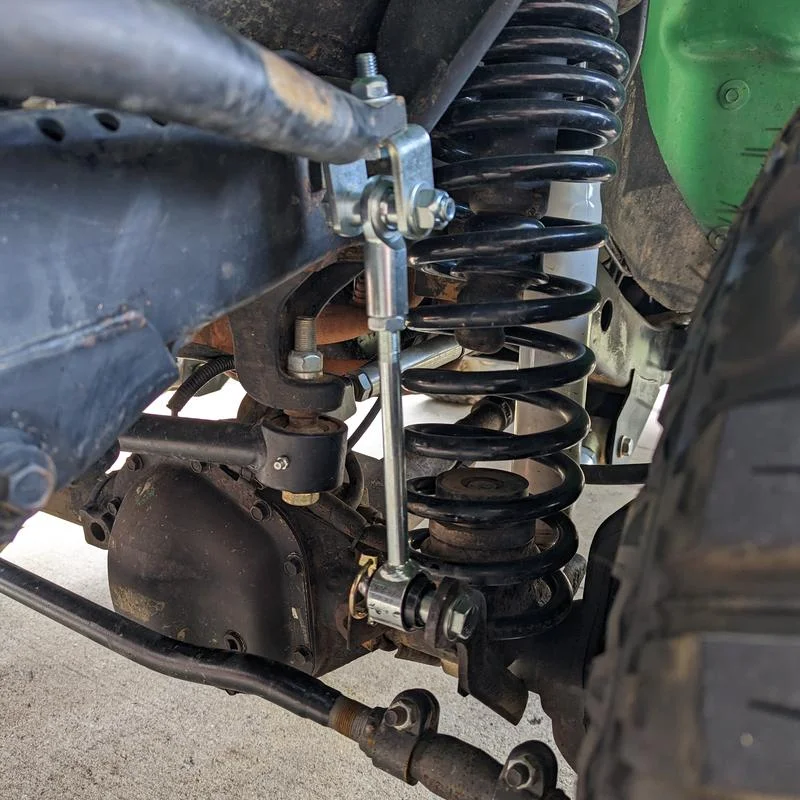

I made my own quick disconnect pins last year to use with the Zone Offroad sway extension links. The pins worked great, but because the links did not have a joint, getting them off the pins to disconnect was a massive pain. In my last trip out to Bridgeport, I lost a bushing sleeve for one of the links while disconnected. Instead of replacing the sleeve, I replaced the entire disconnect system with the complete kit from Zone. These links have a joint on the bar end to allow them to pivot making it easier to remove. I removed the DIY pins in favor of the set in the kit.
The leaky shock has been replaced. Summit made getting a replacement really easy. Warranty claim submitted on Friday and the new shock was at my door the next day. It helps that there's a local Summit hub.

The passenger rear speaker has started clipping, no other speakers having issues. Speaker is in good shape, fade/balance is not out of whack. i'll have to take a look at the amp side connections. Always something.

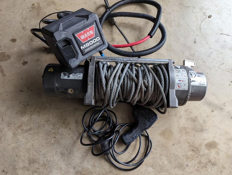

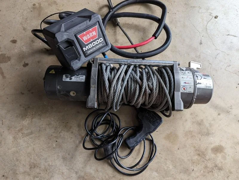

I've also made progress on the winch. The drum is painted and its been reassembled with fresh grease. I ordered the smittybilt raised winch plate as well. Only remaining pieces are all the things from WRG: ST fairlead, Safety Thimble, license plate mount and winch rope. Not in a hurry, I'll wait until I can order them all at once with a set of the new green color soft shackles

The rear passenger speaker wires had come loose at the amp. It wasn't clipping, it was popping when it would get signal. All tightened up.
