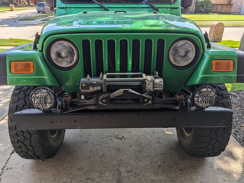

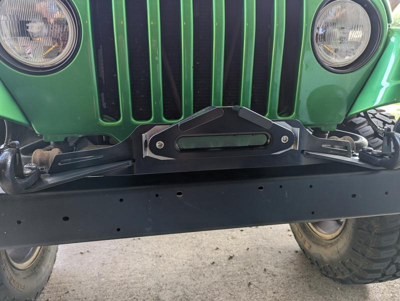

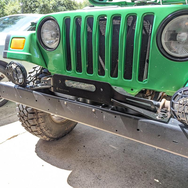

I did have a chance to test fit the winch plate this weekend. I've ordered new Curt tow hooks to fit between the angles on the plate and the fogs.

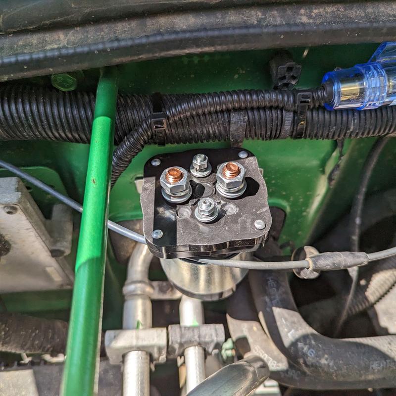

I also mounted the winch solenoid.

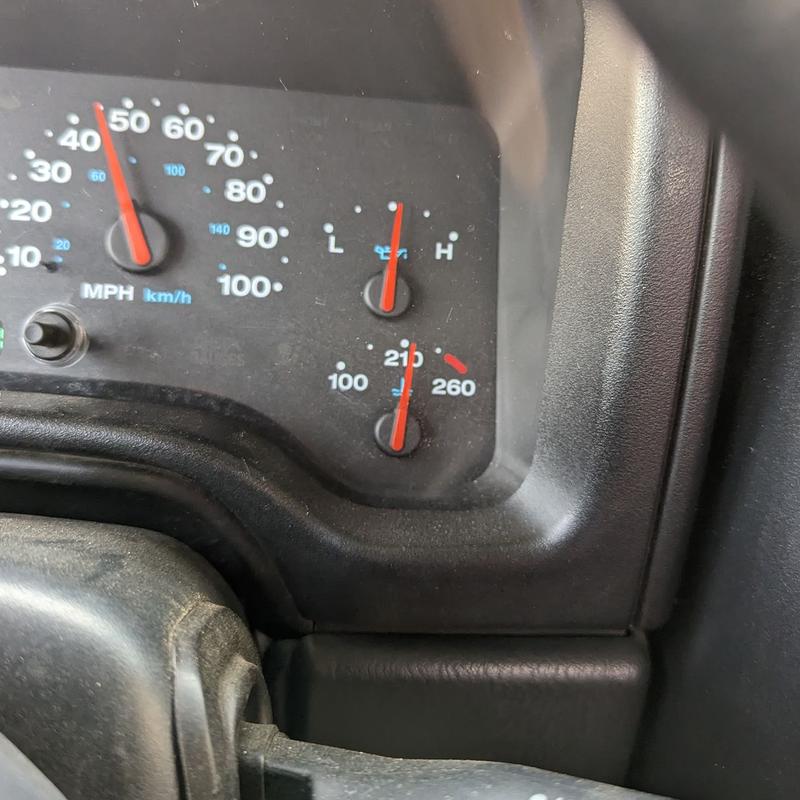

It's 104F today and the Jeep did not like it. Coolant temps got as high as 239F on the highway on the OBDII readout and dropped to 231F on the road in town. Looks like I have more work to do.

I didn't replace and of the cooling system when I did the flush. Think I should start with the fan clutch?
Sanity check it first…it should not pinwheel at temp (and off) my new one only moves a few inches. If you need a new one it’s ~$50 and an hour of work. L

It's worth taking a look at. I just happen to have my Bluetooth reader in the center console. I was surprised though, it was reading 235F when I took that picture, higher than it looks.
Fan does not pinwheel hot or cold. I did notice the coolant reservoir was empty. Filled it and idled it up to temp. It hovered at 215F at idle and would drop to 210-210F with throttle. I'll keep an eye on it.

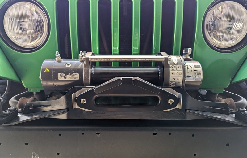

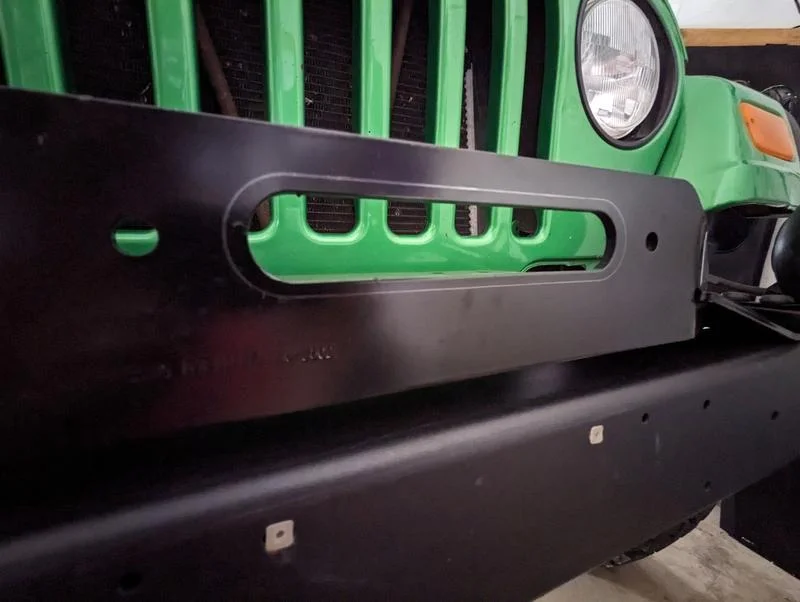

Got the winch plate trimmed and painted a few months ago. New WRG fairlead and license plate mount all installed.
Today, I finally mounted the winch. No electronics as of yet. I can’t decide if I want to relocate the control box to under the hood. I do like the clean look up front though.
I don't think it's often ticketed, but Texas is a two plate state... right?
Listen, the WRG mount is cool, okay? 🤣
Texas always been a 2 plate state. Early career was a LEO. But correct takes a certain officer to actually ticket it.
