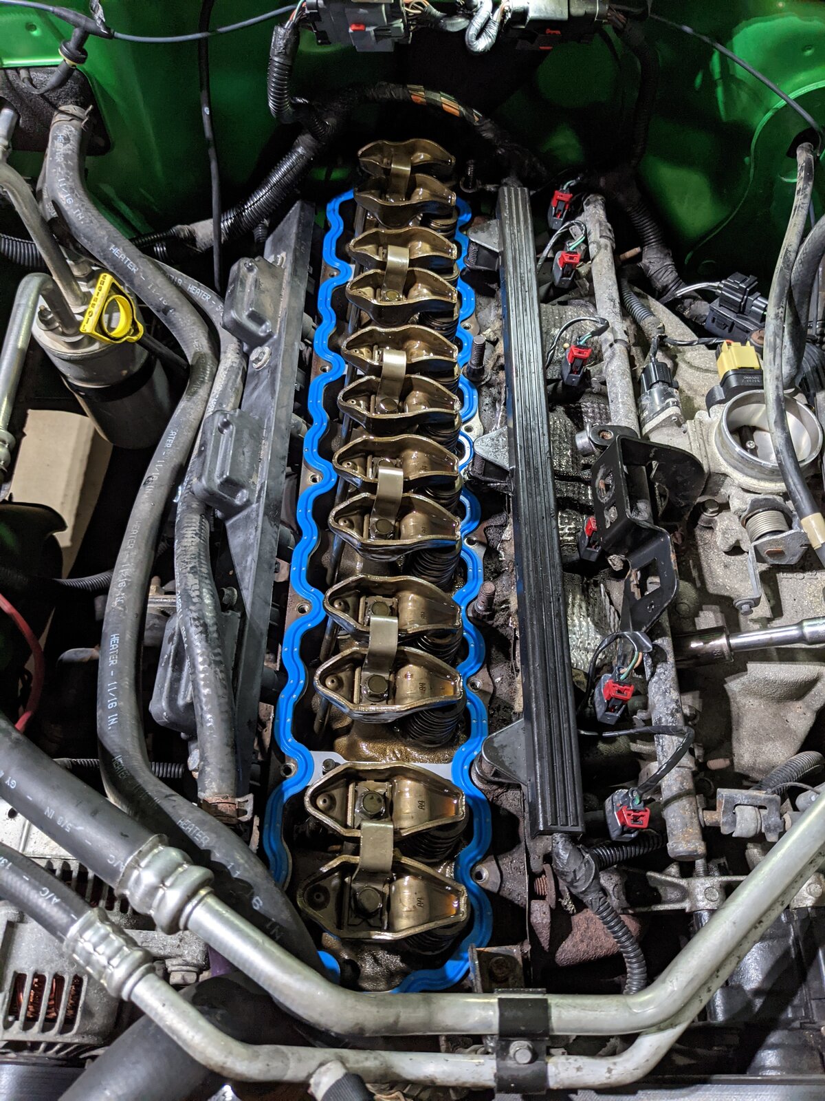

Valve cover gasket was fairly straightforward.
I did have a couple of issues not mentioned in the FSM.

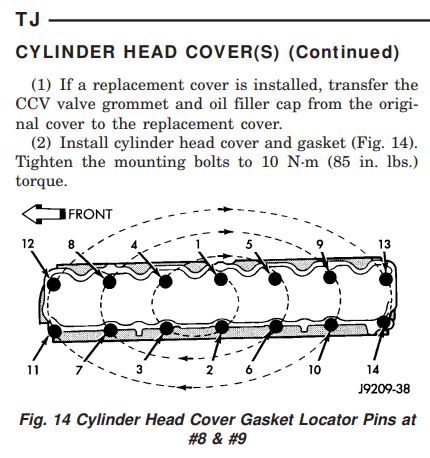

There were 15 bolts in my valve cover, the 04 FSM lists 14 - at least in the torque order image.
There were two 18mm nuts that prevented the cover from lifting off easily, one at the front of the cover holding down the AC lines bracket and one at the rear that secures a ground mount. I had to remove these in order to clear the cover.
The last and most frustrating part was removing the PCV elbows. I found a similar question here suggesting you just cut them up and remove them piece by piece. It took a while but this method worked.

I don't see the plastic bridge at the back of the cover, did you have to remove it? I put off doing the valve cover gasket on my previous TJ partly because of that.
Yep, I had to remove it. I watched a few videos on how to get it out but they weren't especially helpful. It wasn't hard but it takes time.
I took my time and separated all eight clips around the top cover with a short stubby flat head screw driver and lots of patience. Then remove the 11mm nut on the passenger side valve cover bolt. Then its just finagling the bridge under the wires and out. The whole thing took me 20-25 minutes being careful not to break anything. Taking it out was harder than putting it back in.

So far no leaks and the 4.0 is running smooth. The lifter tick is all but gone, if that's even what it was in the first place. All the rocker arms and rods were tight when i had the cover off.

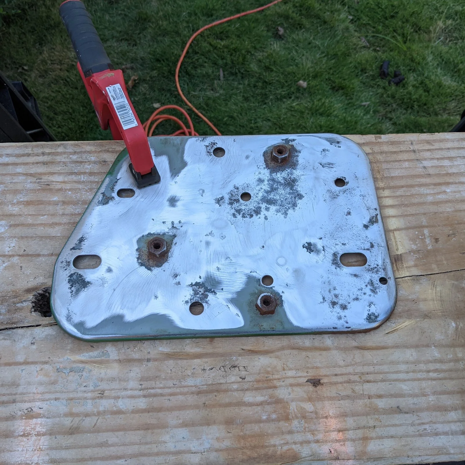

I took a grinder to the abs tray this afternoon. It had some decent rust spots. I'll get it painted and prepped for the locker pump relocation.

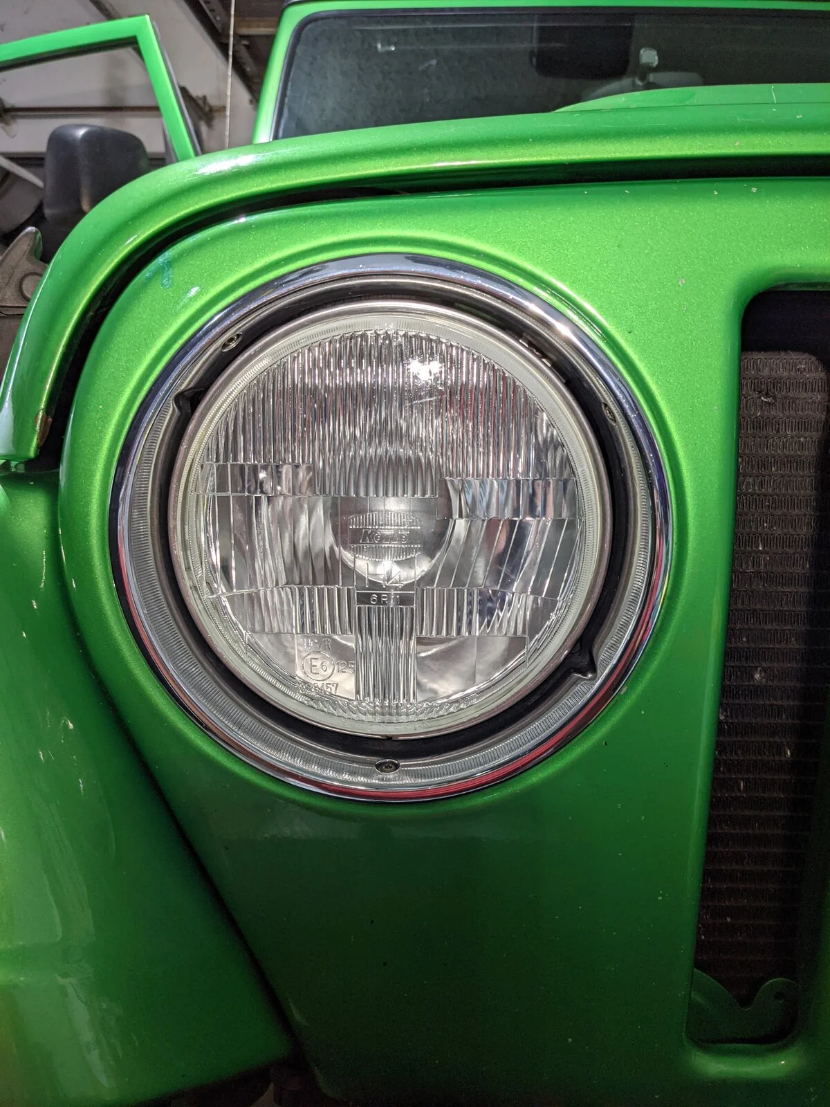

I installed the Toyota headlights with the included harness. Much better than the sealed beams. I need to aim them, but so far, its a worthwhile upgrade.

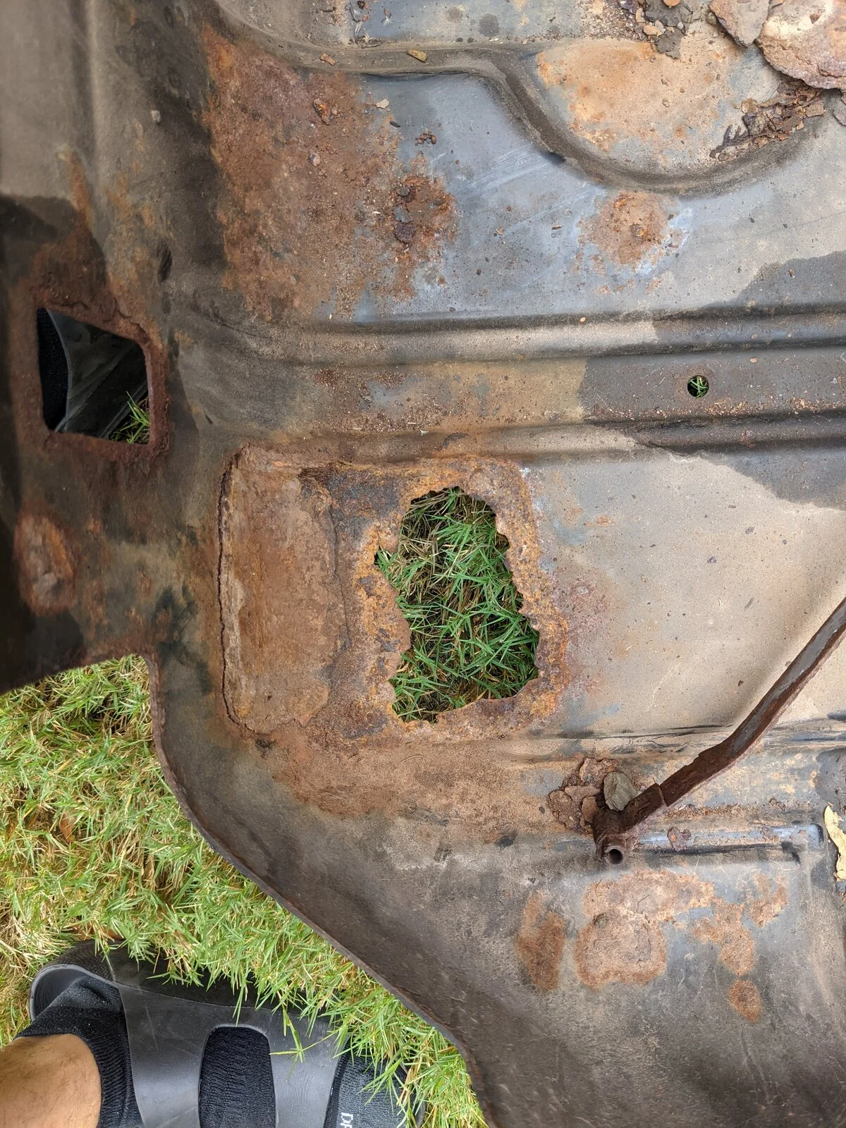

I'm planning to drop the gas skid tonight and assess the rear shock cross member. I'll clean it up and start the painting process tomorrow.

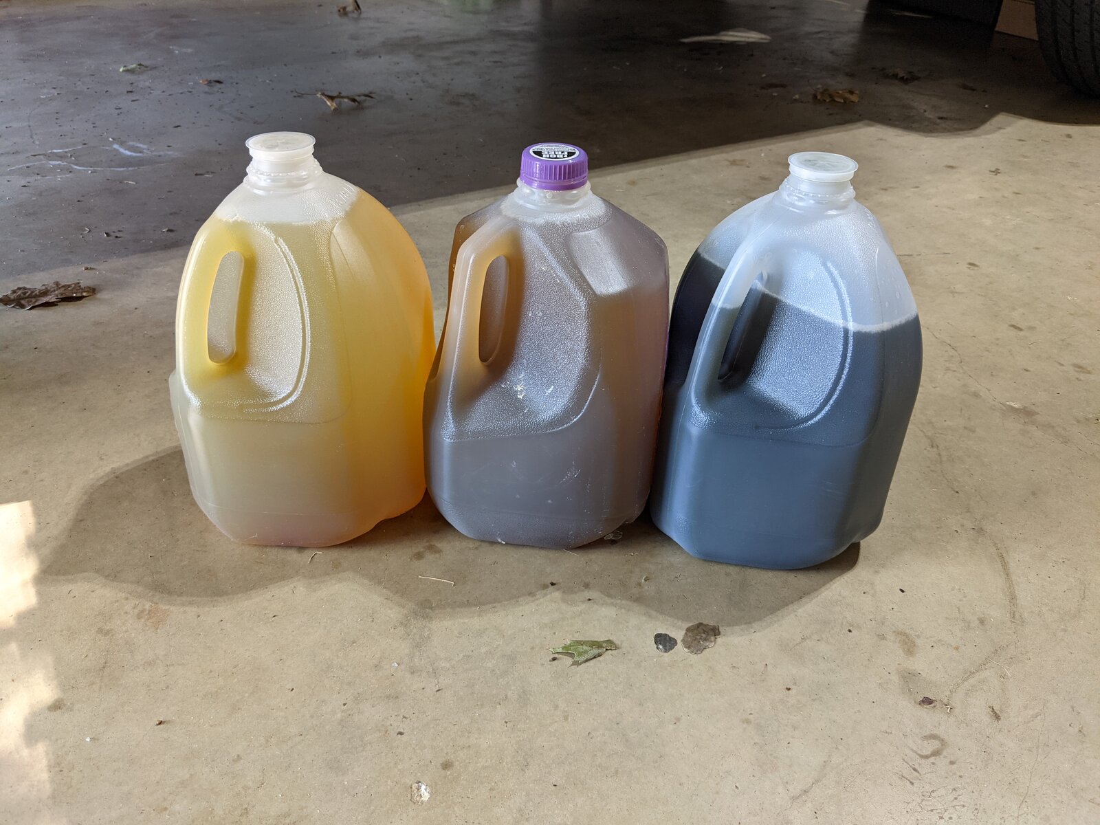

I'm a believer in Thermocure.
Left to right in the order of application:
  • Existing coolant drain
  • Preston flush
  • Thermocure flush
I didn't get pictures but the view into the radiator was a gross brown before the Thermocure and after it was back to looking like metal and much more "normal". I highly recommend.

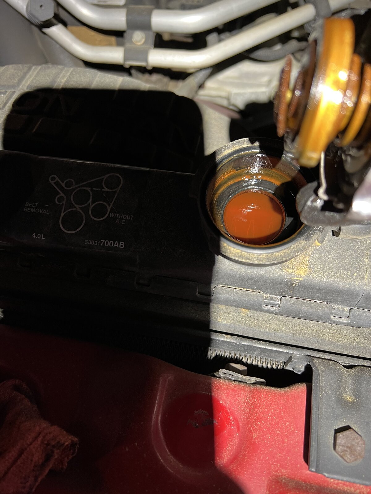

Tell me more… PO allegedly flushed it every 2 years. I’ve already got a new Stant rad cap but would like to avoid a new coolant system.

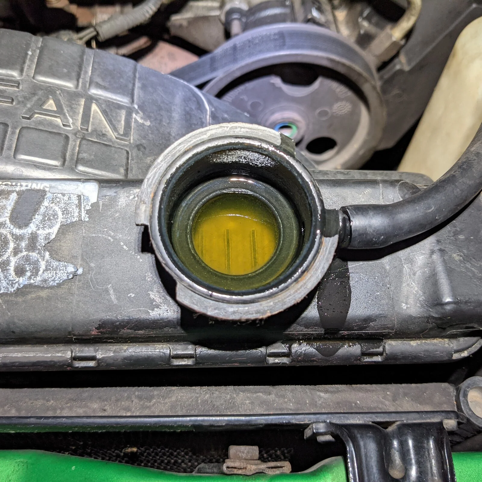

I was right there with you not wanting to replace the entire system. Mine looked exactly like that under the cap when i started the process, but temps were fine and it isn't leaking at all. After, this is what it looks like under the cap:
Admittedly, not perfect, but you can see the fins and its not brown/orange.

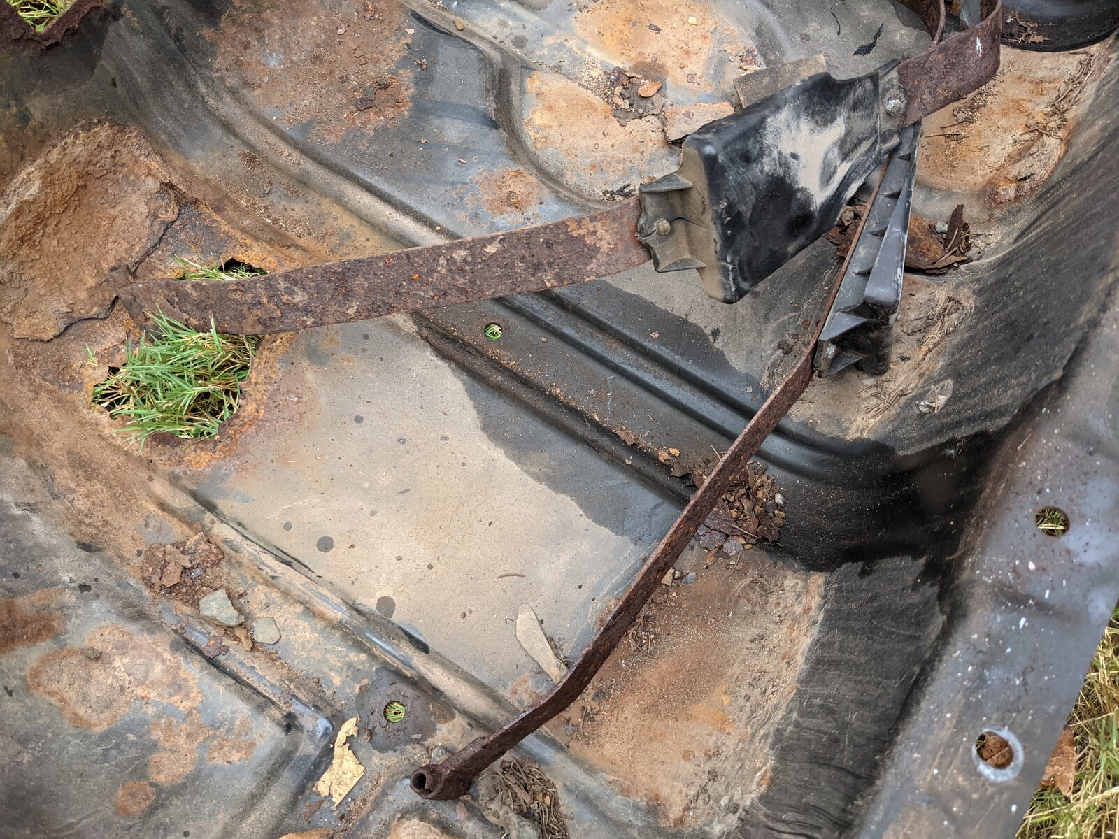

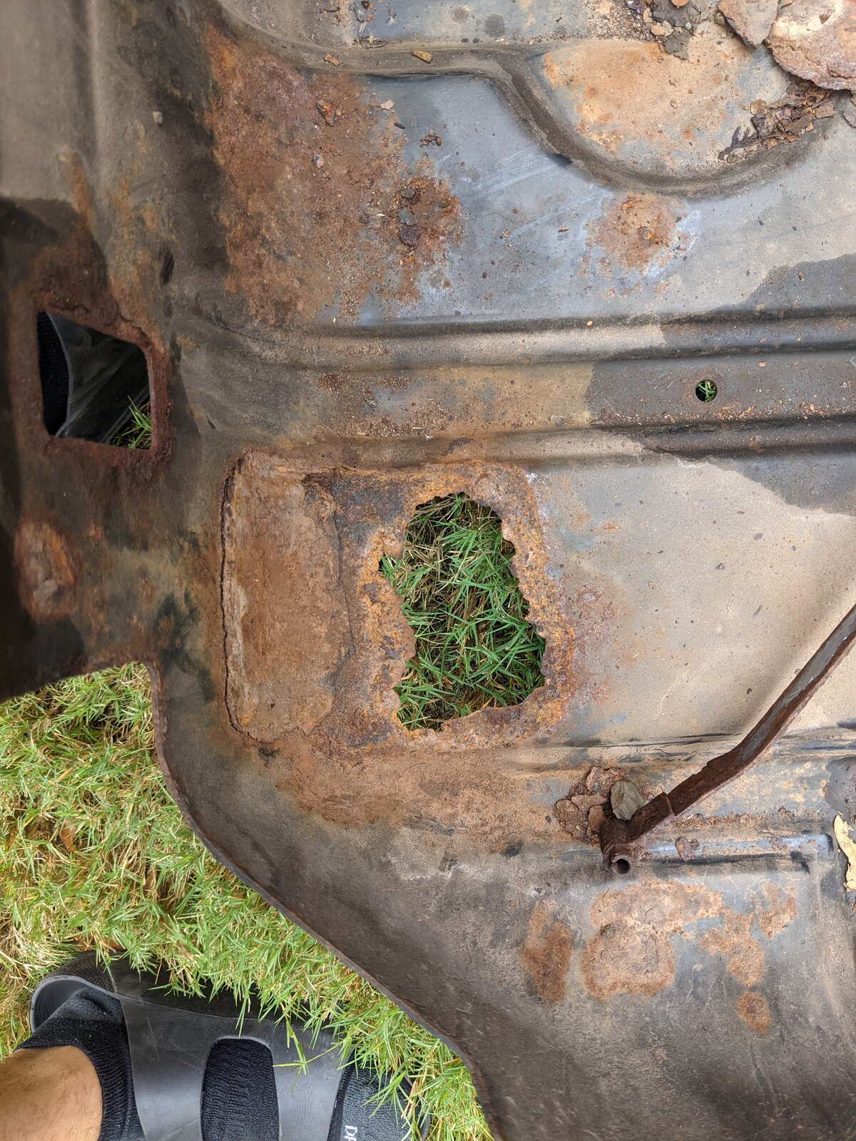

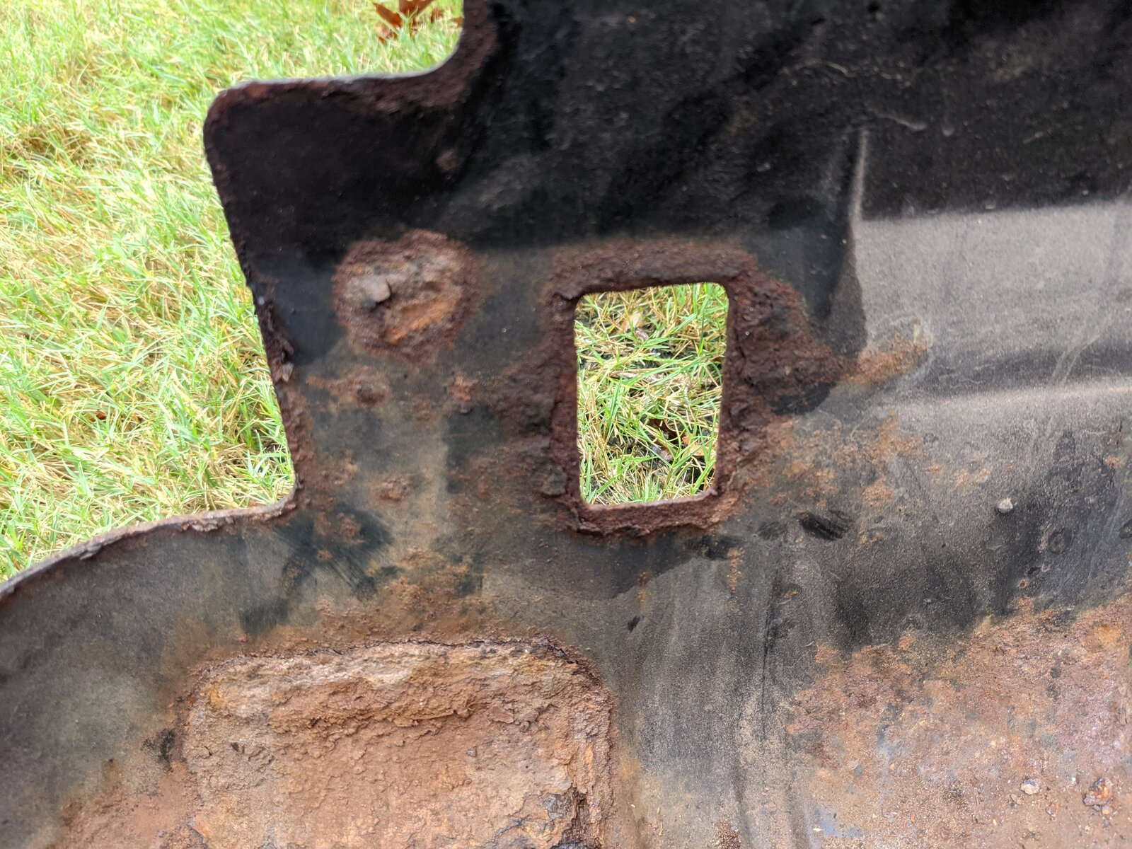

Dropped the tank. It looks like it was patched at one point, but even the patch was a rusty mess. Here's the offending skid:
Replacement straps are on the way.

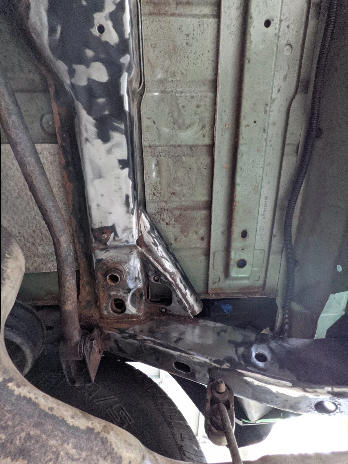

I started the rear shock cross member clean up. There's rust, but its not bad. I broke 3 of 4 shock bolts. I'll finish cleaning it up and coat it in rustoleum rust reformer before prime and paint.
