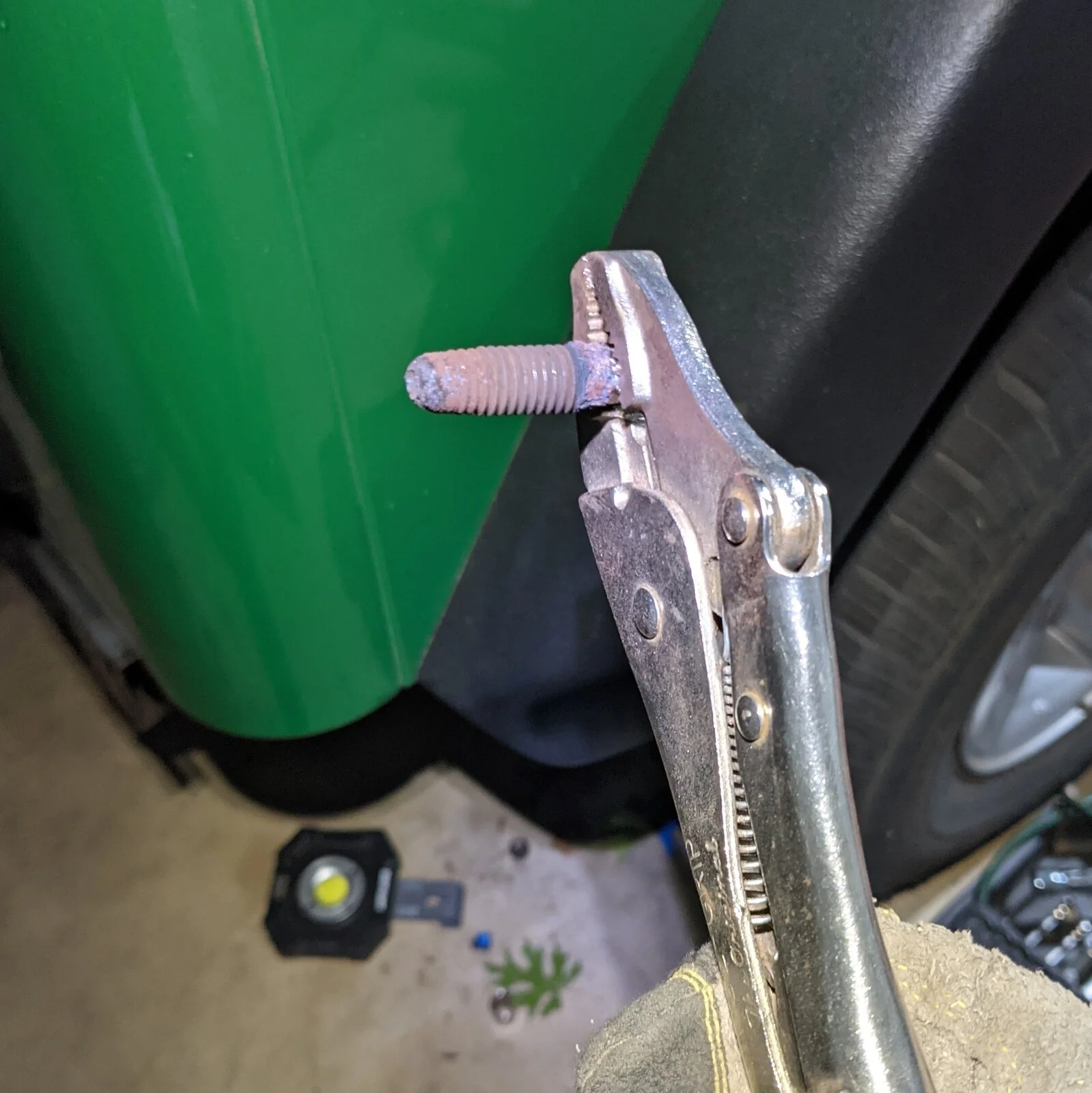

What's your plan for the towhook bolt or did you already take care of it?
I'm going to attempt to use a bolt extractor kit. I fully expect it to be unsuccessful. I've been soaking it in PB blaster (again) for the last few days. If that fails, I'll drill it out and re-tap the hole... Not sure i have many other options.
The free spinning nut inside the frame rail on the other bolt is another problem. I'm going to try to fit a pry bar in the access hole to hold it down. Playing it by ear at this point.
If you have access to a welder, you can weld a bolt head to what you have left. Then take a torch to the bolt and heat it as red hot as you can get it. If you can do this, it will magically come out.

Took care of the broken shock bolts/welded nuts. The right angle dremel attachment made it easy with the mini cut off wheels. I was able to go up through the shock opening from below, cut through most of it and finish it off with a hammer and punch. A few more passes with the dremel to clean up the surface and its ready for paint.

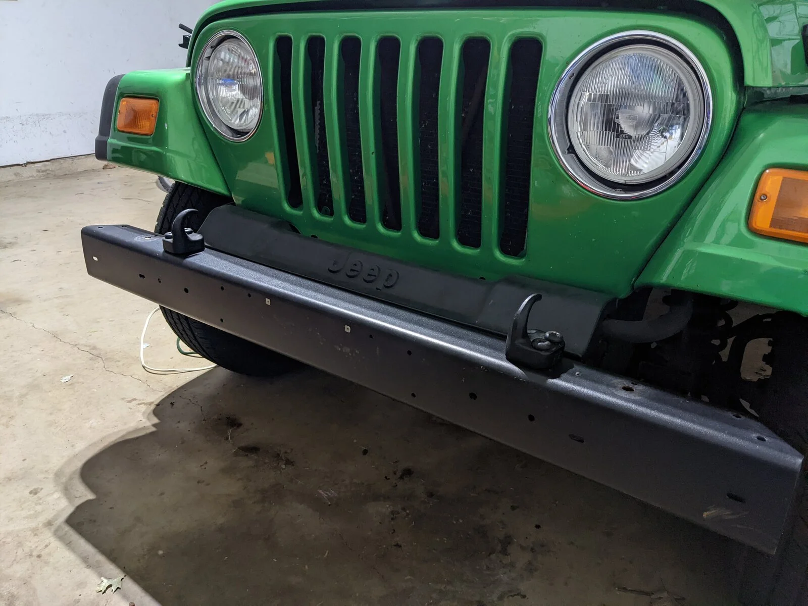

Scored a factory front bumper from a buddy. The pro comp steel bumper that was on there wasn't deep enough for both top-side bolts. My guess is it was meant to pair with a winch plate? The factory bumper looks much better, its lighter and the tow hooks sit level now.

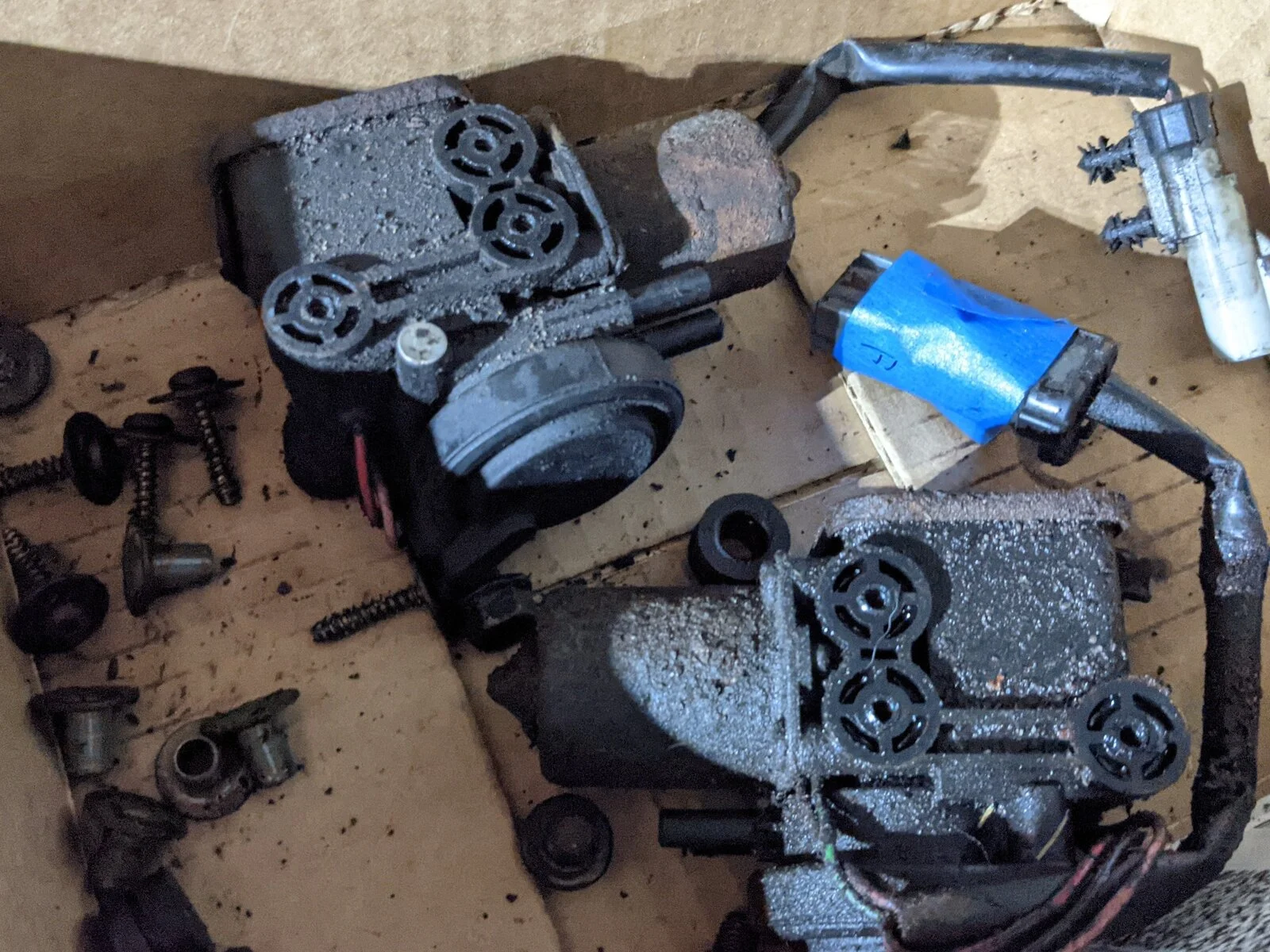

I pulled the factory locker pumps. They are a mess and the caps are a little rusty. I'll clean them up before relocating them. They both still work and hold pressure.

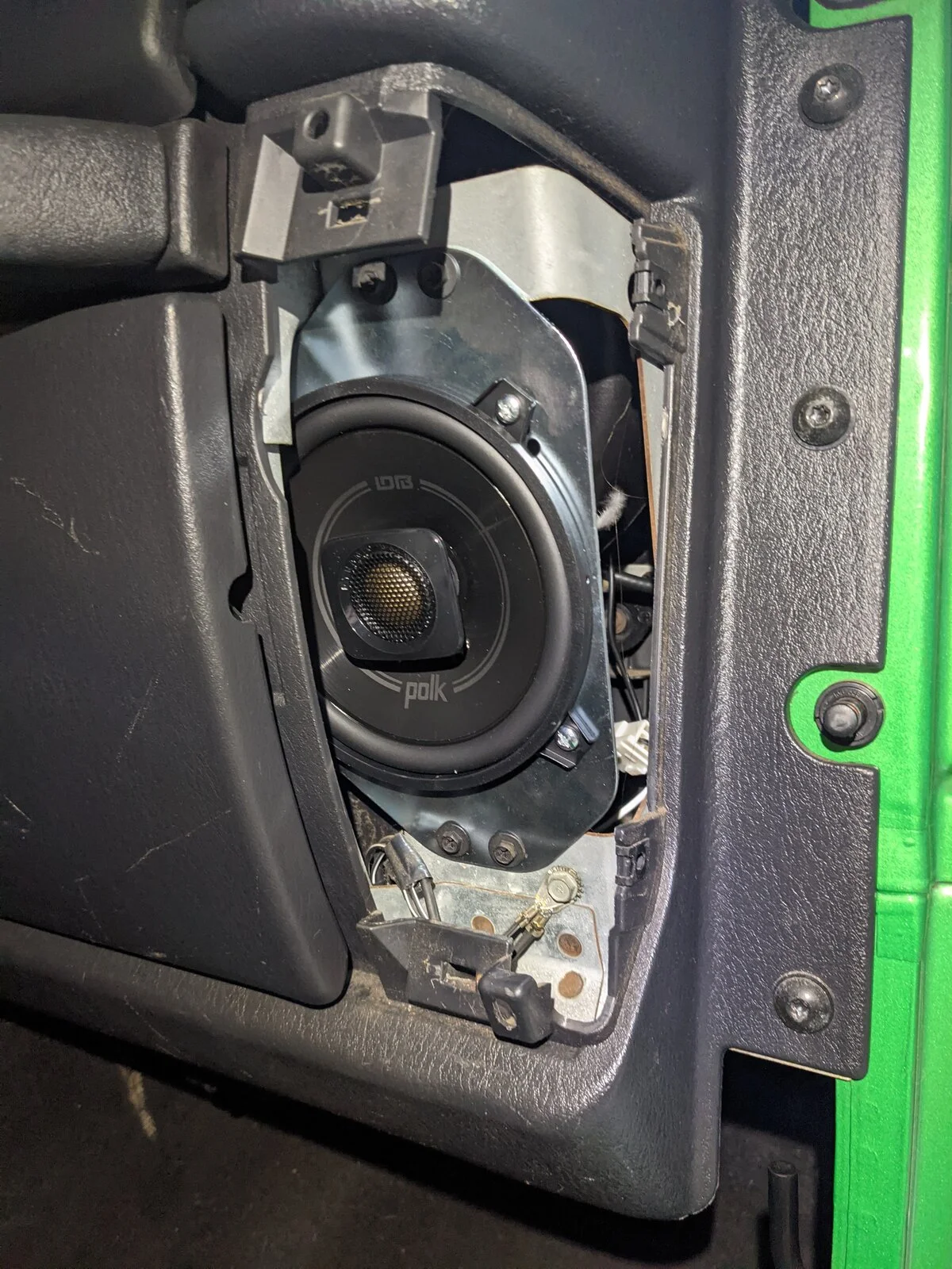

Installed Polk DB522 speakers up front.

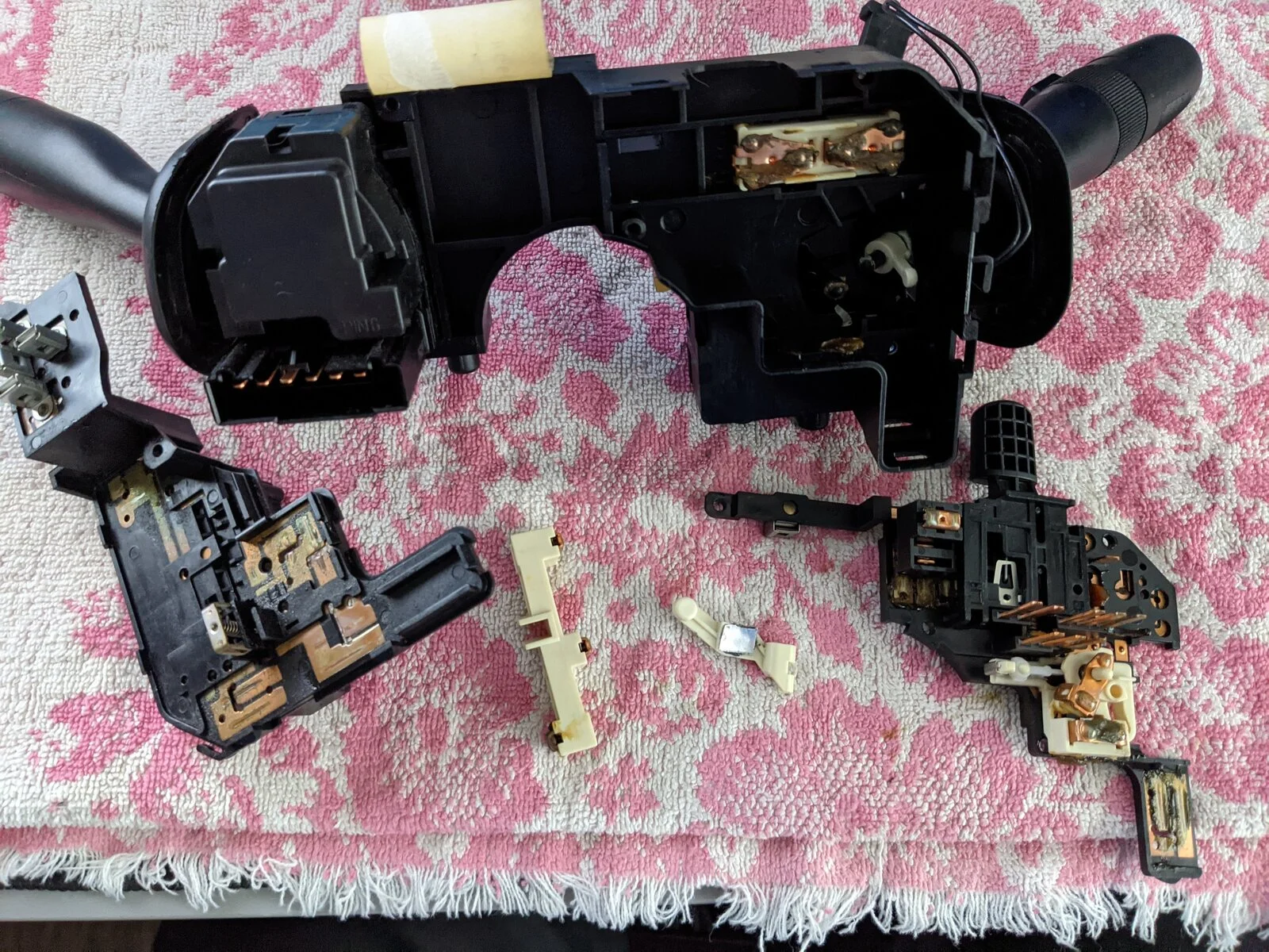

Fixed the fog light switch in the multi-function unit on the column. Used my pretty pink junk towel this time. Just need fog lights now. I found set of KCs for $80 locally that I might pick up.

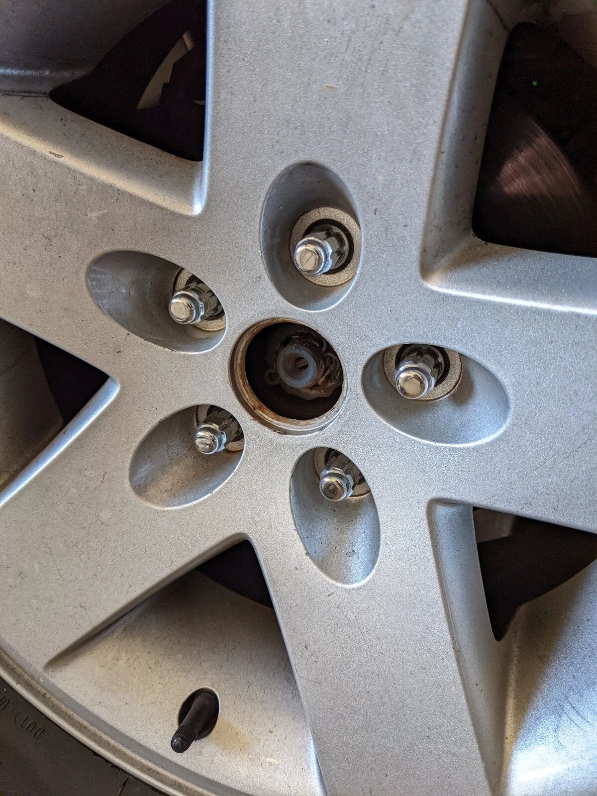

I took another look at the installed lugs. The kit looks like its made by Gorilla. You can see in #47, the lugs are evenly slotted. I was never given a key, but I found a slotted key online that works perfectly. I started swapping the lugs, get the fronts done and move to the rear passenger wheel and the lugs are different... All 5 of the unique keyed lugs are on this one wheel.🤨 I've been told discount tire will get them off if you don't have the key for fairly cheap. I'll give them a call today.

I'm still fighting with the keyed lug nuts on the last wheel. I've tried a bunch of sockets and nothing seems to fit well enough. A 17mm deep socket was close but i could not get it to seat on the nut enough to break the torque. Discount Tire was kind of iffy when I called, but I think I'm going to take it to them and see if they can do it.

The issue with mine is the lugs don't protrude past the face of the wheel combined with the dish of the moab prevents me from using most of the methods. The second issue is the lugs are relatively small, ~17mm. The tool on the shelf at my auto parts store would be too big.
My best bet is to find a socket i can pound on the lug and to be honest, I haven't taken the 3lb sledge to it, but it looks like that's the missing piece.
If a $5 socket doesn't do it, the next step after that would be to get these from amazon and see if the 17mm will work.

I used a socket that is made to be hammered on to a rounded over nut to remove the wheel locks that were on mine.
Interesting. Something like that sounds like it would work. Any chance you have a link?
