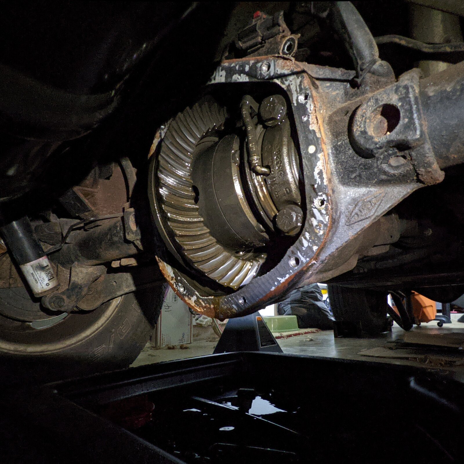

Opened the rear diff last night. My oldest volunteered to help. Its nice to have extra hands to hand you tools. I quickly learned your helper needs to know the names of tools to be... helpful. I did get really good a describing where and what to look for. :LOL:
I started working on the locker air fitting replacement. Getting the old one out is going to be more challenging than expected. Gears, oil and everything else look to be in great shape.

Huge thanks to @Mike_H for his write-up on replacing the factory locker air fitting. These are running $100-125 online these days. Following his instructions, I put together a homemade replacement.
After fighting with and removing the rusted original, the replacement slid right in. The copper tube is line to line and the pressure holds. This is the test fit before adding JB Weld.
I have a set of functioning lockers!
The front line has an air leak somewhere. It locks, but the pump runs every 3 seconds or so. I'll diagnose that some other day.

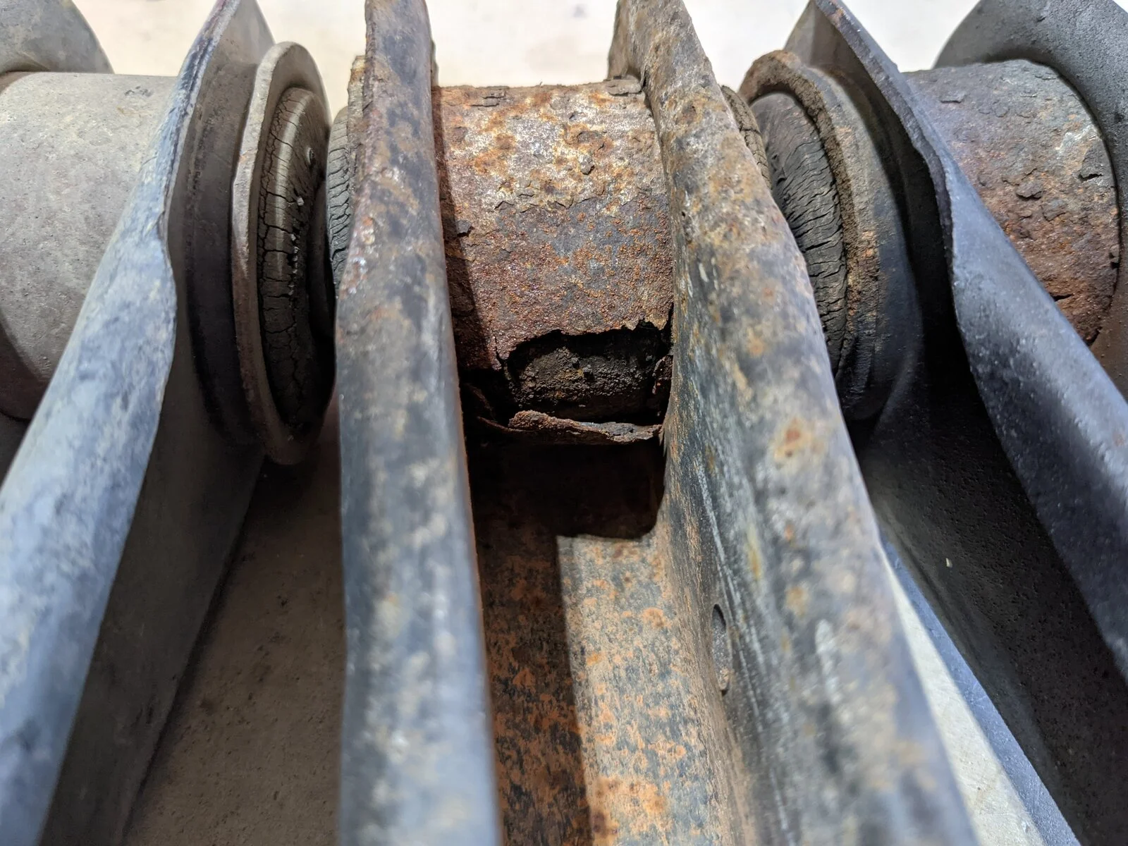

@nk24 shipped me a set of lower control arms that I installed a while back. Here's why I needed them. The replacement is on the left. The other two are my original rears.

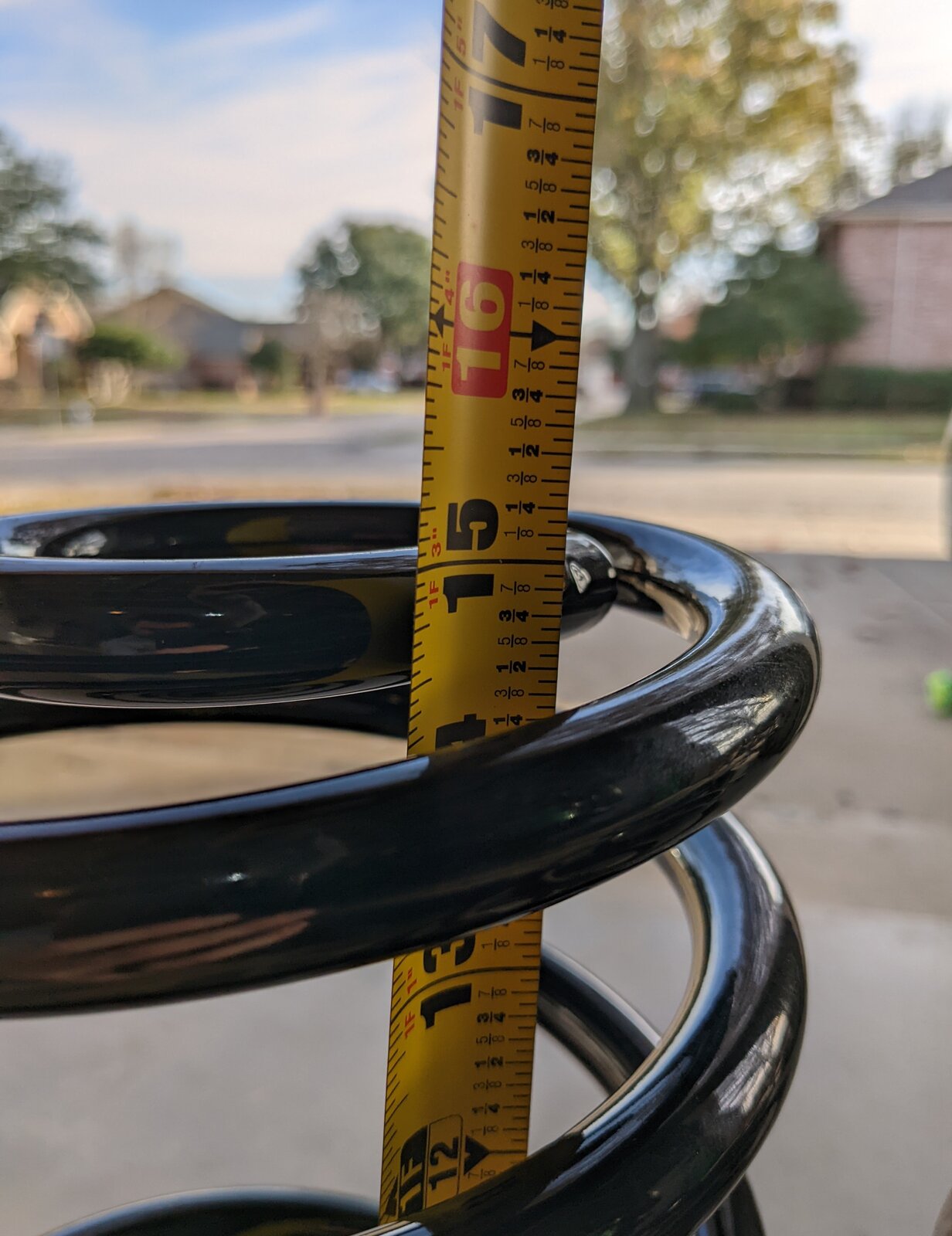

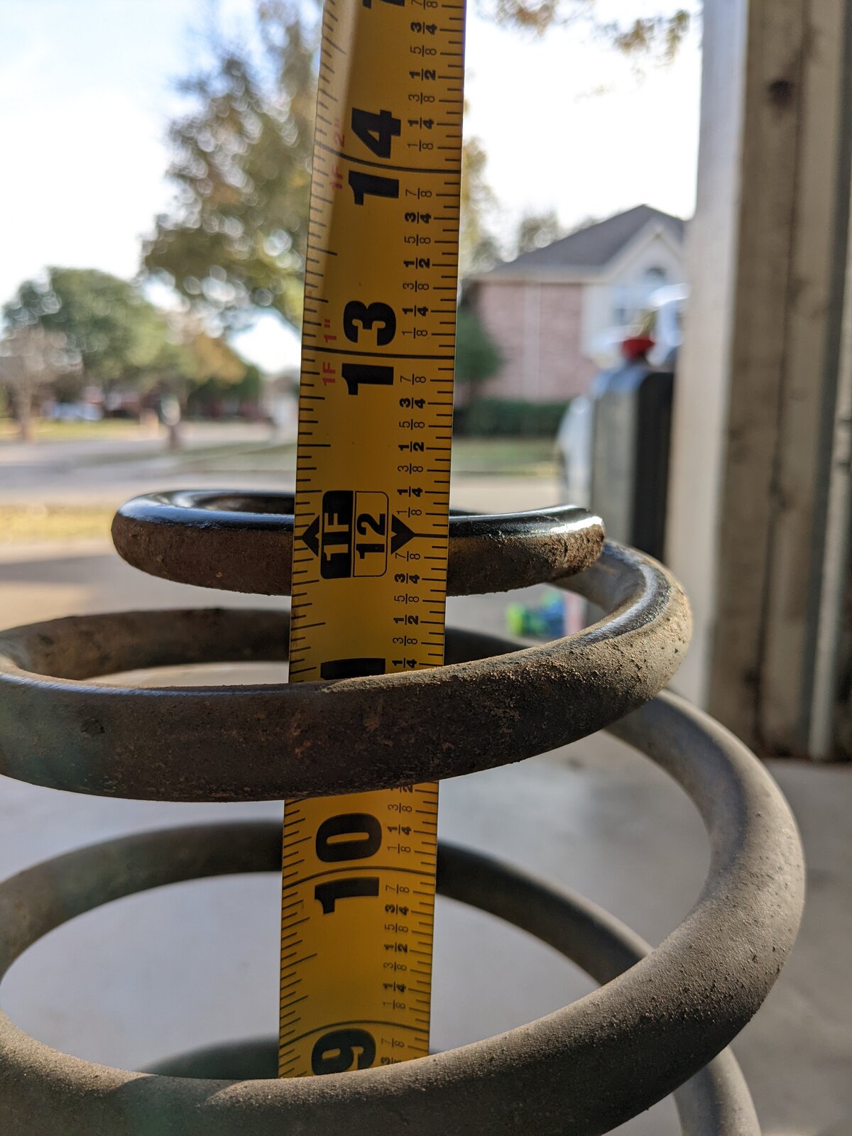

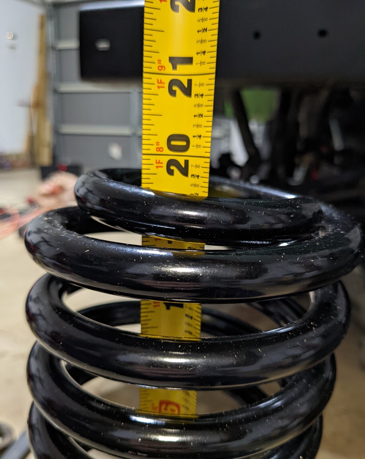

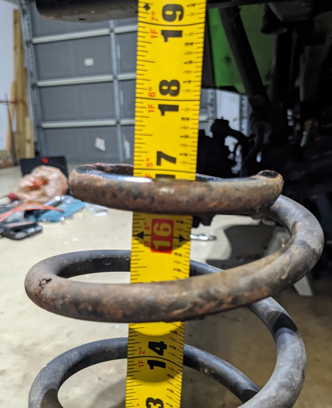

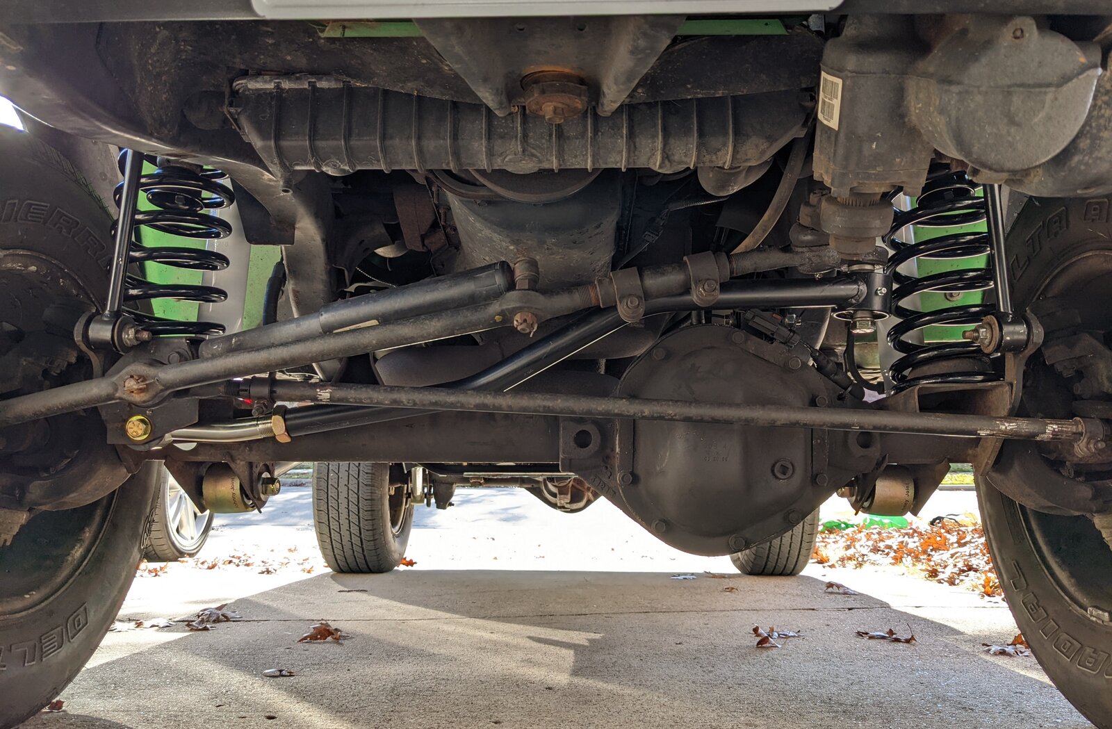

Lots of updates over the past few weeks. Christmas brought GraBars and a Spiderweb shade and the time off from work let me tackle the lift. Pretty much nothing went smoothly between the rusted bolts and trips to the hardware store for sockets and drill bits. I even managed to smack myself in the face with a crowbar fighting with the front track bar. The toughest parts were getting the rear track bar back in and the seized tie rod.
Complete Savvy Control Arms
JKS 3" springs
Rancho 5000x 55239/55241
RockJock front track bar
BMB Johnny Joint Washers
OME Track Bar Bracket
New jounce cups
Zone sway extensions

Still a list a mile long of things to do.
  • Tires. I need them. I'll be ordering the Cooper Evolution M/Ts in 285/75r16 from Discount Tire in the next week.
  • Cycle suspension, set bumps and measure shock travel. At first blush I think these shocks might be too short. As it sits, there's probably 70/30 up/down travel. I need to get actual measurements. @Farmergreg - I think you have this same spring/shock combo, though yours is an LJ. Did you have any concerns with shock travel on yours?
  • Set control arm lengths for caster and wheel well centering. I really only adjusted the rear uppers to get the rear pinion as happy as possible with the stock driveshaft. I've had it out around town a few times and I might be getting a little low "growl" on acceleration. New tom woods shaft is ordered.
JKS 3" springs
New jounce cups

Rears:
View attachment 299339View attachment 299340
Fronts:
View attachment 299341View attachment 299342

I don't recall the shock absorber part numbers, but I believe they were for a 2" lift. Pretty sure I have 2" of bump stop on the bottom pad. But I'd have to measure the bias to be sure. It's been about three years now so memory is fading a little. Everything is holding up well. The JKS springs still have air space between those tighter top coils. I just had it on the hoist in prep for dragging it out to arizona.

Awesome. I'll cycle everything and see where i end up. Thanks!
