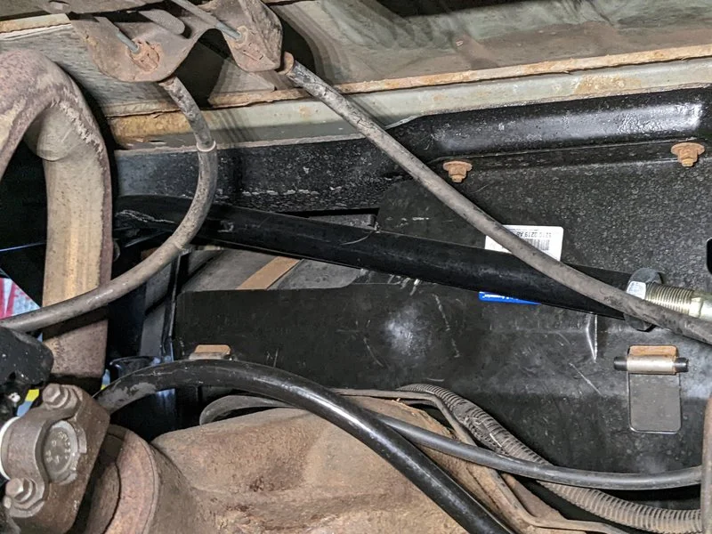

Track bar and bracket, jounce bumpers, bumpstops and driveshaft are all in. Stupid JKS track bar is just grazing the gas skid, as expected. I'll take a 1/4" out of the lower CAs, reset everything and see where it is. Right now, lowers are at ~16", pinion angle is 15.5*, DS is at 16.2*. Also, my rear shocks are definitely too short. Confirmed, I've only got about 2" of down travel with the 55241s.
Finished up the rear this evening. Shortened the lower links to ~15.75" and squared the axle to the frame. Pinion is 15.4*, driveshaft is 16.2*. JKS track bar has clearance around the gas skid. I have not cycled everything again so more tweaks to come. I replaced the lower shock and track bar bolts with replacements from Bolt Depot. I got her up to 70mph on a late night joy ride with the top down. Zero issues, zero vibes. Noticeably smoother with the CV DS.

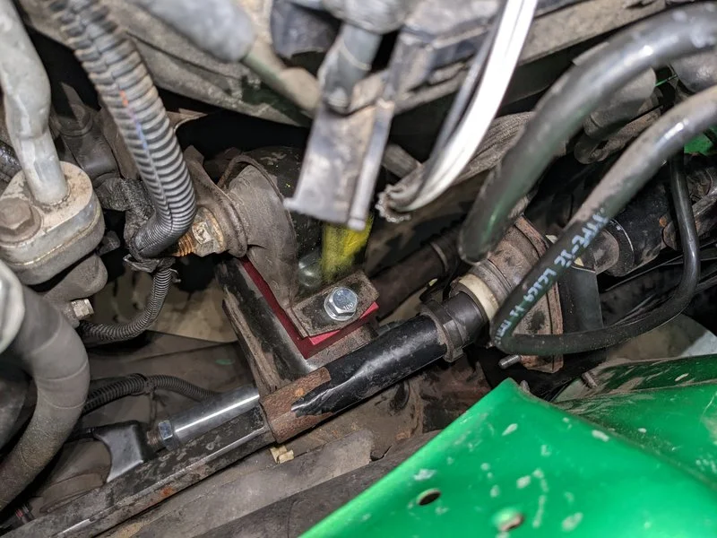

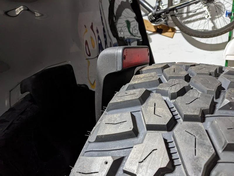

First, the progress. Body lift, motor mount lift, MORE steering riser and UCF extra-clearance skid plate are all installed. I love/hate the body lift. The butt crack looks like ass, but the belly clearance is worth it. Plus, the spare now fits and clears the bumper on the stock carrier with the lower snubber trimmed down. I'll black out the exposed green at some point and it will look better. No fan shroud modifications were required either which was nice.

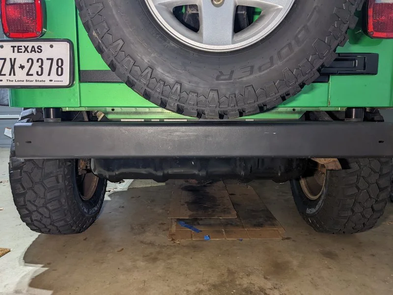

Rear axle... fun. I had to further shorten the lower CAs to close to their minimum and extend the uppers. the angles are 22* on the DS and 21* on the pinion. Seems really steep, but I'm only at a 3" spring lift with the extra clearance skid, and I know there are others with 4" and the extra or ultra (or savvy) skids out there. No "vibes" to speak of, but the butt-dyno says its not as smooth as it was pre-tuck. We shall see.
The driveshaft may need to be lengthened. I ordered it as a best guess not knowing when I'd install the tuck. I should have known better that I wouldn't wait to get the tuck done. I'll call up Tom Wood's this week and get their input.
After the tuck, the additional pinion rotation caused more (predictable) issues. The track bar is unhappy again, making contact with the edge of the gas skid. Just need to clearance the lip of the skid plate or (eventually) get a correctly bent rock jock track bar.

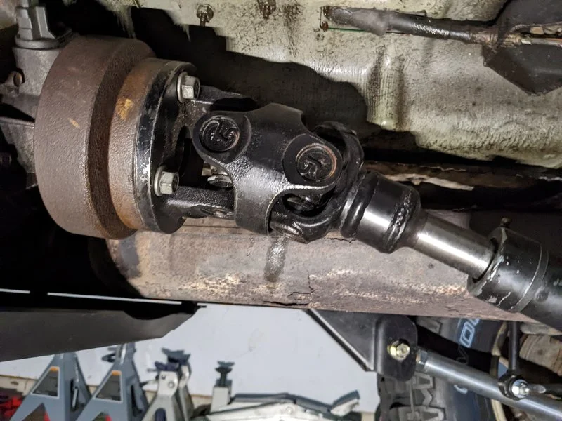

Be sure to check your double cardan for clearance at full droop. Hard to tell, but it looks close to binding sitting at ride height.
Reactions: PRNDL and Wildman
Be sure to check your double Cardin for clearance at full droop. Hard to tell, but it looks close to binding sitting stride height.
Yep, I share that concern.
What are the options if there is bind before the shocks bottom out? Like I mentioned, there are more severe combinations of lift and tuck out there. Are the only options after that swapping the gas skid for a higher clearance option and moving the axle back?
Check and see if it is a problem first before looking for a solution. If it binds, it could be as simple as clearencing the cardan housing, but you don't know until you test it.
