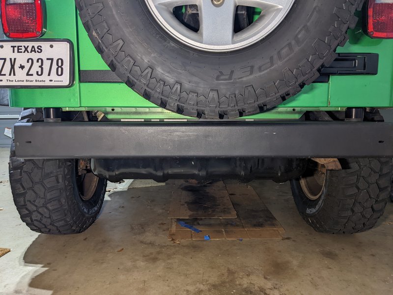

First, the progress. Body lift, motor mount lift, MORE steering riser and UCF extra-clearance skid plate are all installed. I love/hate the body lift. The butt crack looks like ass, but the belly clearance is worth it. Plus, the spare now fits and clears the bumper on the stock carrier with the lower snubber trimmed down. I'll black out the exposed green at some point and it will look better. No fan shroud modifications were required either which was nice.

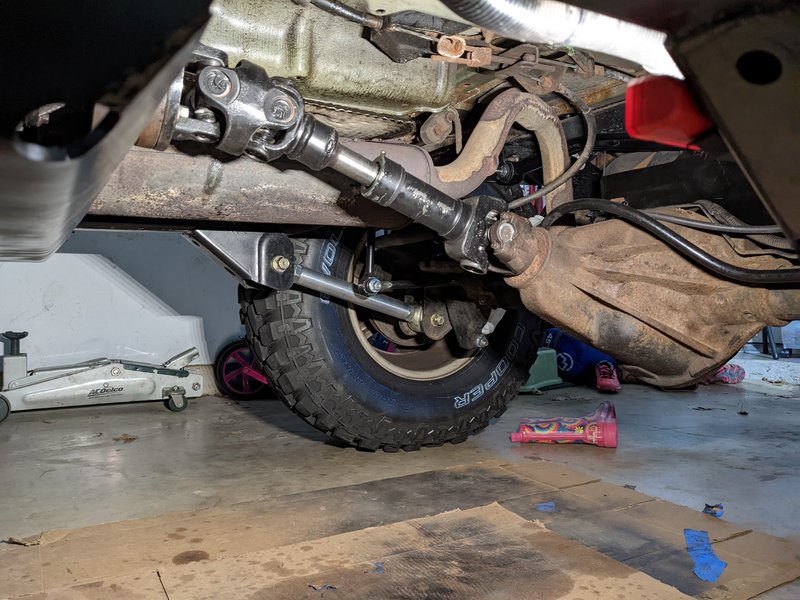

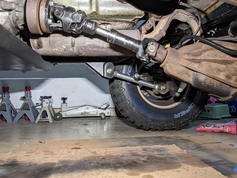

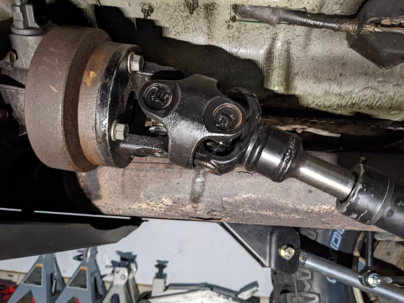

Rear axle... fun. I had to further shorten the lower CAs to close to their minimum and extend the uppers. the angles are 22* on the DS and 21* on the pinion. Seems really steep, but I'm only at a 3" spring lift with the extra clearance skid, and I know there are others with 4" and the extra or ultra (or savvy) skids out there. No "vibes" to speak of, but the butt-dyno says its not as smooth as it was pre-tuck. We shall see.
The driveshaft may need to be lengthened. I ordered it as a best guess not knowing when I'd install the tuck. I should have known better that I wouldn't wait to get the tuck done. I'll call up Tom Wood's this week and get their input.

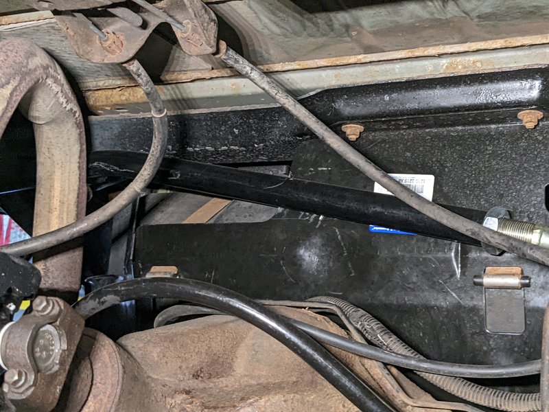

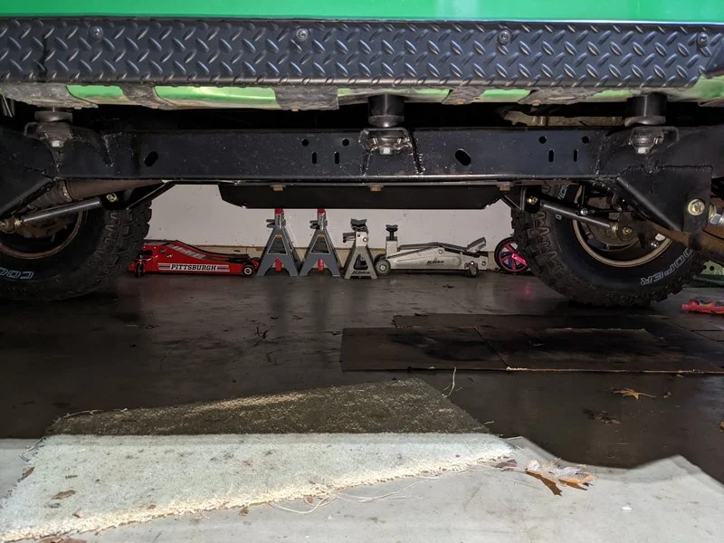

After the tuck, the additional pinion rotation caused more (predictable) issues. The track bar is unhappy again, making contact with the edge of the gas skid. Just need to clearance the lip of the skid plate or (eventually) get a correctly bent rock jock track bar.

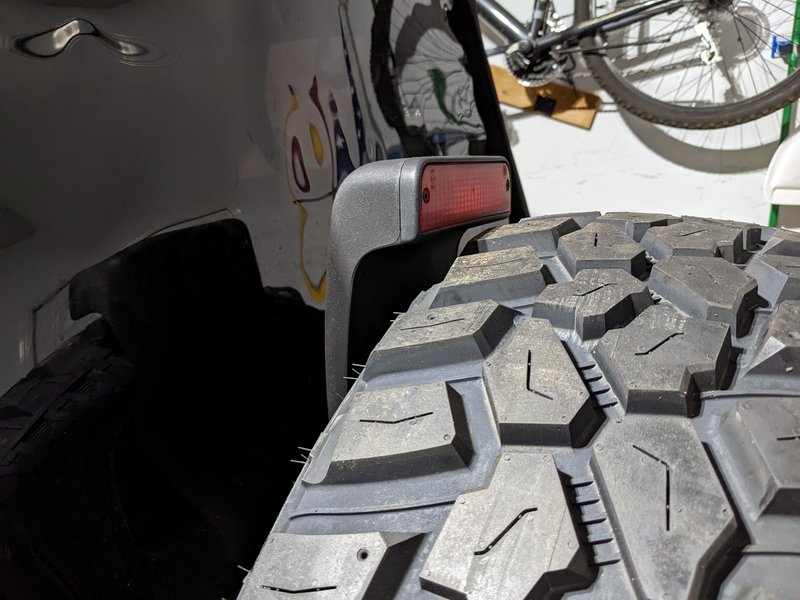

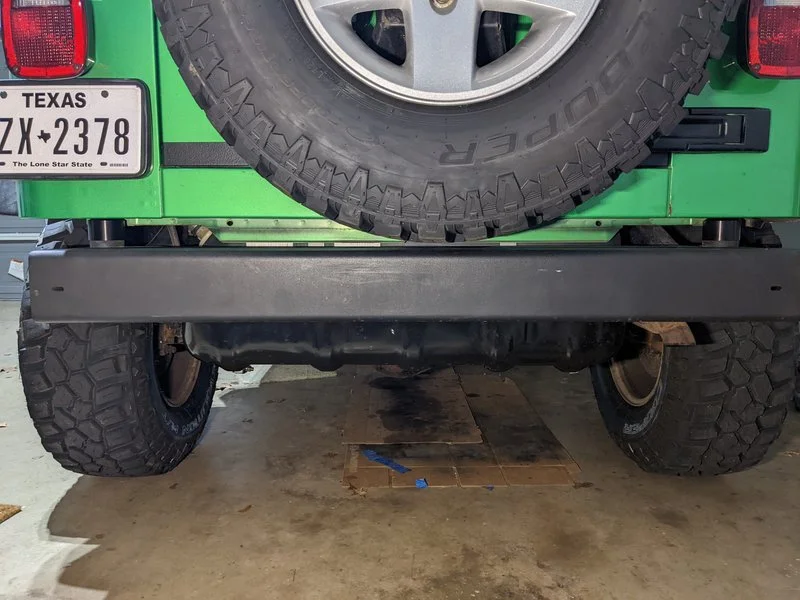

Which BL did you go with and what are you doing for the spare tire? I really need the BL since my 33s are bigger than I had planned for, but at least I’ve got the full size spare supported/rubbing on the bumper. If I go BL I’m worried about needing to do the tailgate reinforcement.
Savvy BL. Once that was installed, my spare cleared the bumper on the factory spare carrier without a relocation bracket. the 5" backspacing on the Moabs helped here i think. I'm going to keep an eye on it but it seems fine for now.

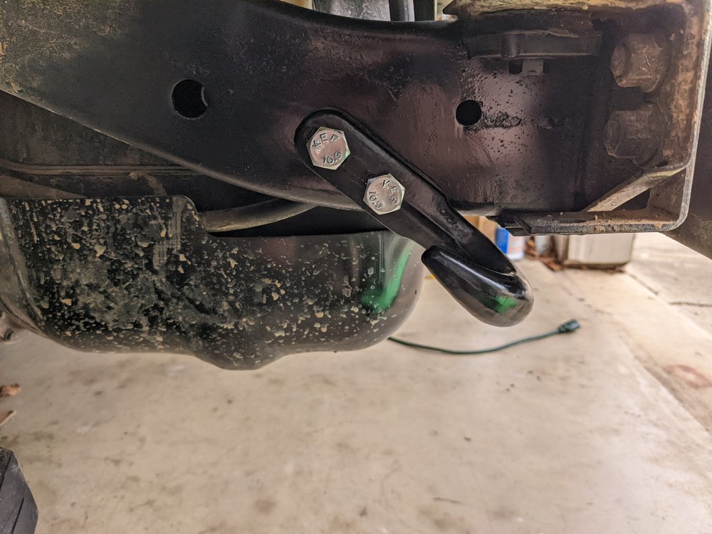

Installed a rear recovery point:

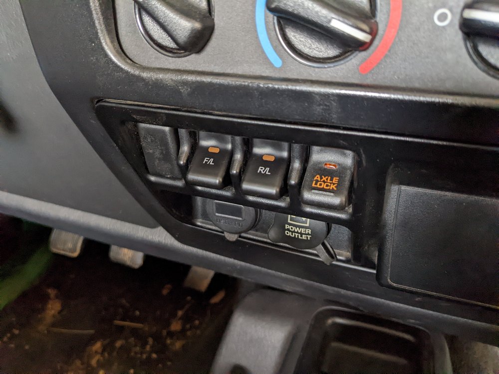

Started wiring for independent locker controls. I have relays arriving this weekend to get the lights to function. Yes, I'm keeping the stock axle lock switch in place until I need the slot for something else.

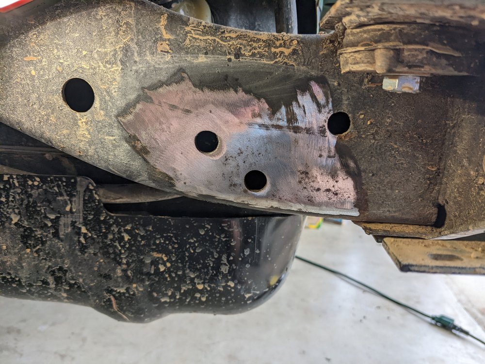

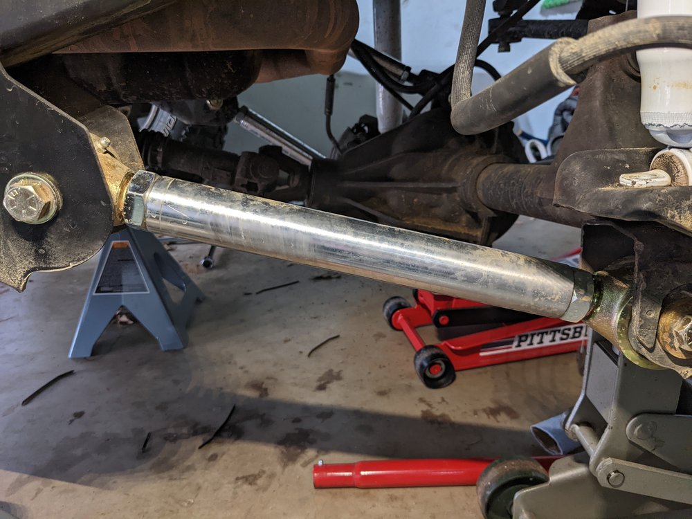

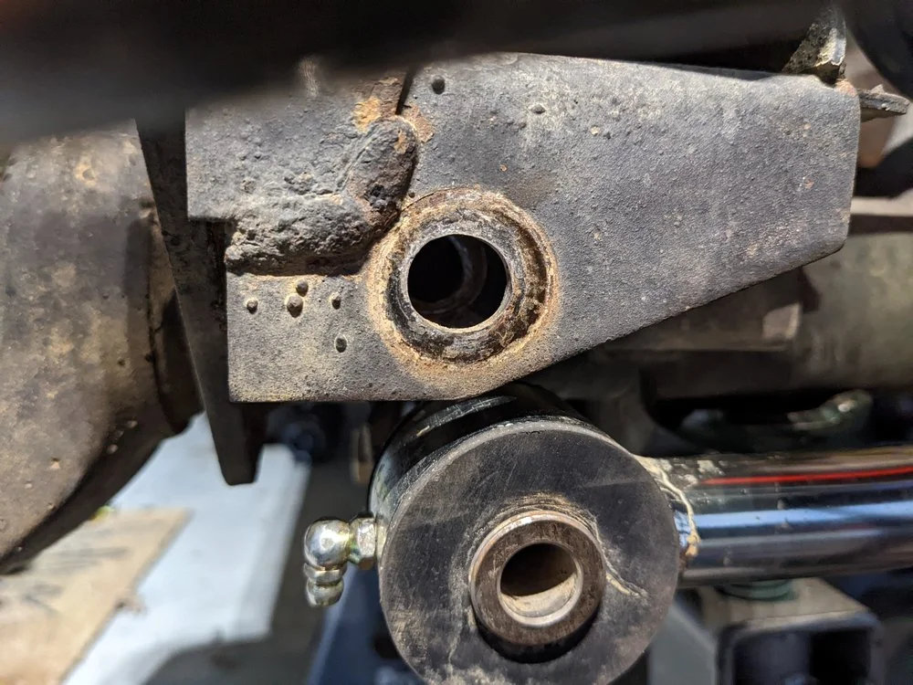

I noticed this when I installed my front track bar, but revisited it again. The axle side mount looks like its either wallowed or was drilled out. Not sure if this is a big deal or not.

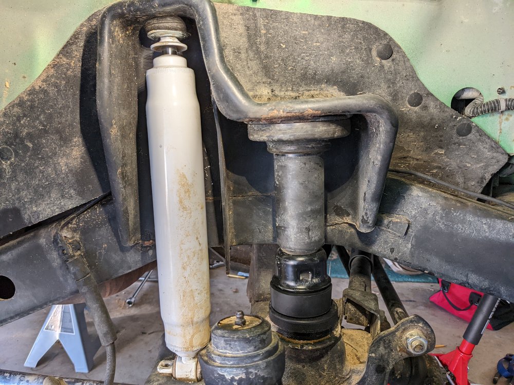

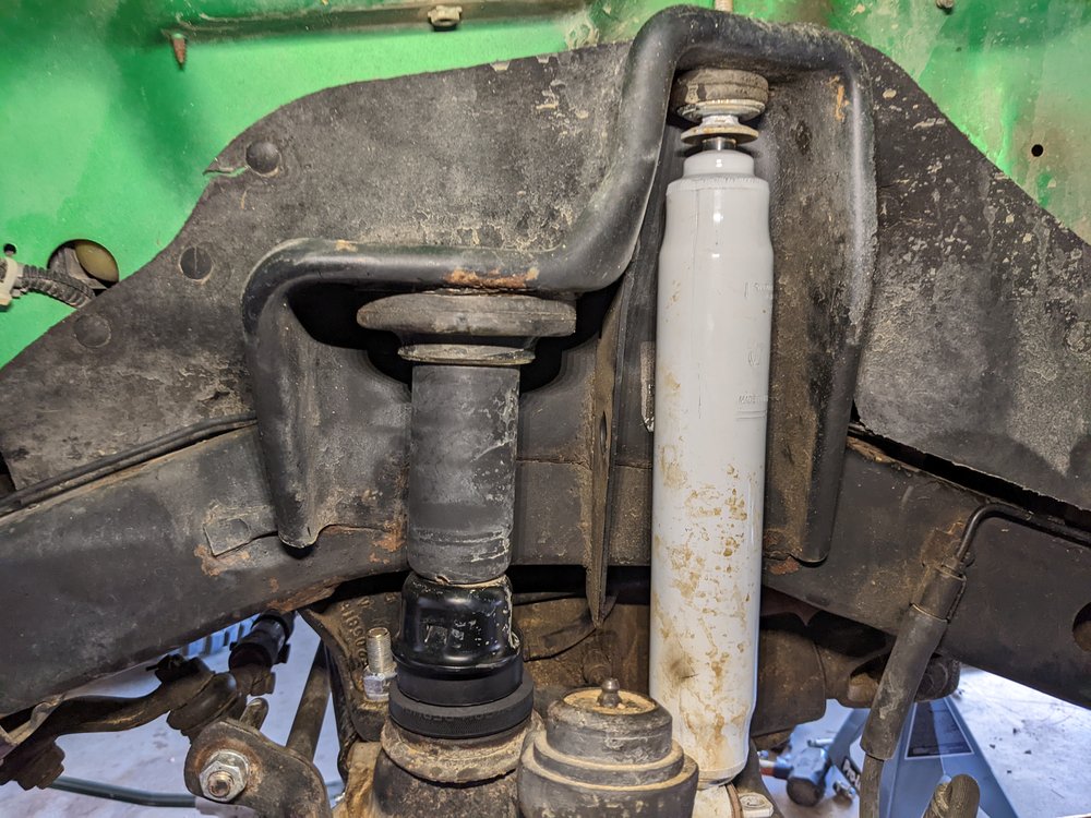

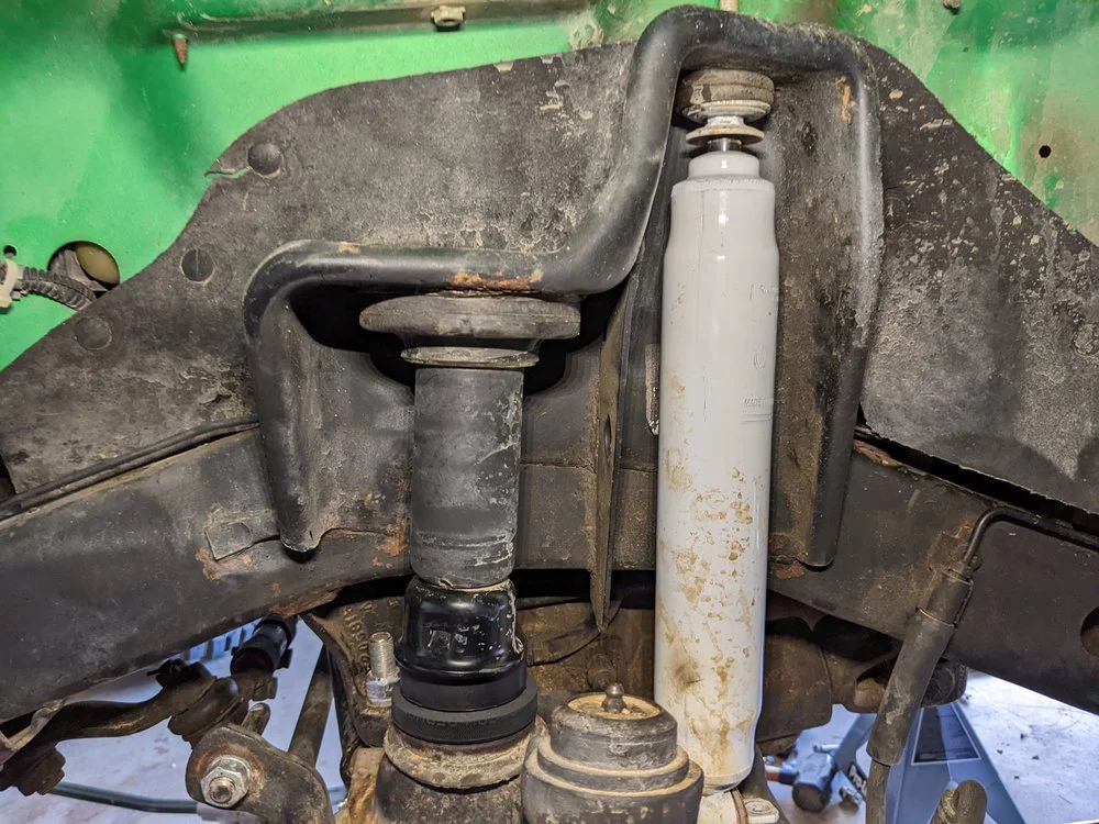

Cycling the axle, the jounce cups and spring perches were off laterally by about 3/4" at full bump. The axle is square to the frame, but checking for center, it was only off about 1/16". Not sure where the miss is, I'll dig into it more this weekend.

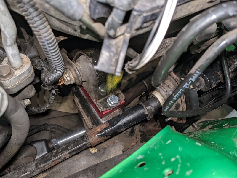

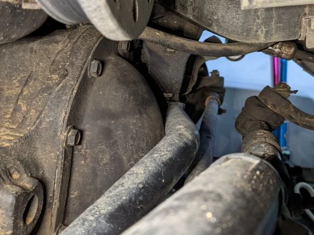

Track bar made contact with the diff too. Not enough to catch, it slides, but I'll adjust. I saw later the frame side JJ wasn't level after this picture but, rotated with the rear side up. Not sure exactly if/how that would change things.

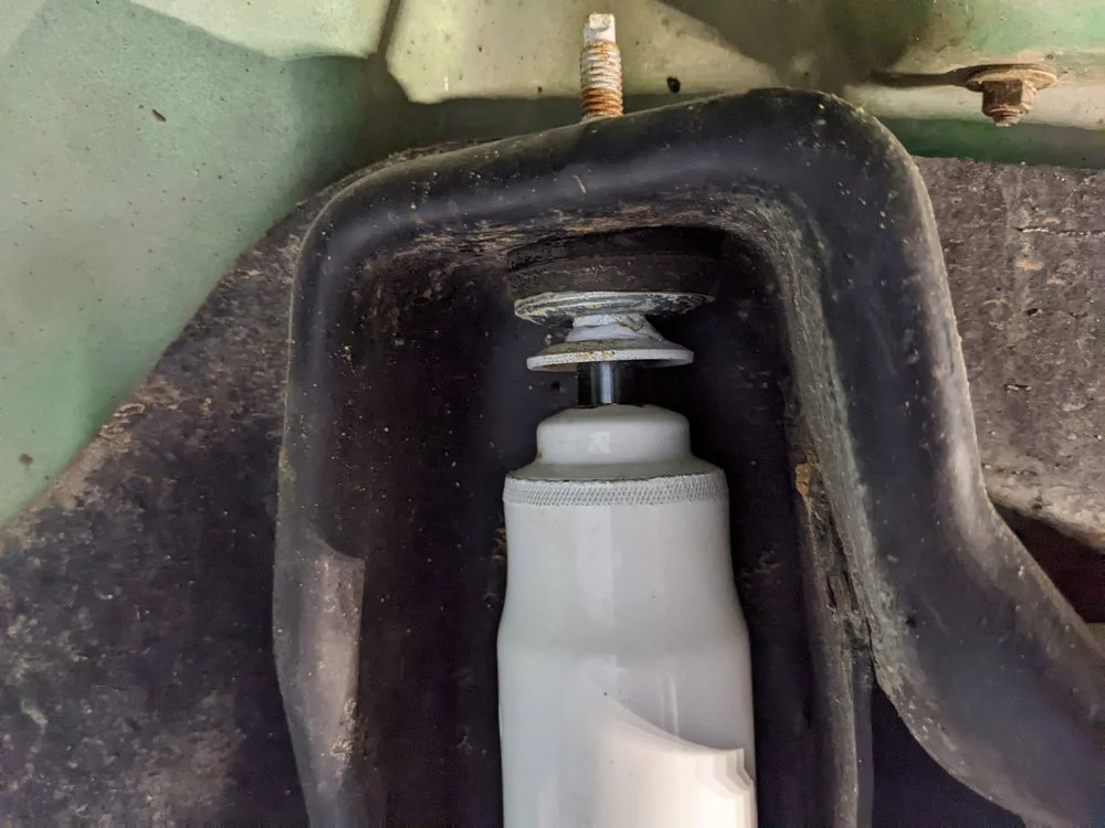

The good news is I only need 2" of bump stop with another half inch on the shock visible. I may get a few hockey pucks to cut in half to take advantage of that last half inch. I screwed up the passenger side pad and drilled the hole too big for the 1/2" tap. Guess I'll move up to 9/16".

  • Persuade the gas skid to provide a bit more clearance on the rear track bar.
View attachment 314760View attachment 314761
If you wanna be fancy, you can pop the plastic toggle switch out of the switch housing and swap it into your locker switches to look more factory.

So the jounces and pads miss each other by 3/4” or just aren’t centered by 3/4”? When you center the axle at ride height (which is correct), the axle won’t be centered at bump due to the arc it makes from the trackbar straightening out. I would definitely make full hard bump right when the shocks reach full compression. No need to leave that extra 1/2” on the table.
Reactions: PRNDL and Wildman
So the jounces and pads miss each other by 3/4” or just aren’t centered by 3/4”? When you center the axle at ride height (which is correct), the axle won’t be centered at bump due to the arc it makes from the trackbar straightening out. I would also make full hard bump right when the shocks reach full compression. No need to leave that extra 1/2” on the table.
Thanks, that helps a lot. The jounce cups and pads make contact, but miss center by about ~3/4". I was reading conflicting information about where they should be at full bump vs ride height. In my head, it makes sense that it would not be centered for exactly the reason you mention. My efforts to center the axle have all be done at ride height so I think I'm good there.
Good confirmation on the bump setting. I'll reduce the bump stop extension to take advantage of the final 1/2" of shock travel.
When people talk about centering the jounce and pad at full bump, they are talking forward to back. Really that doesn’t matter much either. As long as they make solid contact and everything clears with the pinion angle set and all that then you’re good.
As far as your TB hitting, what are your lowers set to? With a mild pinion angle, 16” lowers seem to be a good starting point. I have a very low pinion angle because I have a hub kit so mine are set at 16.25”. My dad had to pull his in to 15.75” with his more extreme pinion angle to keep the TB from hitting the diff.
Got it on the bumps, I'll work toward that.
Lowers measure just over 15.75".
EDIT: I haven't spent much time on the front pinion angle at all.
I’d keep them at 15.75 and get her on the springs and wheels, set your pinion angle with the uppers for now, then cycle again since that pinion angle will affect how much the diff hits the TB. If stuff hits then you’ll have to bring both the lowers and uppers in a smidge and maintain same pinion angle.
Edit: you also want to balance the caster and pinion angle. Ideally you want as much caster as possible without driveshaft vibes. If you have no history of vibes, try starting with your pinion 3* lower than driveshaft and test and see if you have vibes. If you get the vibes then raise pinion 1* at a time until they go away. That way you get as much caster as possible.
No vibes so far, which is why I haven't spent much time on it.
I can't thank you enough. Its so helpful to have an experienced perspective to set the target. I'll have time this weekend to dig in to it.

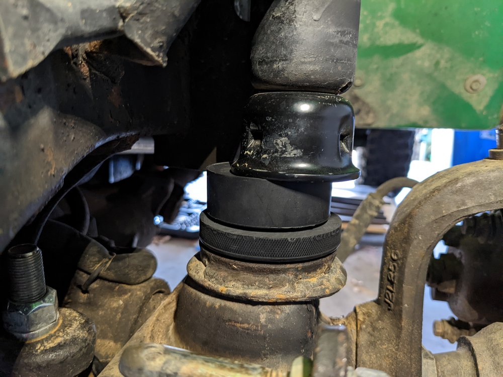

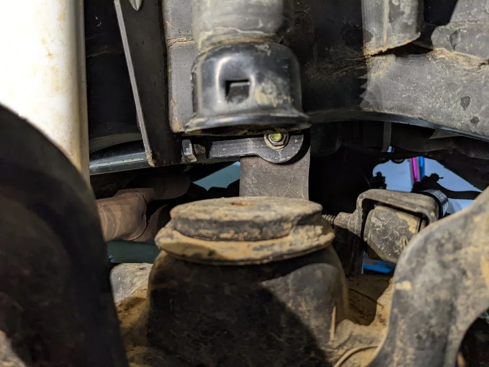

Bumps installed and set. One Rock Krawler puck plus half a hockey puck and I've still got shock shaft showing.
Looking good otherwise.
Here's the lateral offset on the drivers side.
This is full bump:
How squishy are the hockey pucks? If they squish at all then you may want to leave the 1/2” of shock shaft showing. I’ve just honestly never played with a hockey puck lol
