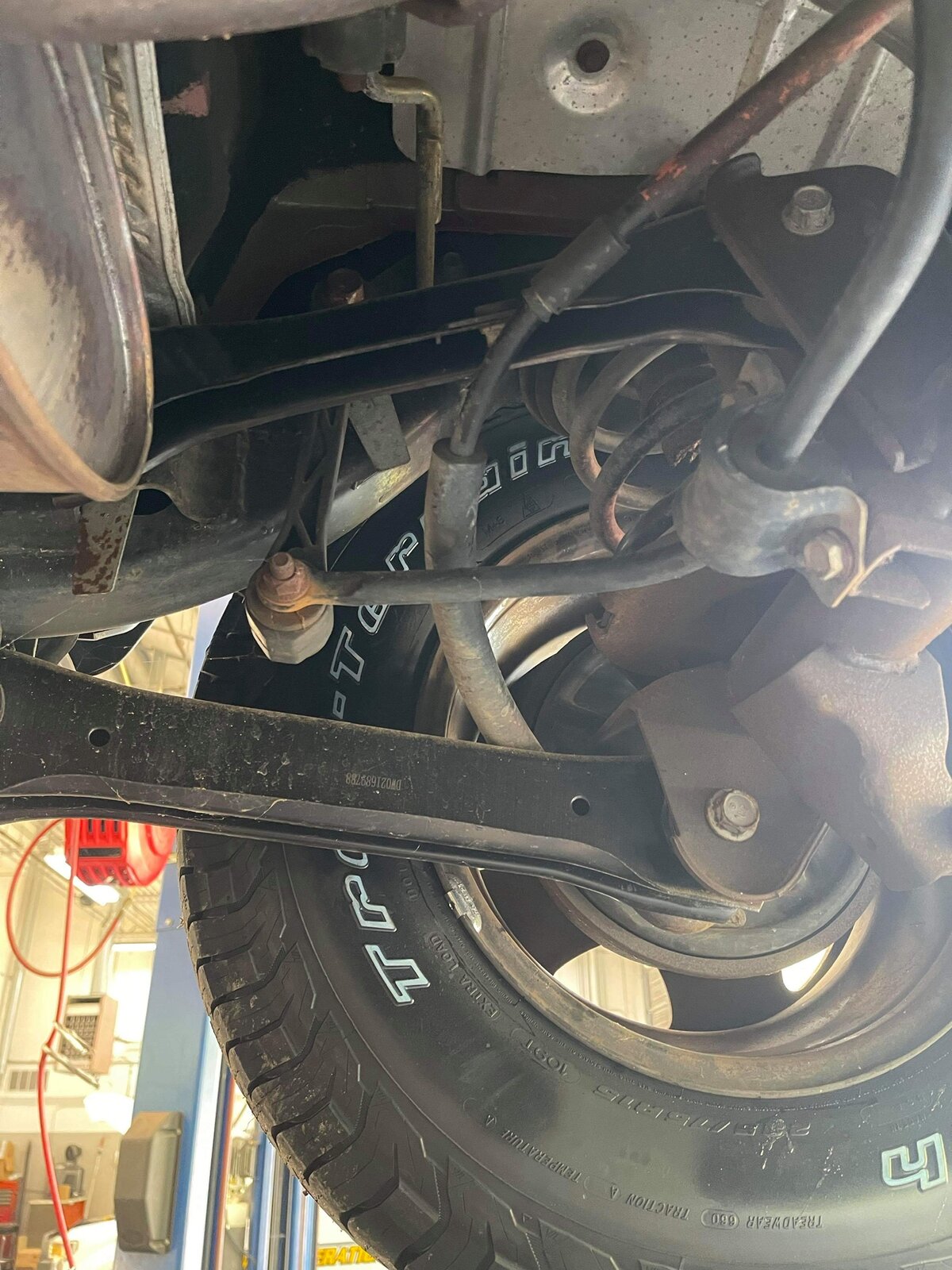

Thanks for all the tips. I’ve got a creeper and some good headlight/world lights and I’ll pickup a propane torch this weekend. I’m hoping my rust is like PRNDLS based on being in the south and what the undercarriage looked like when I got it up on the lift before purchase.
That looks a million times better than mine. Mine spent at least a few years in PA and it shows. You should be fine even without the torch.

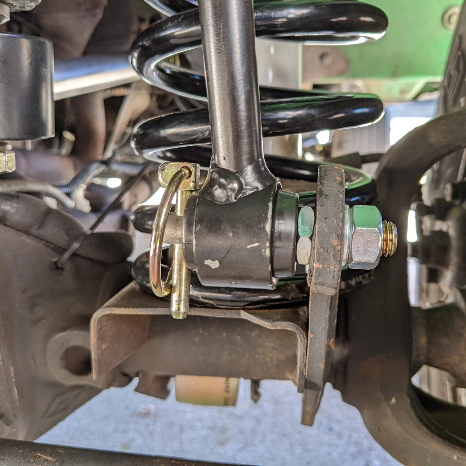

Shock math:
Compressed​
Extended​
Travel​
Up (Potential)​
Down​
Bias (Up/Down)​
Rancho RS55239 (Front)​
14.43​
23.84​
9.41​
5.25​
4.16​
56/44​
Rancho RS55241 (Rear)​
13.69​
21.69​
8​
5.75​
2.25​
72/28​
Up Potential is the exposed shock shaft length at ride height and will be limited by fender clearance/bump stops. This was measured with half a tank of fuel, soft top, full doors and no passengers.
Fronts look fine, I don't have a significant rake so I don't plan to install leveling spacers. The rears might be on the short side we shall see.

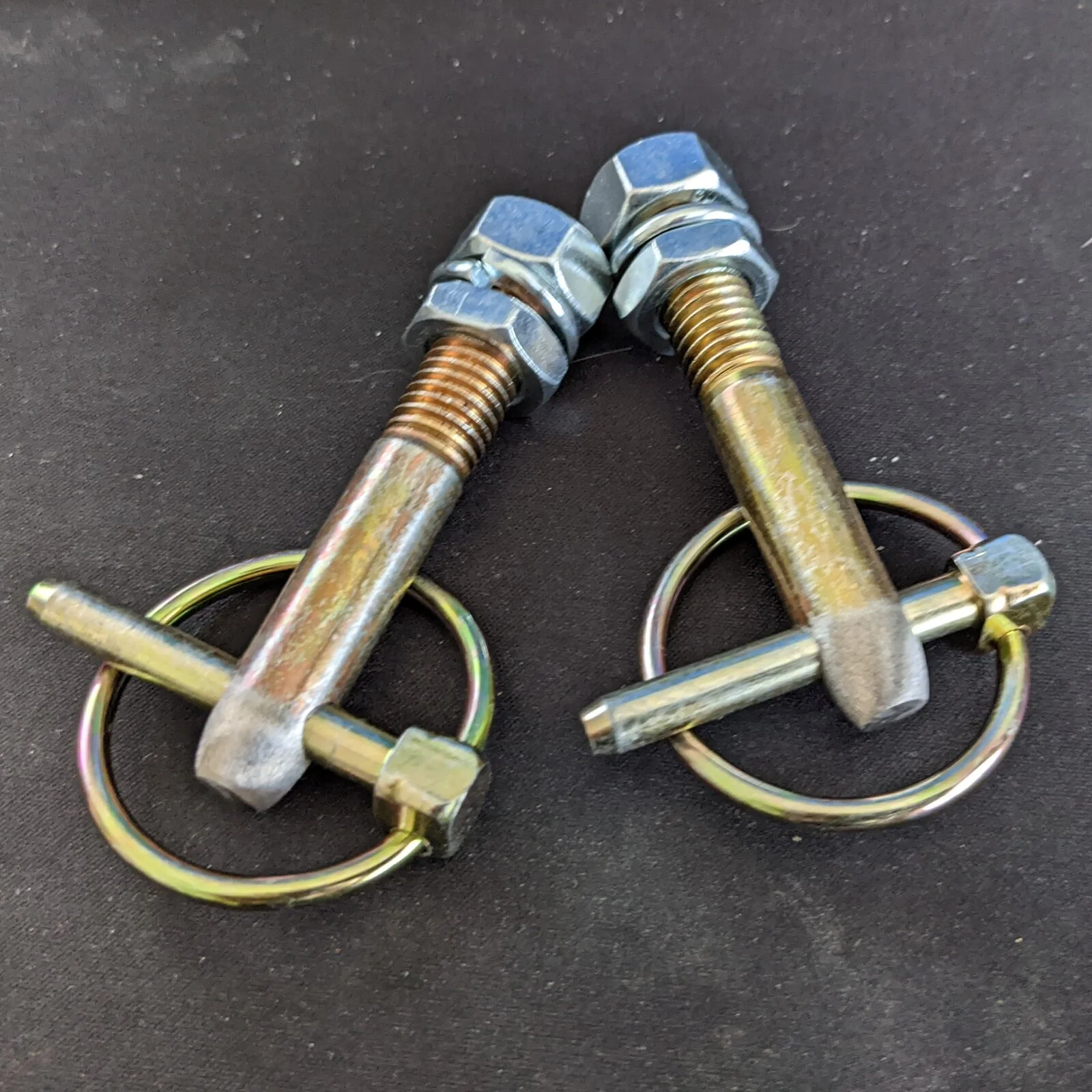

The only other thing that was not included in the body lift was a steering shaft riser bracket. It works without the bracket, but the steering shaft seal would not stay clipped into the firewall, and I had hot air blowing on my feet in the summer.
It always amuses me that some of the best products come with no instructions.
When I did a body lift I just took out the factory bracket, cut it in half and welded in a 1” piece if flat bar. Worked great.
Reactions: PRNDL
That's the exact one I bought.
I bought this one and can weld. It was just worth the time savings for me.

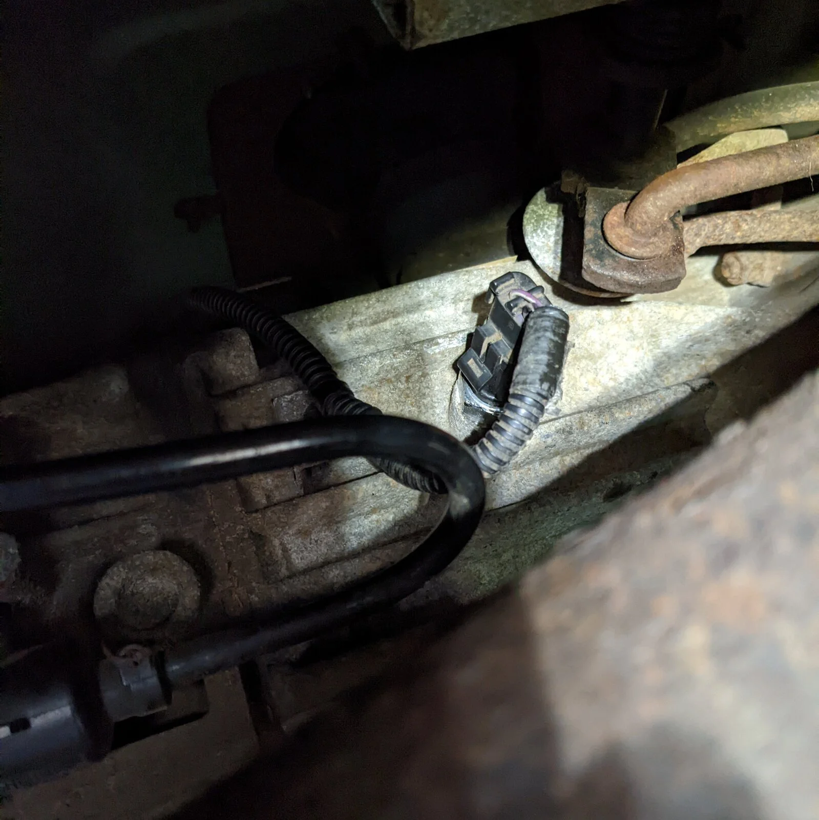

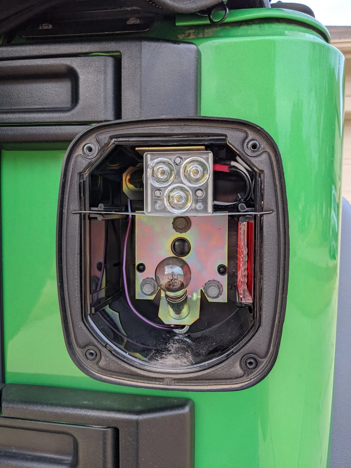

Received the LED backup lamps from @Claytone yesterday. LINK

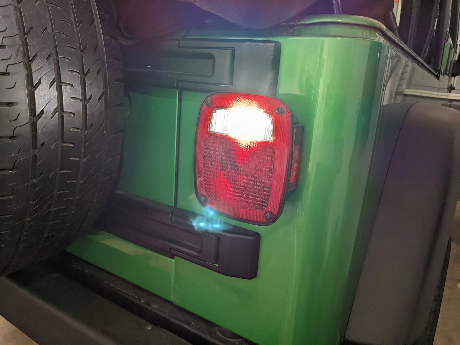

Drilled the separator plate and hooked them up in no time only to discover they weren't working. After some troubleshooting I was able to confirm my back-up lamp switch on the transmission was bad. I don't drive the Jeep much at night when I would have noticed the reverse lights, so who knows how long its been out. A quick swap with a replacement switch and they are working fine.
These lights are awesome. A really nice upgrade to the factory tail light housings.
