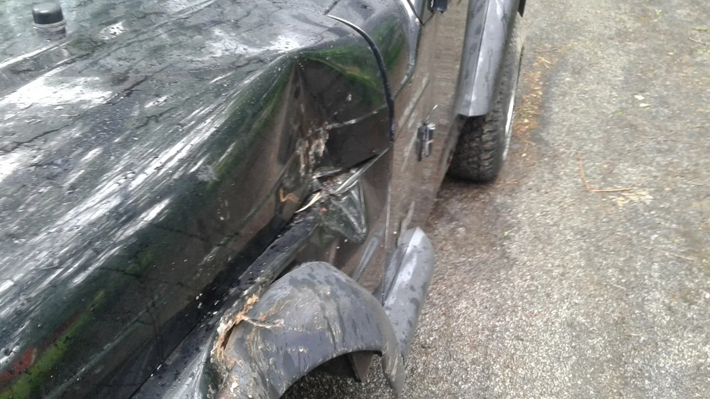

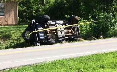

Apparently, Jackass was very unhappy about it and dumped me into a ditch 2 hours later.
(It looks MUCH worse than it actually was, It kinda sloooowly tipped, but considering the overall "evil jeep" theme of this thread, I have to over dramatize a bit...consider it a "reality TV" thread :) )

Considering the circumstances, damage was light.
That's pretty much it. I assume Jackass tried to assassinate me without really hurting himself too much. It didn't even break the mirror on the door.

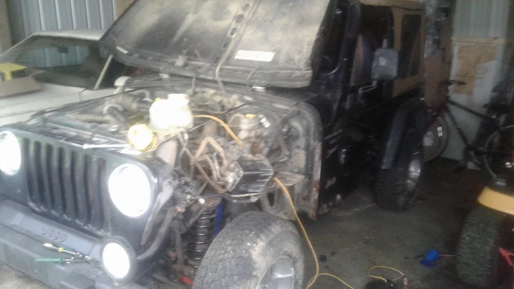

A few flames and some WD40...the fender was free!
Lots of little doo-dads to remove on the drivers side to get it loose. Lots of wire attachments, and more bolts than you'd think.
Not to mention (which nobody ever does) the flare extension attache to the door. Washer jug, horns etc.
I'd guess it took me about 3-4 hours total to get it off with just hand tools. With the damage, the 4 bolts into the fire wall were a real ***** to get to.
But this is Jackass, so a better tempered Jeep may not take as long.

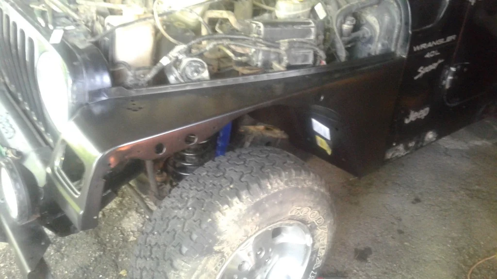

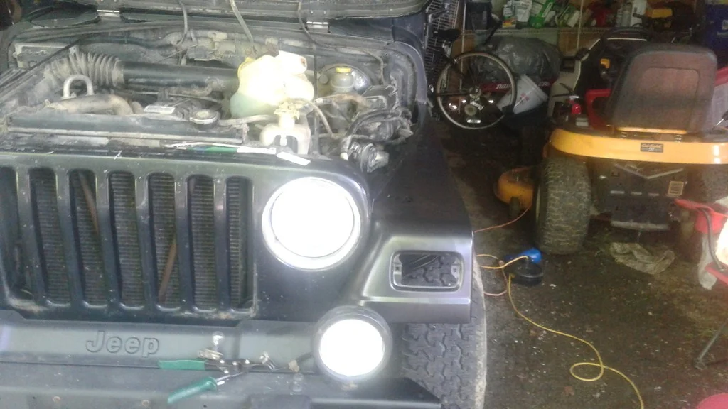

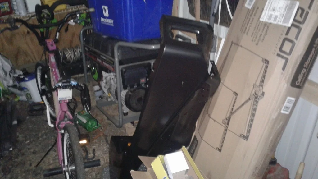

Here's the new one. I've got half the bolts in loosely, and still have to get the internals re-attached.
Not bad. Fits fairly well, however the bolt holes on the inside rear (by the labels) aren't even close. Trying to decide whether to drill and put 'em in or just fill the holes. It's really sturdy without them and I still have more to install. I'll wait and see.
It looks like all the engine bay stuff will go back in the right spots, but they're still loose 'til tomorrow.
So far it's going waaay to smoothly.

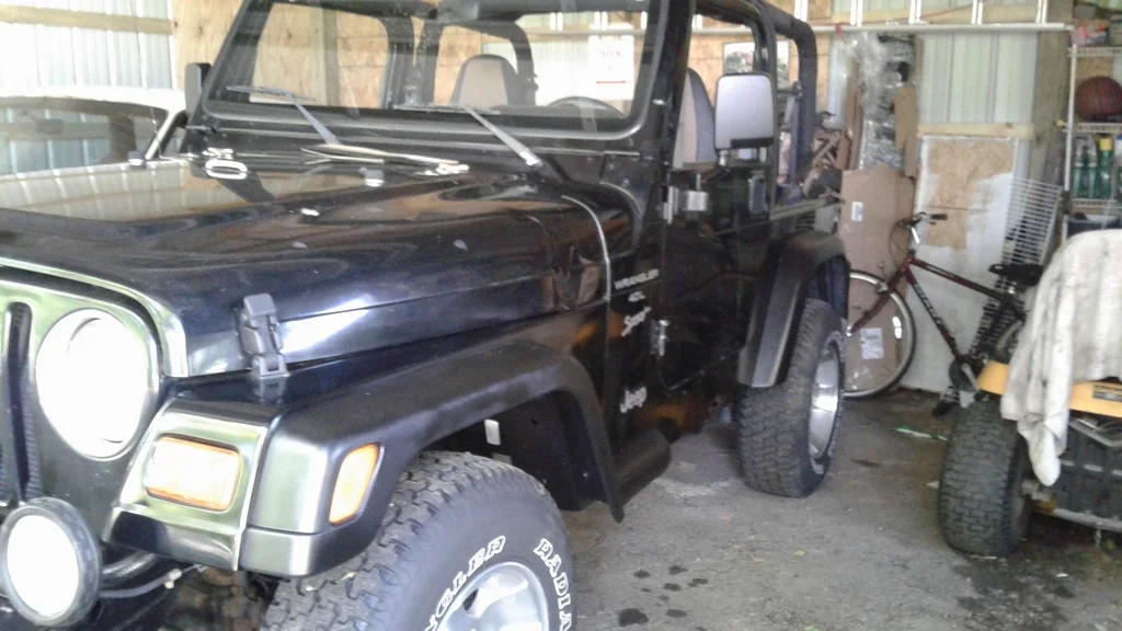

I finally finished with the fender...
Not bad. I had to drill some new holes and insert some sheet metal screws to completely mount the washer jug and horns.
Things didn't line up perfectly.
I'll try the Omix stuff next time...maybe the hood.

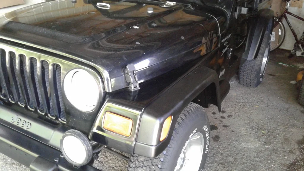

Got a new fender and door flares as well. I rattle canned the fender (Mopar PX8 black) then wet sanded and polished. Came out pretty good, but now it looks better than the rest of the Jeep. :) Since I had to replace the flare, I went ahead and hit all of them with some Krylon satin black so they'd all match. I still need to go back over them with a light scuff pad to knock down the shinier spots and even the paint out a little. It went on really well on all the flares except on the new one. Weird. Scuff pad should take care of that though.
While I was at it, I went ahead and hit the front and back bumpers with some paint, and also Kryloned some other plastic pieces since I had plenty left over.

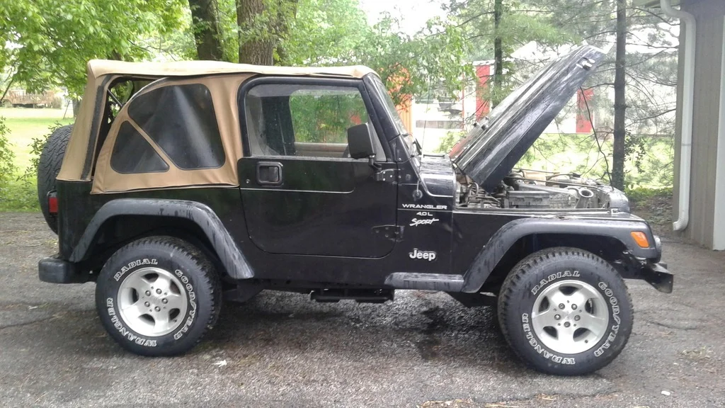

I got the hood banged out enough to close it securely. It's finally gotten above 50 degrees and stopped raining every 30 minutes, so I put the top down and took off. I ran him around for a few hours and have no near death experiences to report.
HOWEVER, since this is a cursed Jackass of a Jeep, I broke or had to cut the damn zippers on the windows to get them out. The end pieces of the zippers had corroded bad enough they wouldn't let go. The back window zipper had separated and the top had frayed so pieces of material had jammed it. I just cut 'em out.
So the top just stays down 'til I replace it.
I guess Jackass really wants to run around topless exposing himself to people. Freak.
Can you tell me what grit you used to wet sand, and what type of polish? I rattle can painted a couple of spots on my Rubicon, and the paint came out fine, but the clear coat needs a bit more shine to it to match the rest of the Jeep. I noticed your fender is pretty glossy.
I can't swear, but I think it was 1000 (coulda been 800)and I add a teeny tiny bit of dish soap to the spray bottle to help lubricate it a bit.
The polish was Meguiers scratch remover followed by ultimate using a hand buffer.
I like mothers polishes too.
I haven't waxed yet, should shine it up a little more.
The rattle can paint has a tendency to "wave" at you a little 'til you polish it ,I think because of the aerosols.
**Edit: I also swapped the nozzle off of the Mopar can. It sucked. I used the nozzle off of some duplicolor. It lays the paint out more evenly.
