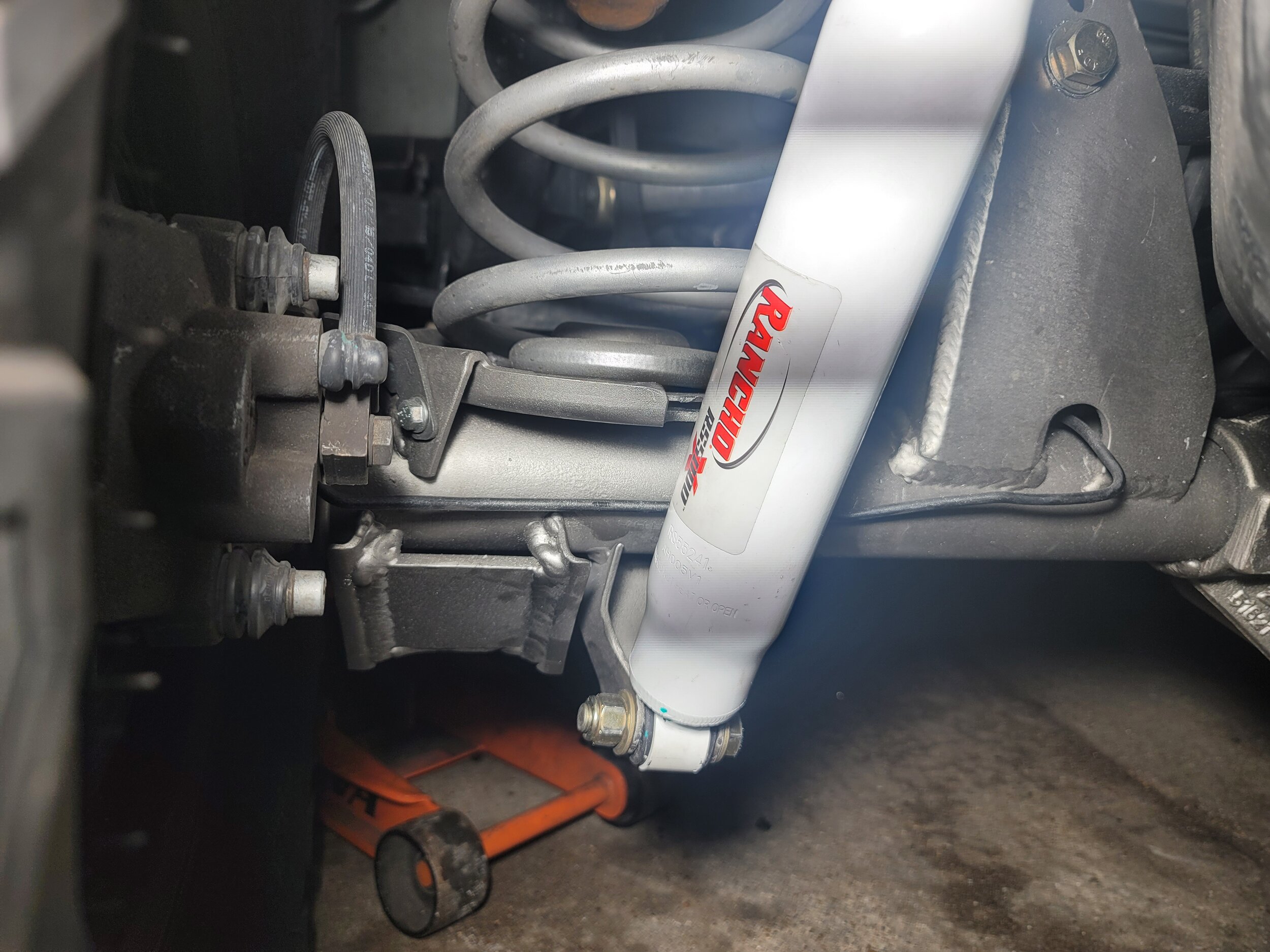

After stupidly finding out and adjusting my pinion angle a while ago due to my savvy tummy tuck,I found out that my shocks were hitting the spring perches....
Clearanced them out some and now they got space😁
Note- The jeep is at full droop in this pic,Plenty of clearance 😁
The only things that are close to the shocks is my coil springs,a good 3/16ths away
These poor shocks only got driven 8k miles...lesson learned,When doing major pinion angle changes...anything really,Check clearances. Dont be so eager&excited (thats me)

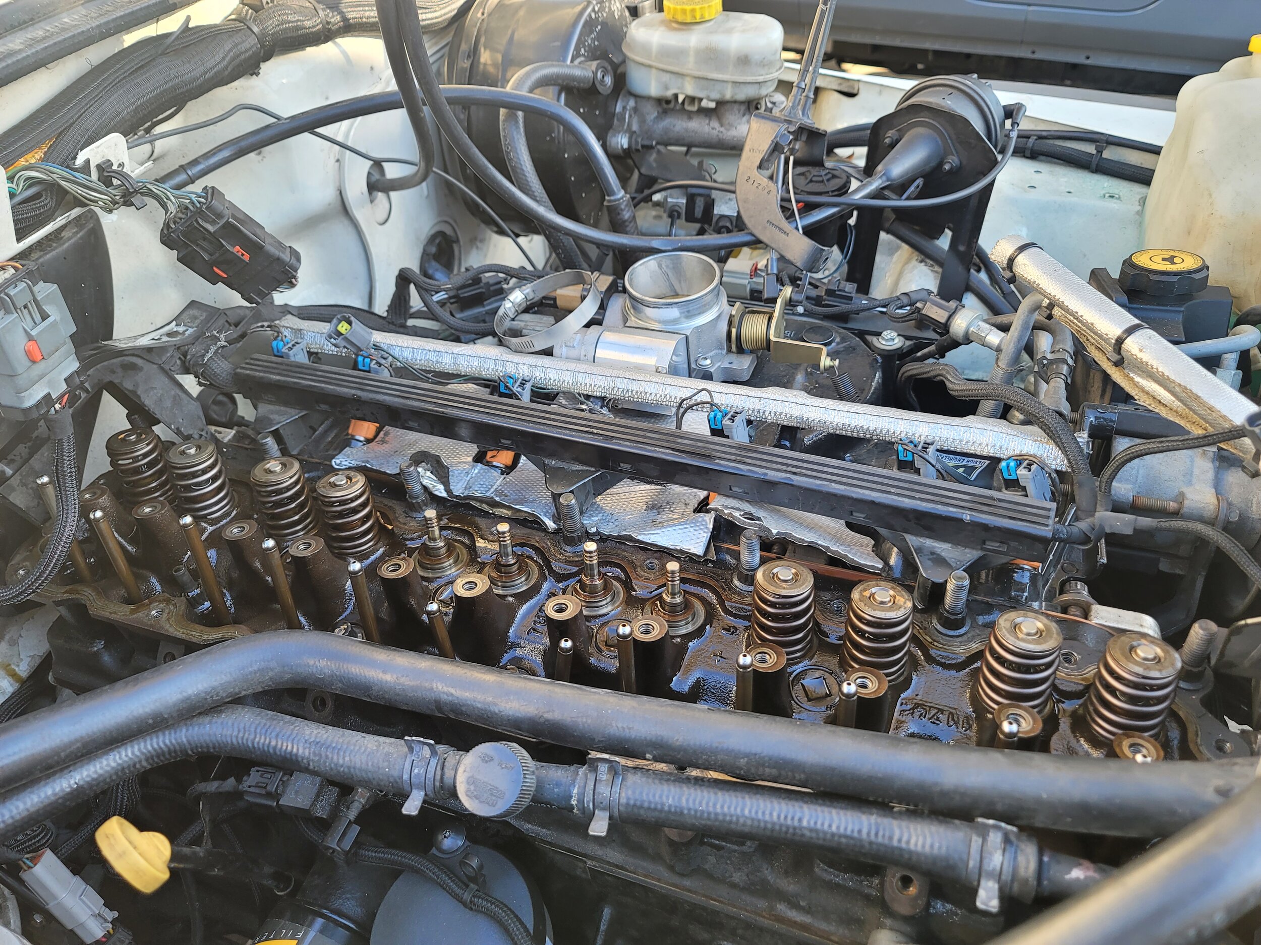

I finally got to working on the Lj on replacing its valve springs! All went well......until I got to the last frigging spring man,Tool was too tall so I'd hit the firewall
So I told myself "Alright no biggie ill cut the thing up,Weld a nut and get er. Done,This rental is now mines
So yeah cut I it up some more and long story short my jeep can finally hit 5k and be held and bang limiter now 😁
Pics from yesterday *
The P.I.T.A
But yeah she's mint now and I can actually row through some gears and not hear that flutter past 4k that just kills power (valve float) 😁

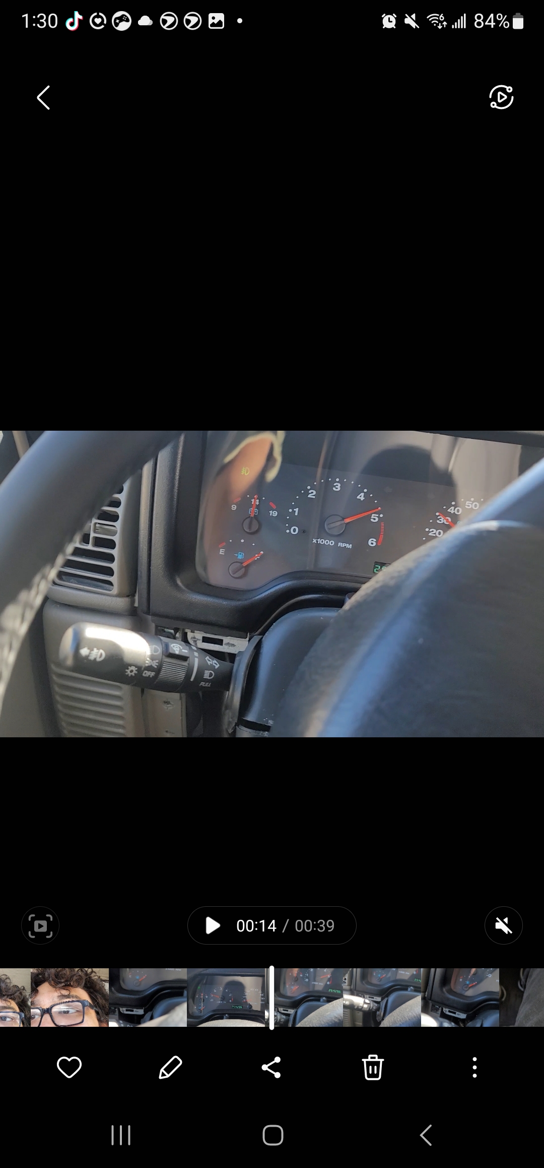

Screenshot of a video from me peeling out,It wouldn't even hold anything over 4,100k Rpm when attempting a burnout on gritty concrete Now it just goes😁
Ahhh I'm pumped to say the least !!!
