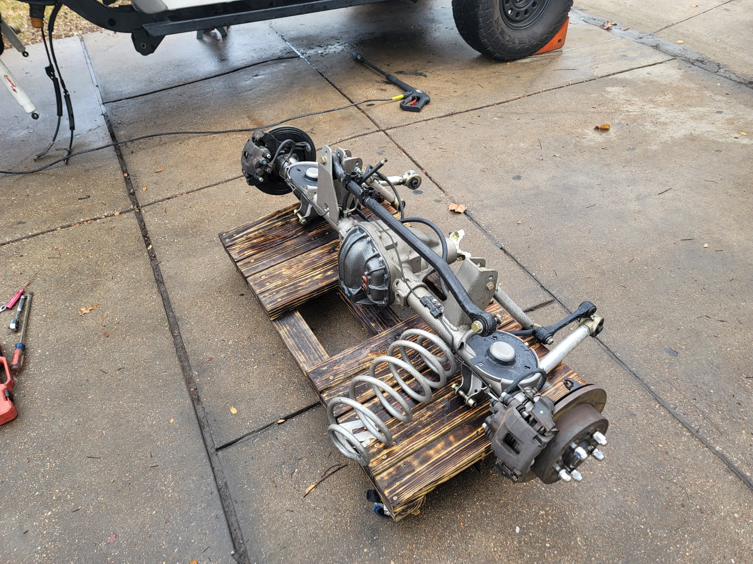

Gonna be posting my axle up for sale
Do yall think 3.3k for everything sounds reasonable once i replace just the diff? The whole axle&brakes&savvy arms,Trackbar
I was thinking of offering the option to install the locker of choice to the person that would buy my axle View attachment 661835
Any chance you confirmed the axle shafts are good? No chance the end of the shafts got twisted up? It’s hard to put on a price as the next person needs to buy a carrier, gears and maybe even shafts. They would essentially just be getting a housing, brakes, arms and a track bar. If it was me, it would have to be $1,000-$1,500 for consideration and I would still try and get you down. But that’s why I have not purchase axles yet 🤣. To cheap and waiting on a good deal.
I wouldn’t waste time installing a new diff as you never know what gears the next guy wants to run or the type of carrier.
That's why I'm gonna include a installed locker of choice for someone that wants my axle.
I'm not gonna sell the thing broken lol
Reactions: Unique Username

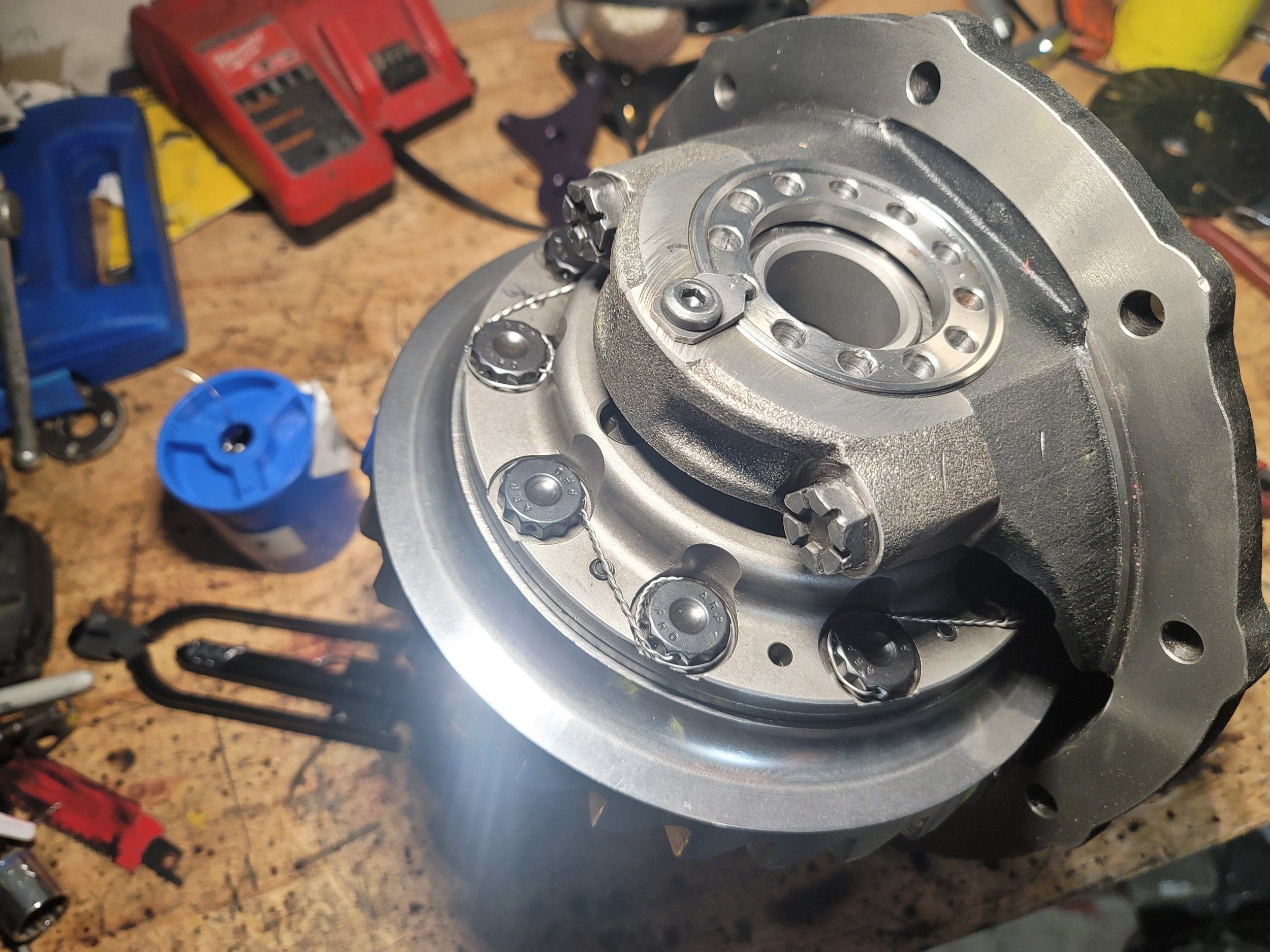

Learned how to do safety wire the other night 😁 total of 9 tries,so 10 ring gear bolts 5 sets of wires

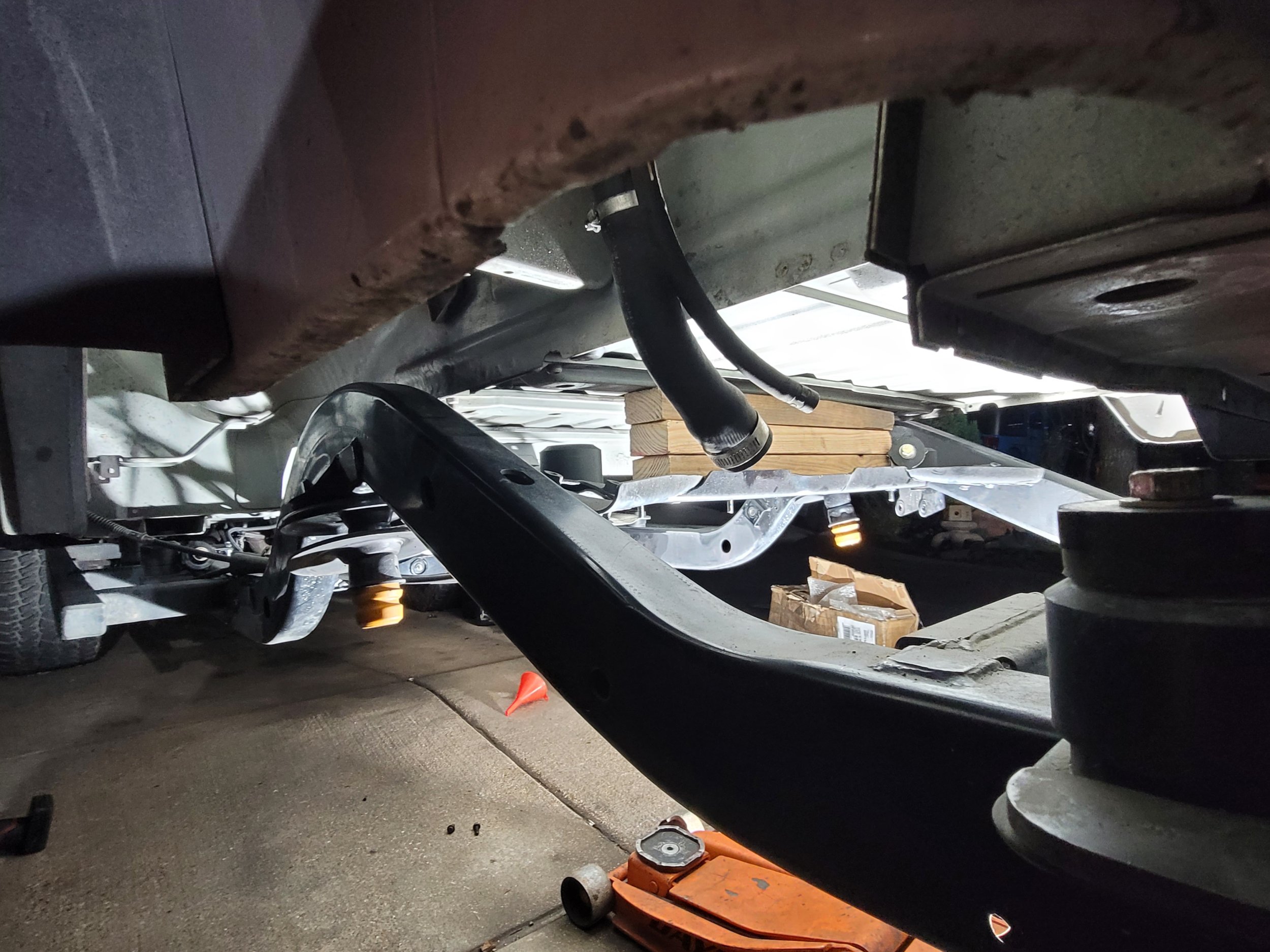

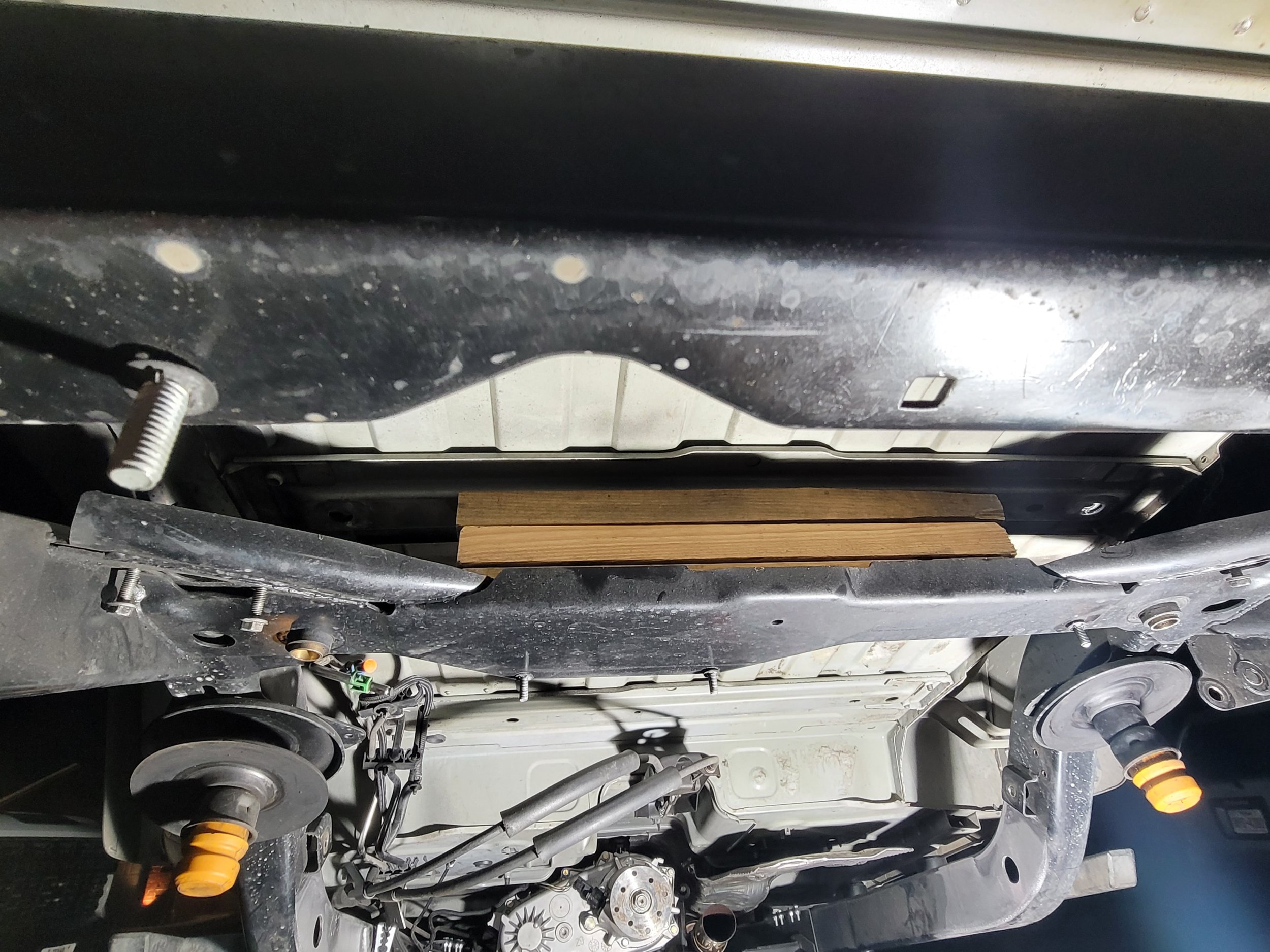

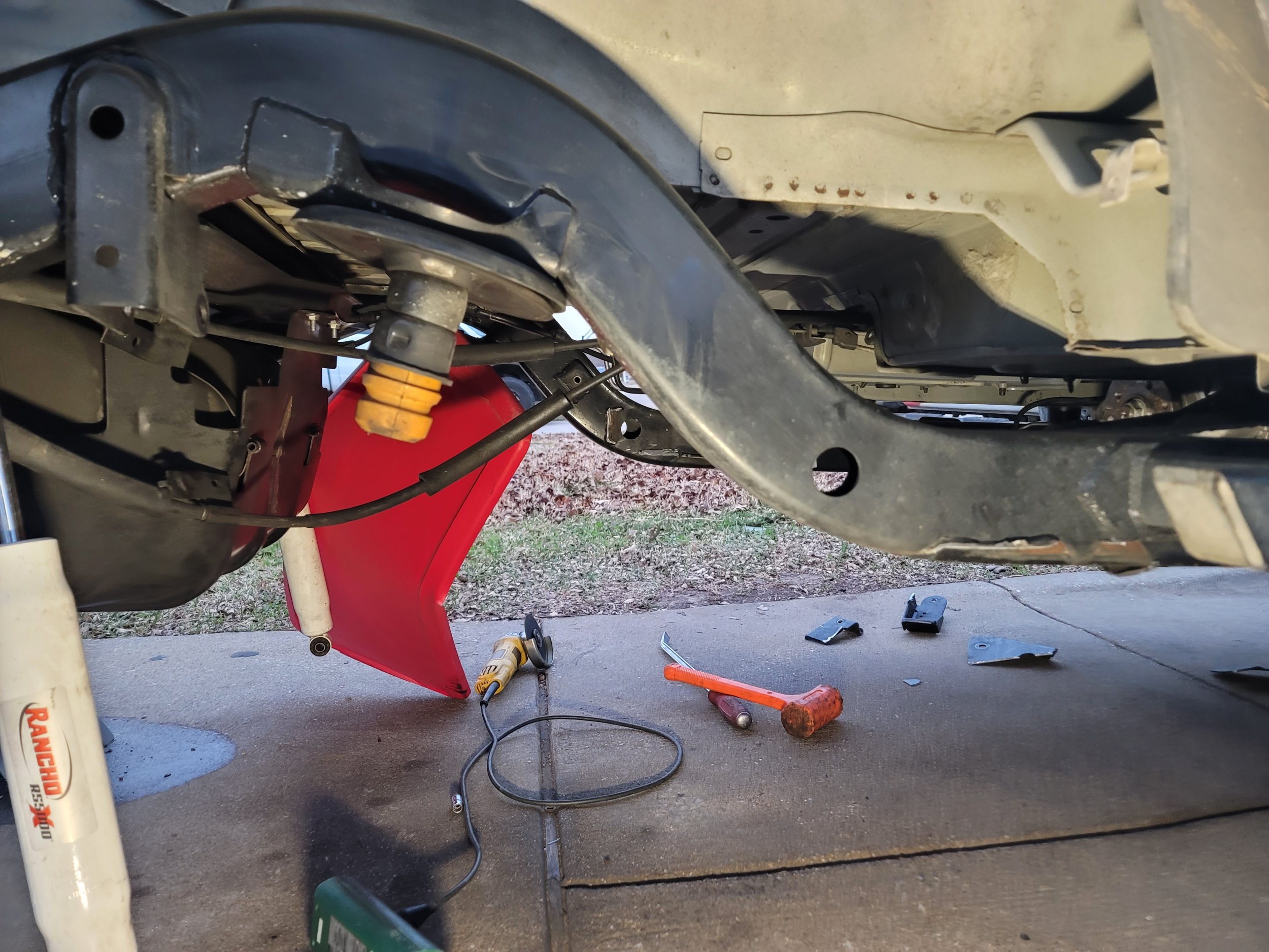

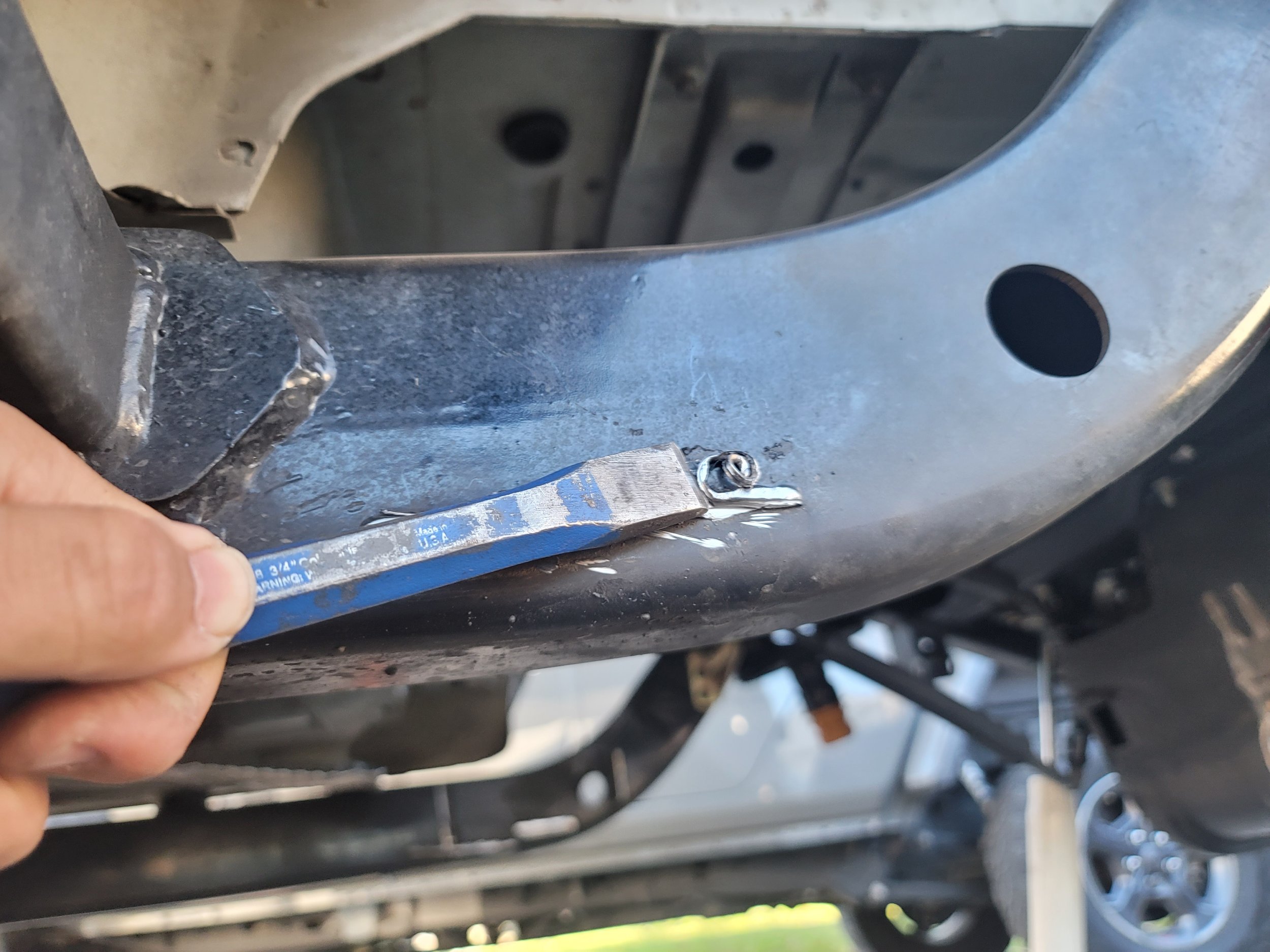

Alright yall I've made some more progress on the Lj in prep for the midarm/ford 9" swap😁
Got the control arm brackets Chopped off and the welds being ground down to the frame to where you cant tell !
What yall know bout Dat tree inch homedepoo body lift 😝.....jk it's temporary,did it to give myself space to cut the spring perches inside the frame !
Found it satisfying how the metal coiled up as I chiseled away😁
Cutting the welds off the spring perches and track bar mount,And good lord did this side take quite a while to grind flat man...
The driver side I got done super quick,Matter fact I was was listening to "Shine bright crazy diamond parts 1-7" by Pinkfloyd and it was still playing heck I got done priming the frame before the song got done playing lol😆
I will say the frame isn't truly flat,But on the pass. Side it's flatter since I was blending that side for over an hour trying to get the welds flat to the frame!
not too pround on the passenger side as i added a nick with the grinder wheel where the trackbar mount used to be😕 but hey the rest came out damn good ! And it's not even that deep&long I just quickly weld it up grind it and it'll get covered up by the new spring perch relocation brackets so not too bad 😁!!!
Bottom center of the pic you can see the new spring perch bracket I'm gonna use ⬇️
But yeah I feel like got alot done today 🙂 Temporarily Primed the frame with some weldable primer since it looks like it's gonna rain and I certainly don't want flashrust ! So there is some runs (you can see them) but that'll all get sanded down again so I aint trippin on that😁🤙🏼

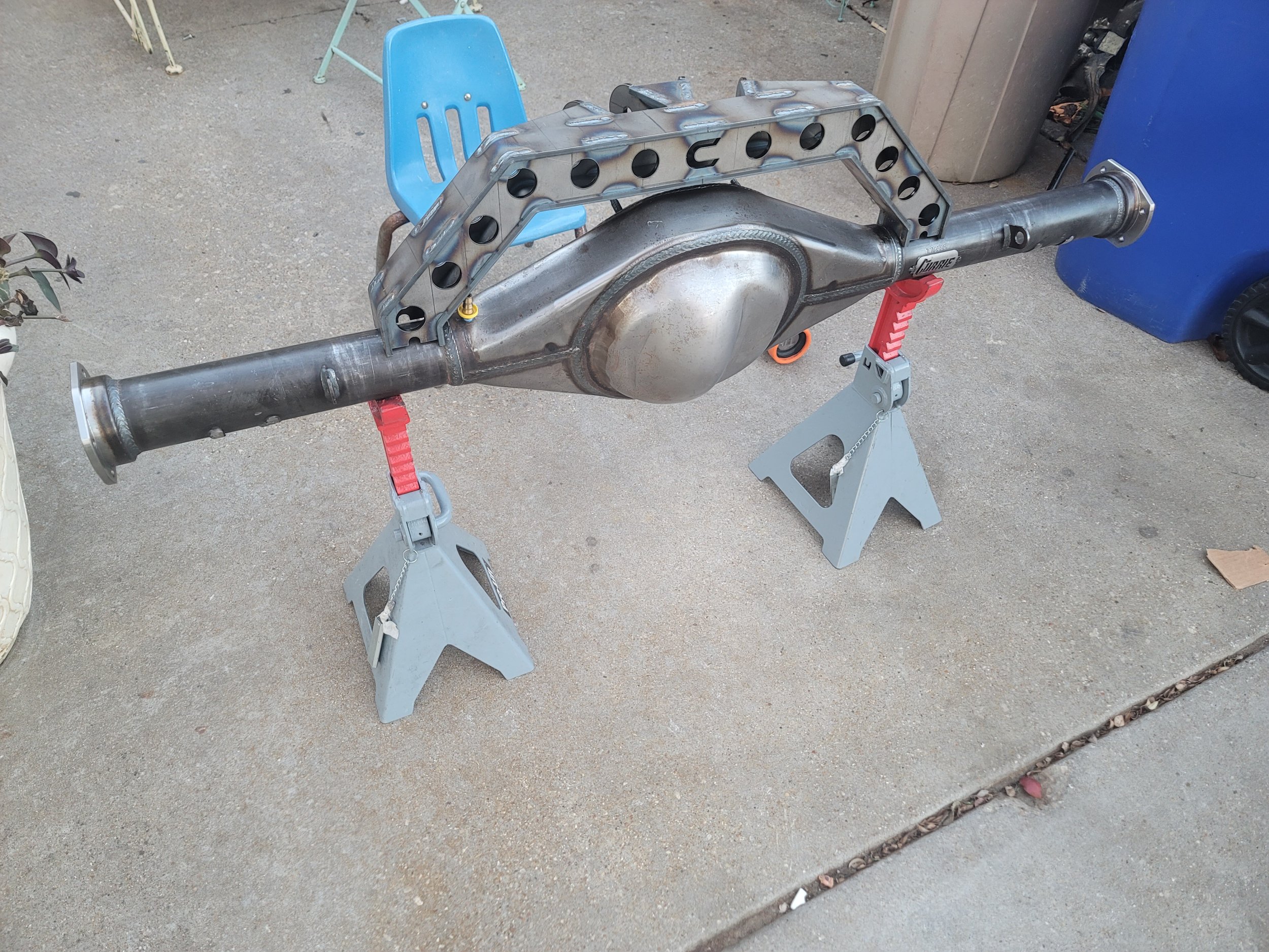

I've not heard of many people putting a 9" under a TJ/LJ before. Other than the obvious strength advantage launching it with 33's, what are the pros/cons over a Dana 44?
From what I'm seeing/dealing with
Pros
My was Lj equipped with it
It's a "stout axle"when you crawl with big tires&no launches
Cons
It's heavier
Weak when launching,Been through 3 gearsets and a Eaton trutrac (it grenaded itself)
Small tubes even tho the walls are thicker
Pros of the ford 9", 3" tubes with a 3/16ths wall (with my current currie housing),lighter housing,double shear pinion,easy as heck to setup,very very modular and I love it!
But yeah I really haven't seen people move to a ford 9" coming from a Dana44 but I already had a currie ford 9"&3rd member and a wilwood brake kit I was gonna utilize on my C10 (but that aint going anywhere anytime soon) So I'm putting it to use on my Lj 😁
Also Look at the size difference on the pinions too! Ford 9" on the left,Dana 44 on the right
I'd greatly benefit from the stronger&bigger pinion from the ford 9" since I kept murdering pinions on the Dana 44 even on numerically lower gearsets

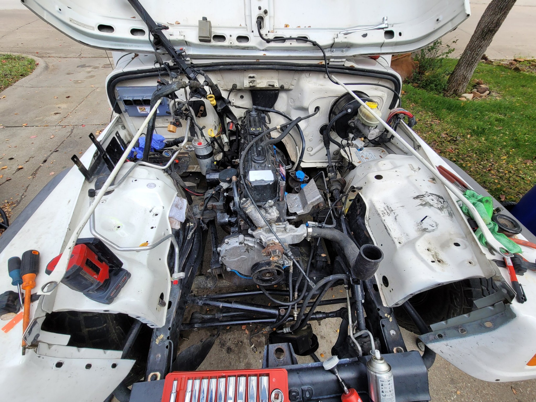

Throwback to December 24th of 2023:
Back when a simple Harmonic balancer change turned into me relooming my jeep,doing a cam swap...then me doing a head with LS valve train cause why not since the head was already off (it destroyed port velocity tho)....to then me saying "well since I'm here I might as well" paint the frame rails.....then the fenders...firewall engine and other bits and pieces on the engine 🤣 So yeah, Then Mr.NashvilleTj said I should name my jeep "Snowball " because of how one thing snowballed into a whole project lol
So as a reminder,That's why this thread is called "Project Snowball"
40k miles later and it has aged to say the least.
I will say I do miss the dual cast manifolds! The 6to1 header from American Racing Headers makes it sound less like a v8 and more like the 6 cylinder that it is lol😆 But the power i got from the 6to1 header is nice 😁
