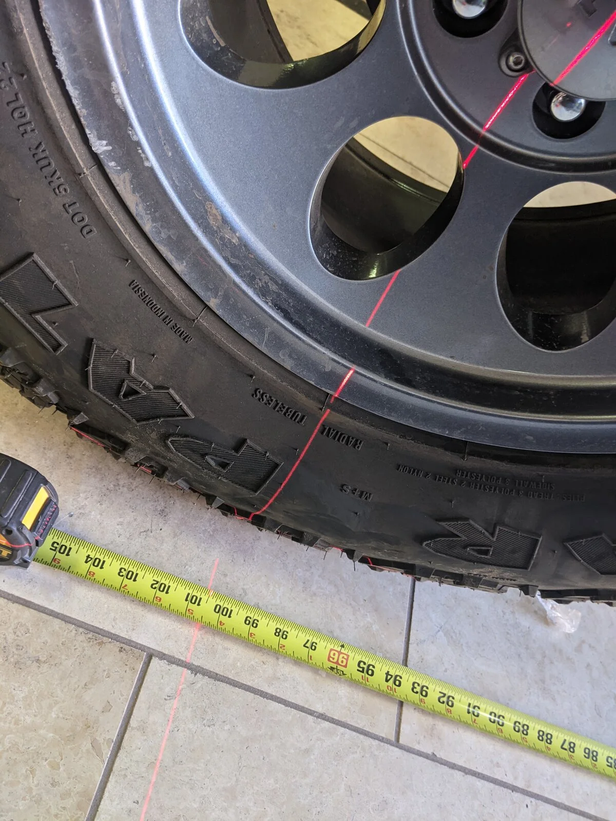

Using a laser to find the center of each wheel, I'm at 100.5" before messing with the front. What's my goal? As long as possible*
* Without going full hydro
You gotta come wheel with us down in the valley when you’re done!
