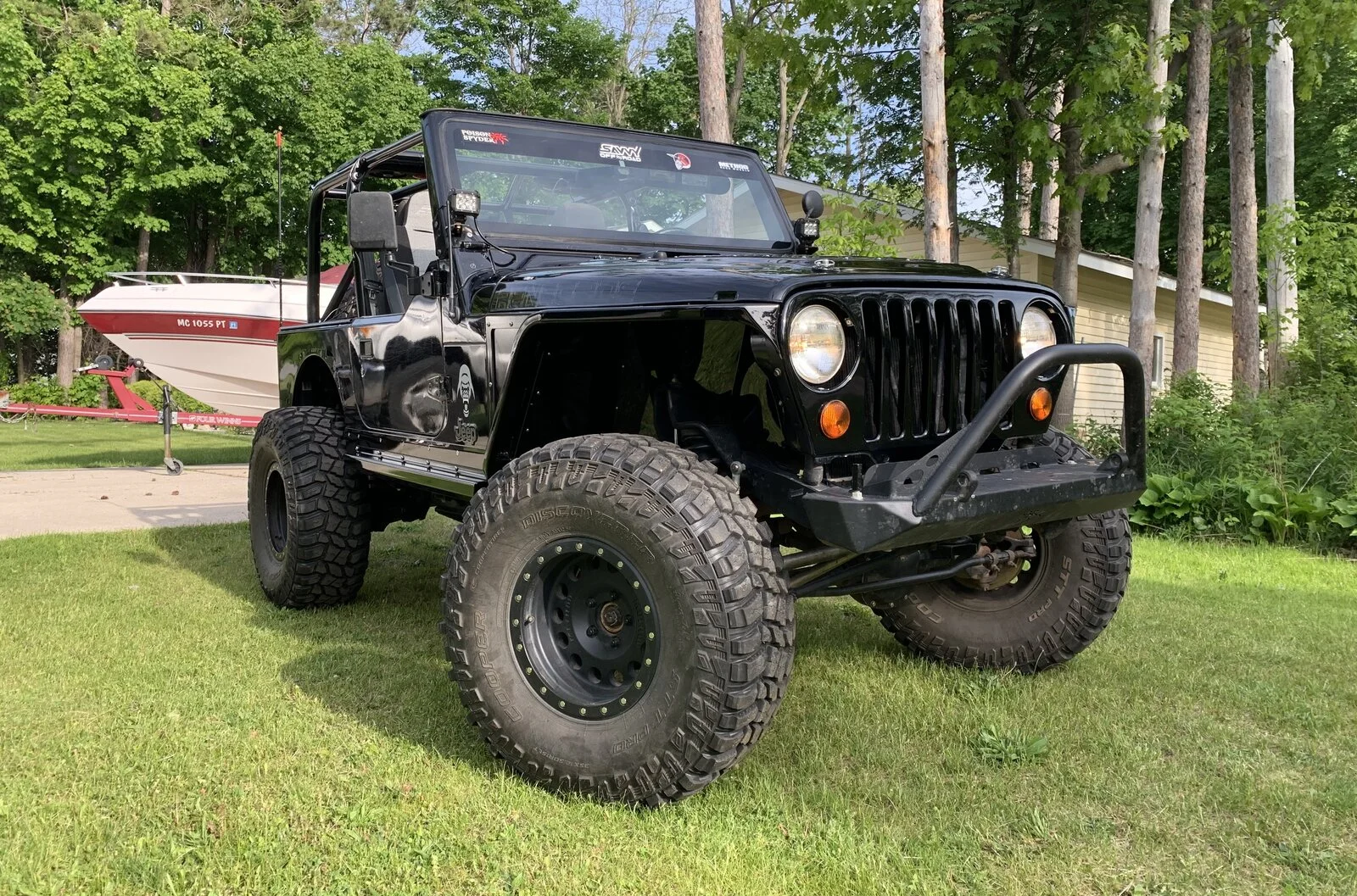

I just recently installed PS highlines. I would have preferred aluminum, but they no longer make them so I went with the steel.
It was more time consuming then I thought it would be. Cut hood, new blinkers, relocate fuse box, horn, wiper fluid. I test fit everything, then disassembled and painted everything.
I did buy a windstar air box, but I was able to still use the factory air box, so I kept that.
What Size Tire and lift is that, that looks awesome!!
I was looking, but couldn't find it, does PS offer their high line with a 6" flare? PA laws suck!! I've always liked the Metalcloak, but I understand there's no performance benefits
I run the same fenders and used a windstar but would love to return to stock. Would you upload pics of how you mounted the stock intake.
