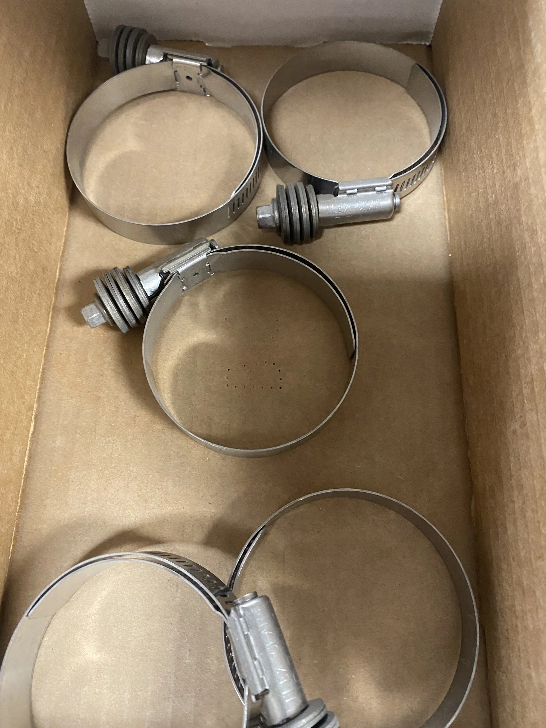

Or try some Ideal constant tension clamps.
I tried some of those after worm clamps started leaking with seasonal temp changes. Unfortunately for me, those leaked too. Maybe slightly less, but still leaked. I was surprised.
After going back to the OEM clamps, I’ve not leaked since 2019.
Interesting. These are a staple in the trucking industry and have not had any issues using them.
I really was surprised they didn't work. I paid a lot of money for a bunch of appropriately sized ones at NAPA. :(

Factory spring clamps are the way to go. I would probably stick with regular rubber rad hoses. Silicone can handle very high temps but they are soft and springs clamps really dig into the hoses over time. If you can't find the spring clamps, then the Breeze/Ideal clamps with the belleville washers will work fine. We used them at Kenworth all the time.
