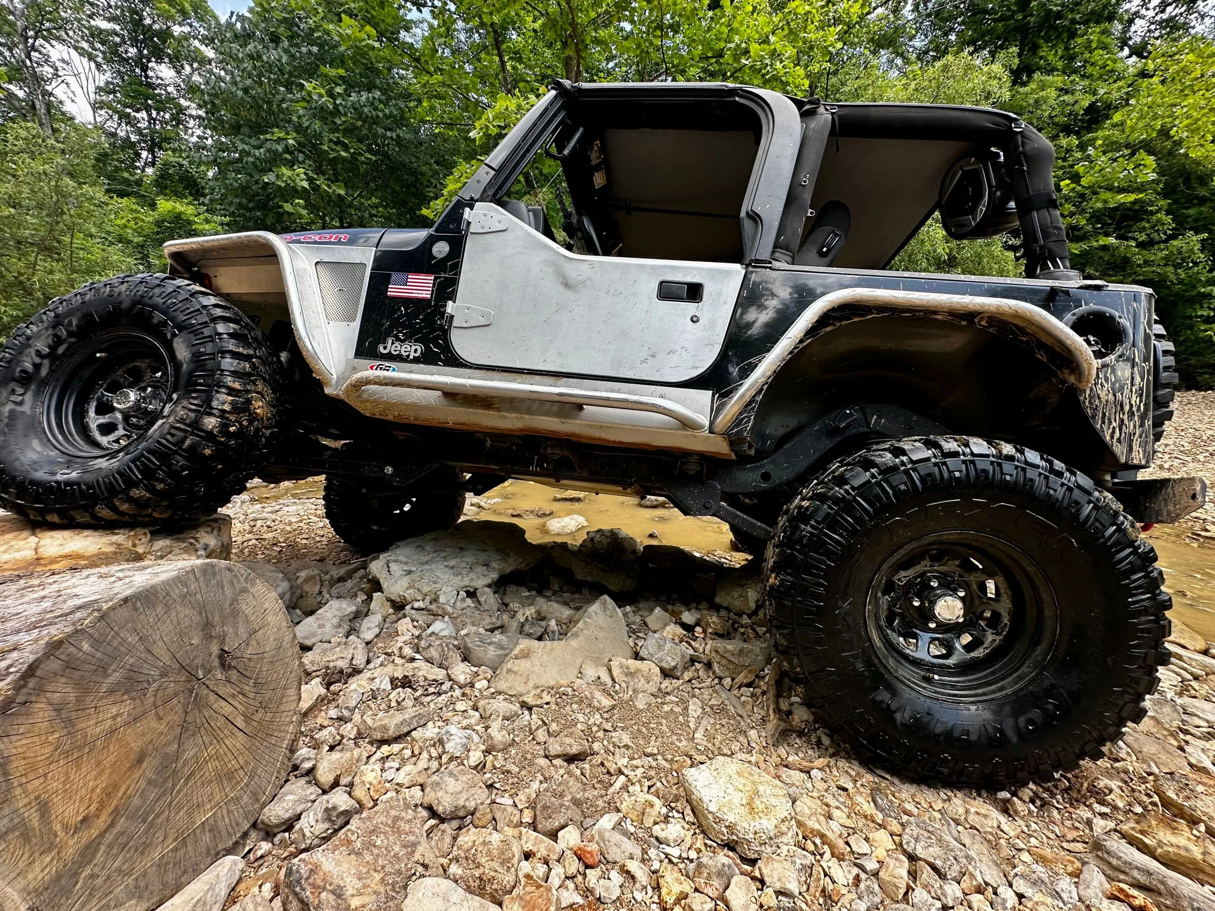

Eyyyup... 5000X for the win, and I rough sanded and then painted them before installing... saw too many reports about how fast they rust. MIne have been on for several years, thousands of miles across country to wheel hard and have held up great.
I was trying to find a pic that shows them... only thing I have on short notice.
