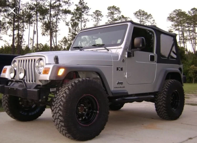

That thing has about 3" until it contacts the flare. So with a BB it would need probably close to 4" of extension to avoid contact. You are more likely to do some serious damage just driving down the road and not seeing a dip/bump/pothole than while crawling off road at ultra low speed. Many do not seem to understand that part of the equation.
Mine would have more clearance than that Jeep too, so I would probably have 5-6” between the tire and flare.

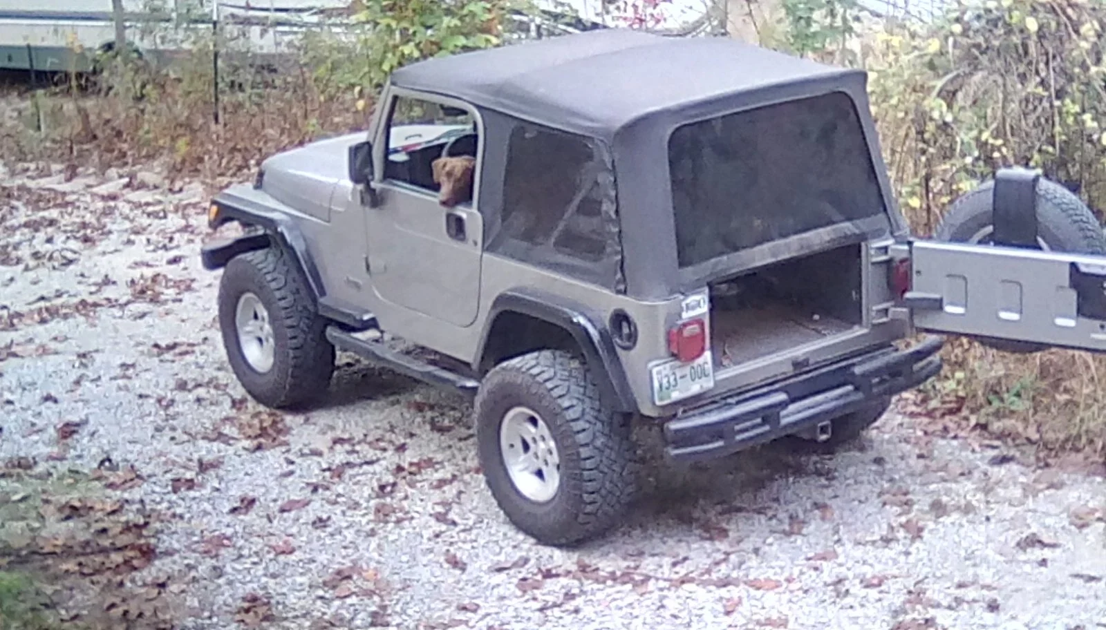

Well obviously my first point of interference would be the tire with the fender/flare, so I’ll see what I can do. Right now I’m on the stock 30s and I’ll most likely be fine. I’m definitely going 33s though. I don’t like a huge fender gap. A 4inch lift and 33s is too much space for me, but if your an avid off-roader that is what you NEED. I don’t plan on going to Moab or the Rubicon trail. Just some forrest service roads. I understand about the potholes and speed bumps. I could just flex on a rock and let it come into contact with the fender and then see how much bump I need. I would rather do that than deal with taking out and putting the springs back in. Think I’m crazy, but I don’t have this kind of time. I don’t have a garage, so I have 2 hrs a night to work on it. I want to run 3.75-4”s of BS.
