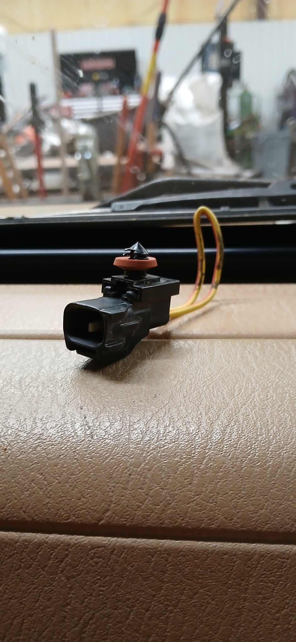

Recently this fell out from under the dash…we have no idea where it goes or if it’s important or if it’s there for an option this Jeep doesn’t have. Any thoughts? Looks like a jumper loop. Yellow with Red strip, 2 pin plug. I’m guessing it is a body mounted plug with that push connector on it.
