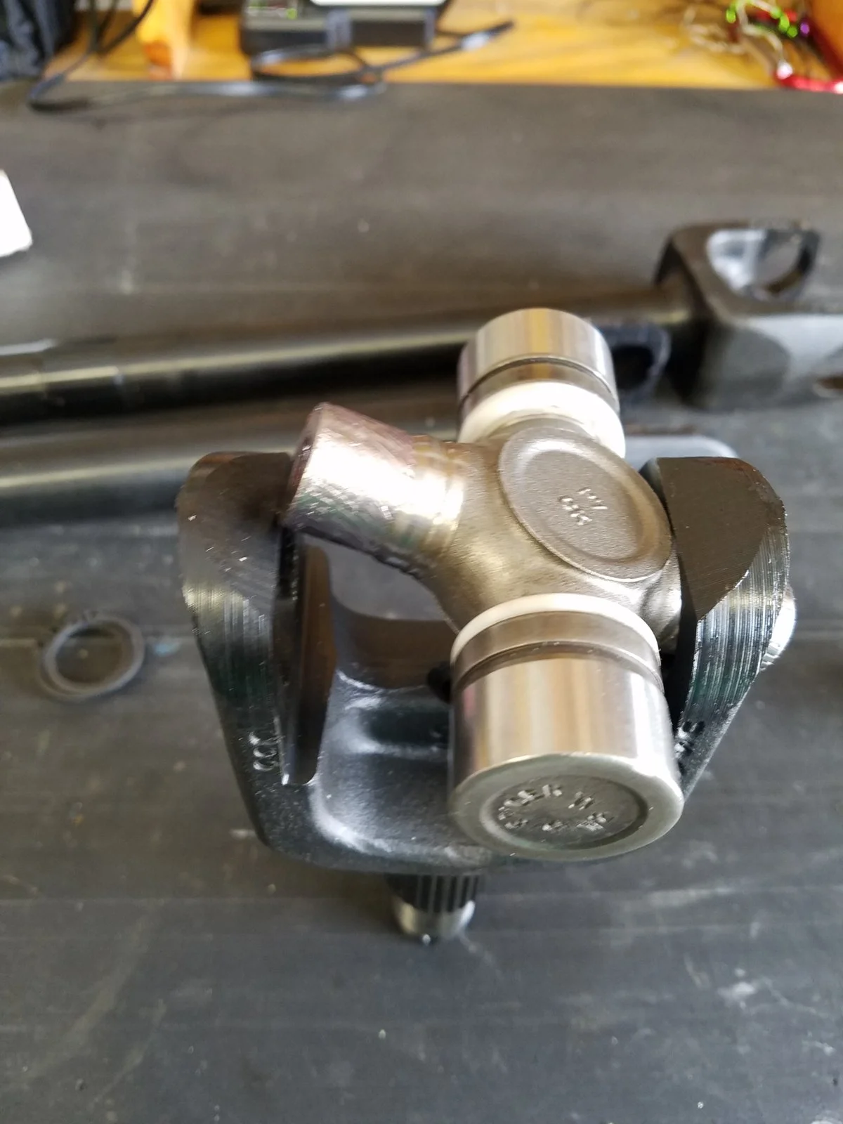

I resently upgrade my front axles. (also upgraded rear but that's not what this is about) My choice came down to RCVs vs Revoltion American made axles. I felt the RCVs were all around better but are a little overkill for a tj rubi with stock drivetrain. Heck even the Revolution Axles are probably overkill for what I will use them for but you can't put a price on piece of mind. I ended up going with the Revolution because of "trail maintainability". Although nothing should ever go wrong with RCVs, if there is an issue the ball joints need to be popped and the spindle has to be removed to remove the axle shaft. Even though the Revolution U-joints and ears are larger than stock they still fit through the hub bearing whole just like the stock axles. On a side note I stuck with 27spline outers because the hubs can be found at any auto parts store and I can use my stock axles as trail spares if I get in a "tight spot". Not to say these are the best reasons for making my decision, but they are my best reasons....
My revolutions did take a little Dremel creativity to get the u-joints in the shafts and allow the shafts to turn without hitting the flanges on the unit bearing flange bolts. This just proves to me that revolution made the shafts as beefy as they could and still fit. Don't let this deter you, if you have enough mechanical ability to put together and change a front axle shaft you'll figure out how to make these fit.
The picture was before I notched out the outside of the joint hole so the ujoint would drop down further. (this was approved and recommend by Revolution)
