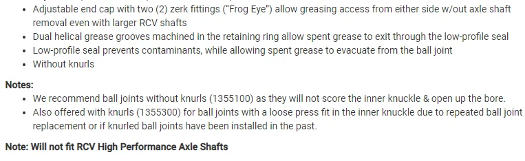

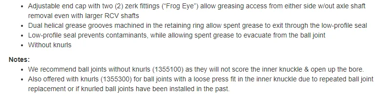

they were originally advertised as RCV compatible, however recently they have stated that the TJ teraflex HD balljoints are not compatible with RCV shafts.
you can even see this contradiction on quadratecs page for them.
my question for anyone running RCV axles is, what ball joints do you have?
and is anyone running Teraflex balljoints with RCV shafts.
