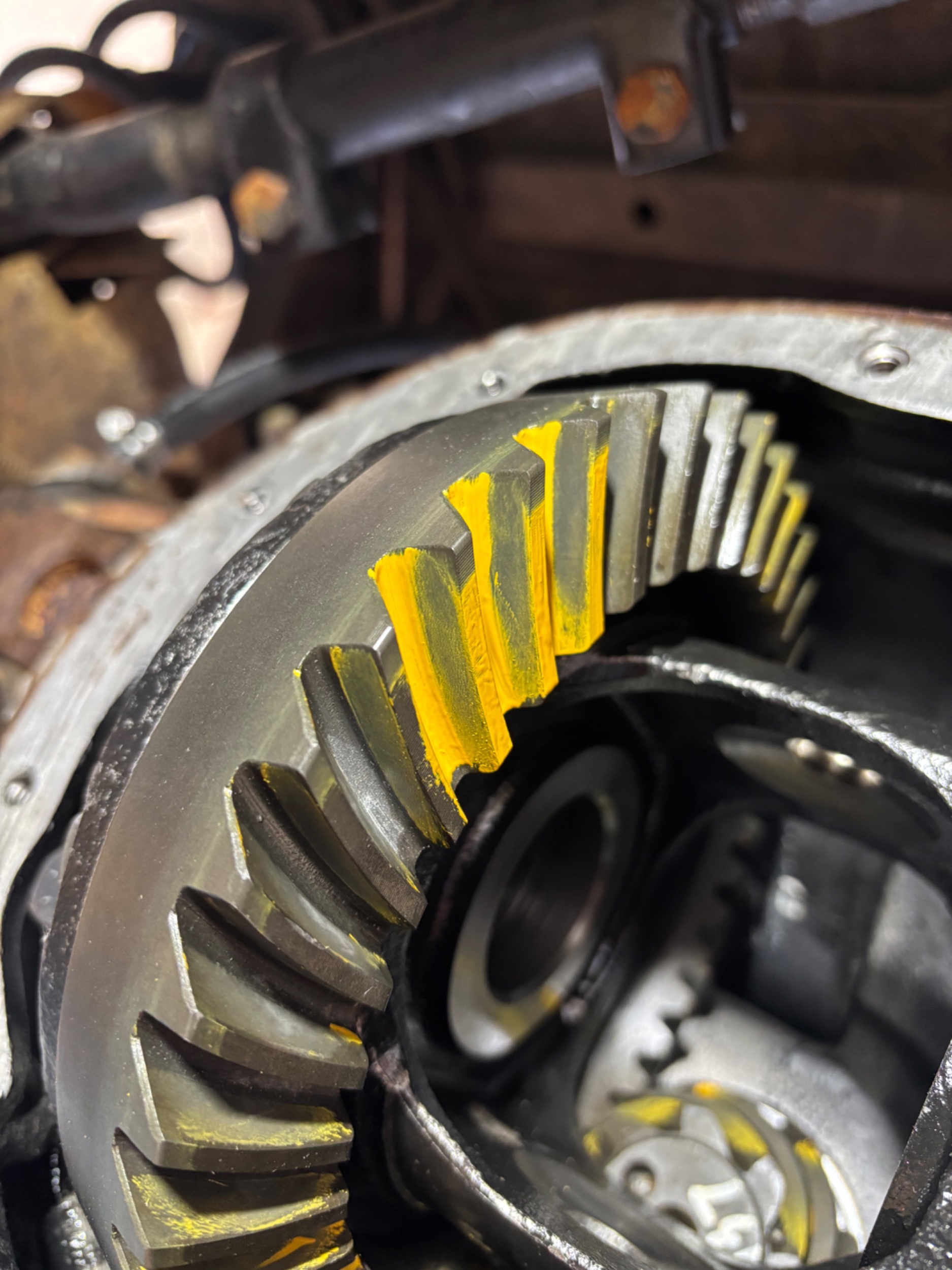

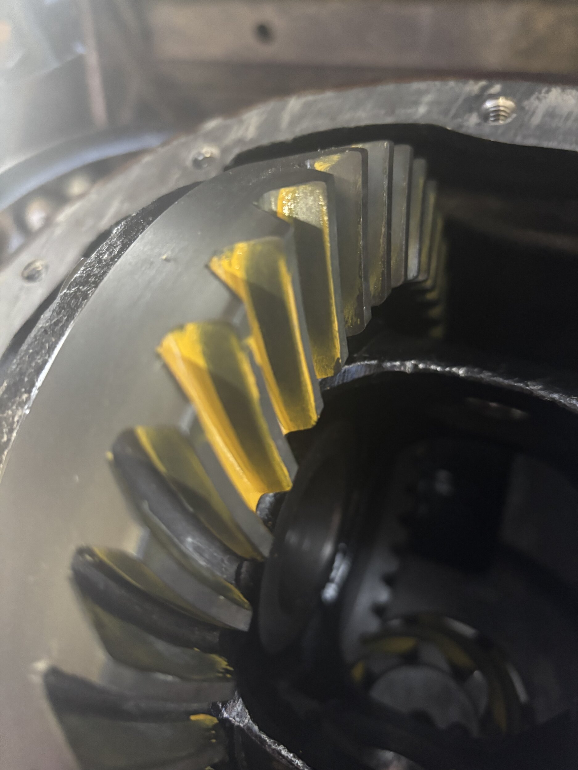

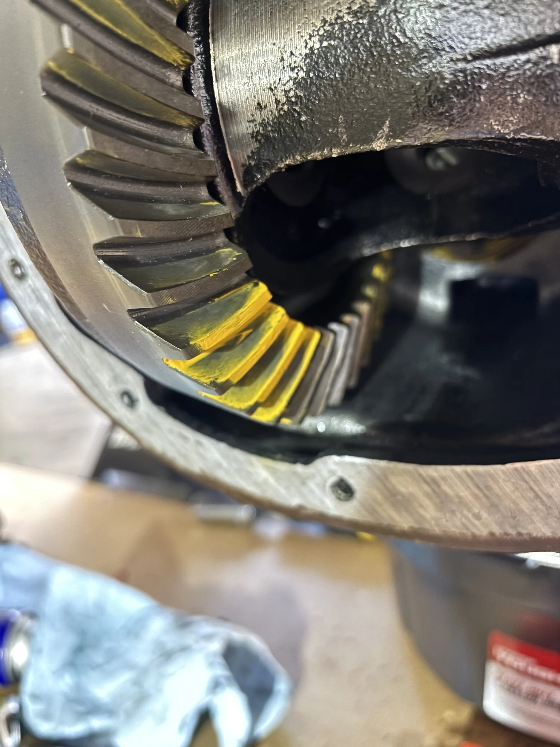

In the process of regearing my Dana 35 from 4.10 to 4.88 with Yukon gears . Backlash is 0.008. Pinion depth is .046. How do these patterns look?

I like the third picture. The first one is at a weird blurry angle. I think you're there but want to verify the coast side pattern. Can you run a cleaner pattern on that side and post up a pic?

Thank you! My helper had to leave so went with it and that was the only pic I took of coast side
