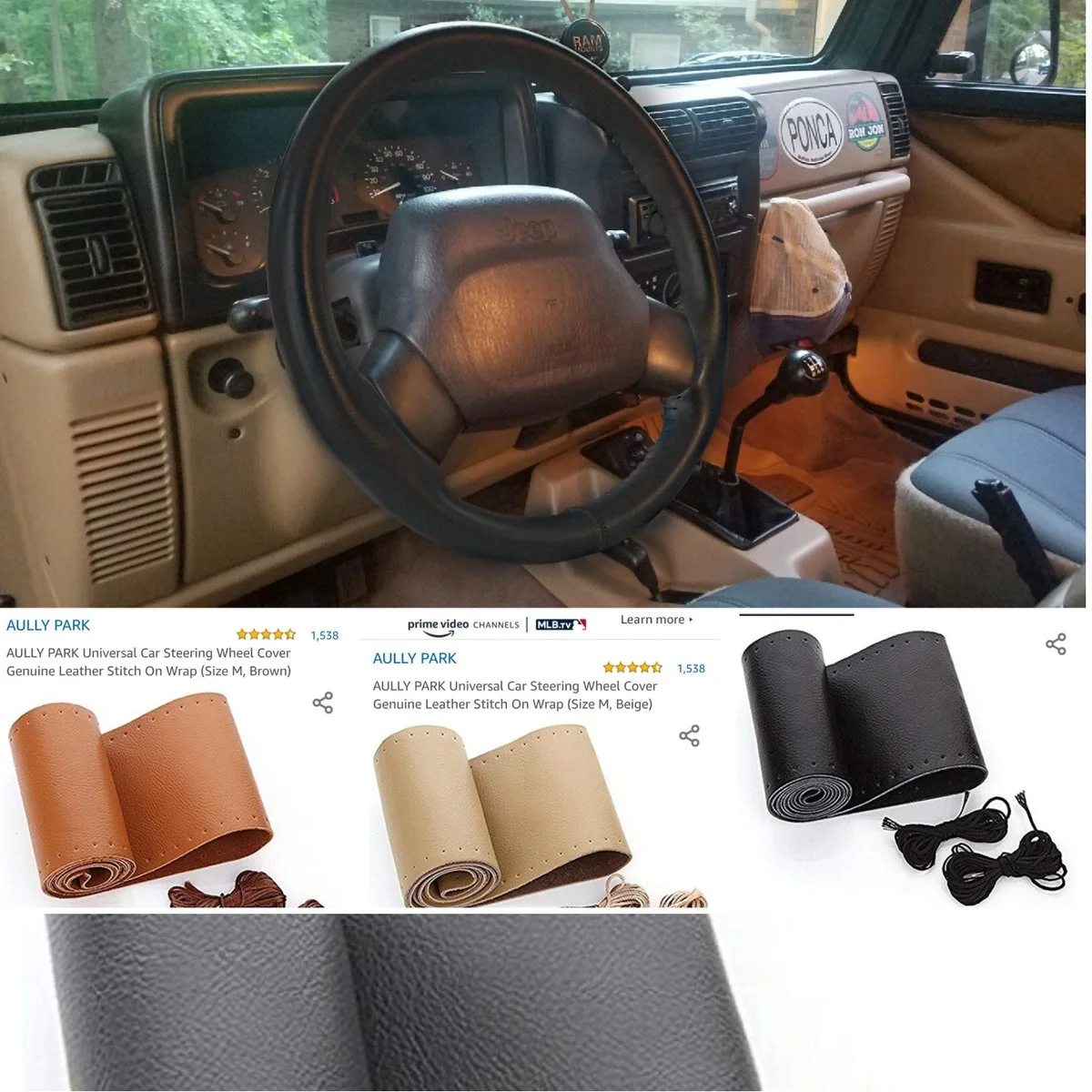

Really nice leather steering wheel cover
EROCK
Dec 1, 2018
151
Arkansas

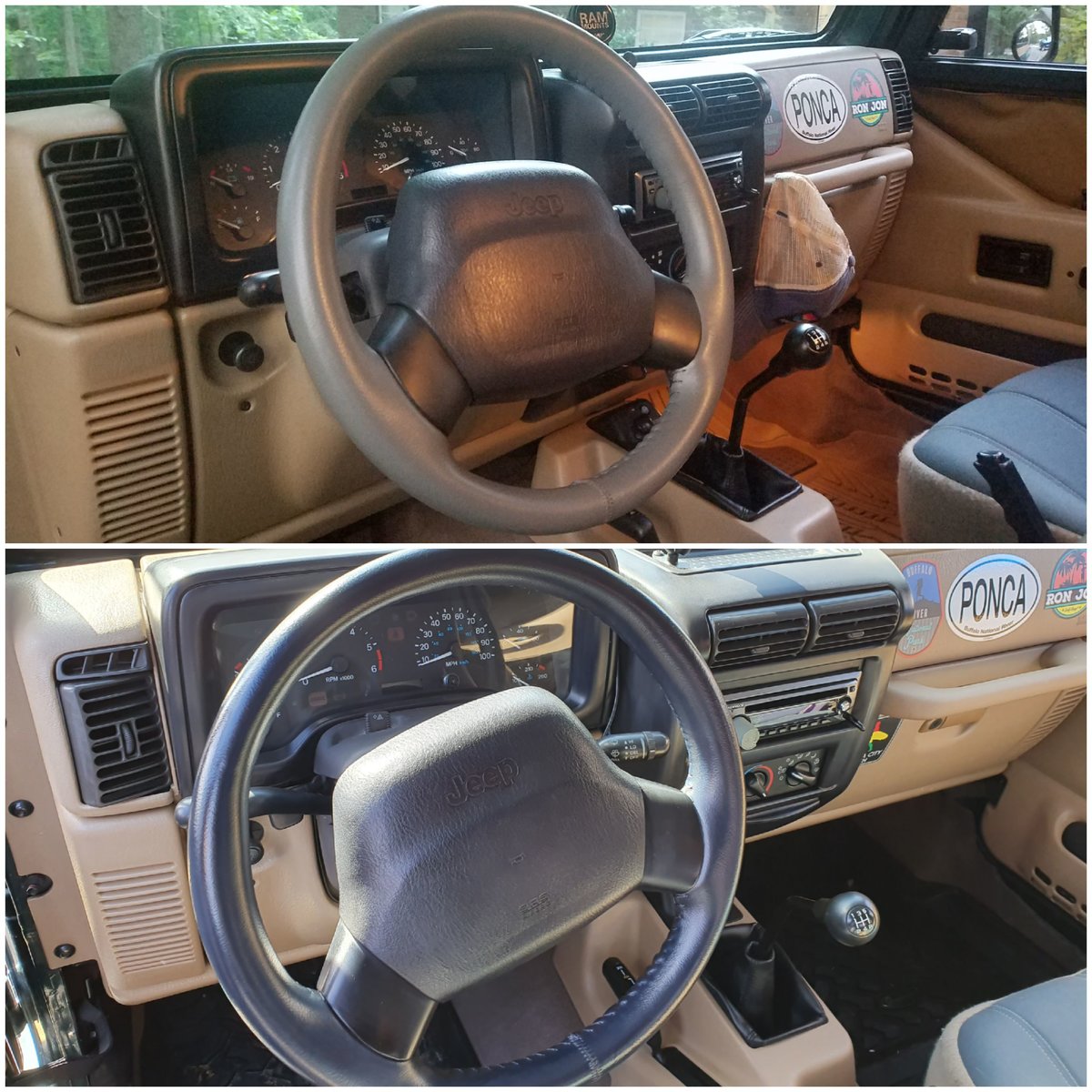

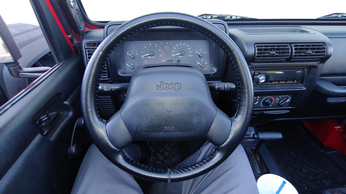

That's sweet. I wonder if I could get it to fold under like that after the fact? I'm not doing it over though. Way to tedious. lol. Looks like a really nice job man. I don't think black would be to black. It would tie in to your center dash bezel and other black items in the cabin.
Ya I tucked mine under before and sewed around it. You can lift the spoke cover a few mm by slightly pulling up on the top and bottom at the same time. Do not attempt to unscrew and take them off they will break with the airbag still installed. I think your right about the black I had a few min this morning and ran a pic though some editing to see what might look better. They're below.

There's this. But it's $42. I just don't think my Jeep is luxury enough for that. And it certainly isn't enough of an improvement to redo the cover. It was a long tedious process. Had I bought this in the first place - maybe. But I think the ten dollar one is fine for my Jeep. If I had a like new Jeep then ya. Mines not thrashed or anything. But if I had a brand new looking SE or something in the 03-06 vintage. I could see spending $60. But mines a '99 Sport. I'm fine with the ten dollar one. Feels like leather. And looks good on.

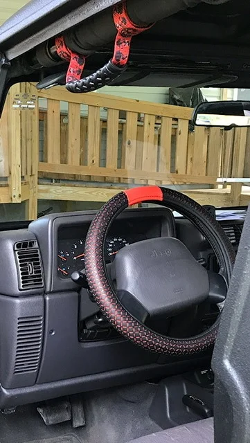

I just ordered the cover the OP linked too. I really like the idea of tucking the over on the spokes on the basic two spoke steering that a few others did, and it's the same one I have. I'm going to do that for sure.

I did mine the other day. This is very time consuming if you want it nice and tight. I don't totally love how I did the thread near the spokes, but overall, it looks decent, and feels great. I used a little hook tool to pull the thread tight after every 6-8 loops. This took me over 2 hours, but I also pulled the thread out a few times in spots and did it over until I liked it.

Originally, I bought the "M" wrap, but because I had removed my original steering wheel cover it was too big, so I ordered a "M-", and that is what is in the pic above. It came out ok, and it is tucked under the spoke covers as far as I could tuck it under, but I wanted the steering wheel fatter so just a little while ago, I wrapped the original "M" cover I bought over the other one. I like it better now, not only is the steering wheel fatter, but I got a little bit better and faster at doing it. Also, the larger cover fits better under the two spokes. This one came out quite nice.
It's very easy to get the hole count off from the front to the back after going behind the spokes. I did that on the original wrap, but I made sure not to on the wrap I did today.
