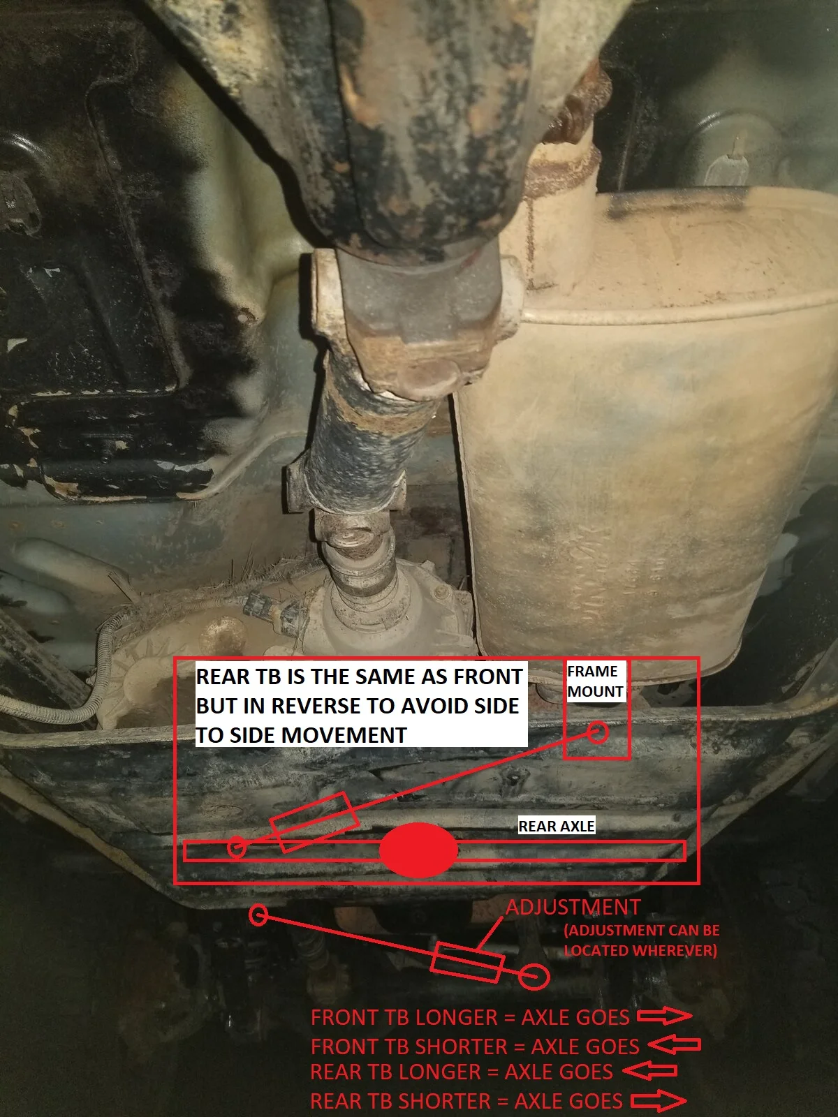

What are you calling the adjuster on the track bar? Were you cranking on the jamb nut with the track bar attached at both ends trying to adjust it? The only way to adjust the track bar length is to detach the track bar from one side, loosen the jamb nut and then twist the entire end of the track bar. It is impossible to adjust the track bar by cranking anything on it while attached at both ends.I had it connected. I'm thinking that was a mistake
sounds like you lengthened it when you should have been shortening it.I have bottom one. 3 pieces I adjusted while connected. Like I said, and cranked it out it pulled driver side outside of fender flare and passenger side way in. So axle was really of center and still not centered
Alright, you’re not stupid, ha, if you have the one with the adjusting sleeve, then it can be adjusted while connected, Ha. I was wondering.I have bottom one. 3 pieces I adjusted while connected. Like I said, and cranked it out it pulled driver side outside of fender flare and passenger side way in. So axle was really of center and still not centered
I don’t think so, if it’s shifted passenger, the frame side is passenger, shorter pulls the axle passenger side (lift essentially makes it seem shorter, or same effect.sounds like you lengthened it when you should have been shortening it.
Idk man I'm so confused and disgusted. It
Pictures.Do I still need to use the relocation bracket with the adjustable TB? could this be my problem?
I agree, but that can’t be the case and the diff be still 3” passenger, unless something is way f’d up, Ha.he said " cranked it out it pulled driver side outside of fender flare and passenger side way in" the passenger side of the bar is connected to the frame so lengthening it pushes it to the driver side out but his picture shows its been shortened too much or this is with the stock bar which would be shorter.
Dana 44 came as a option depending on who ordered it.Well something gotta be way f'ed up. Not sure on the rear I figured it's a 35 being 44 only came in Rubicon. What can be so f"ed up to cause this problem
