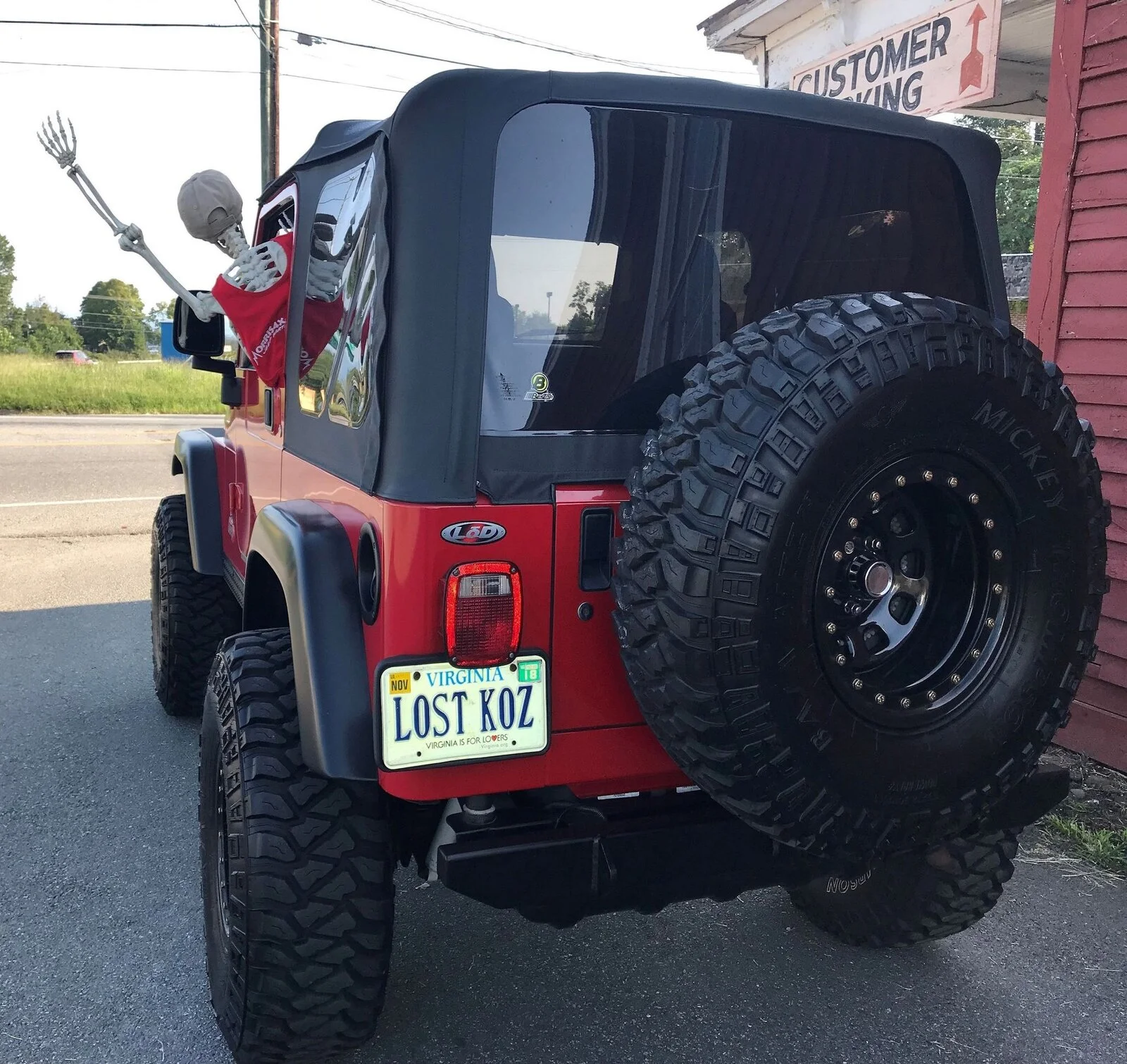

You're too picky. I like my LOD bumper, but don't need a swing away tire carrier and the added weight, for my tiny 35" spare.

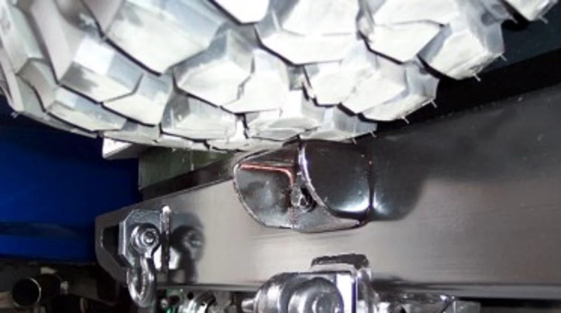

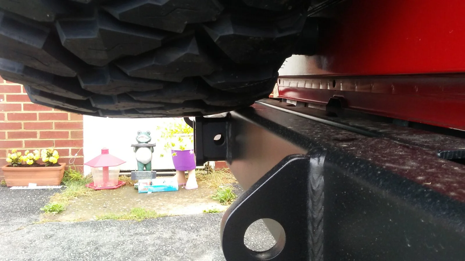

I have been holding off just keeping mine that way and throwing on a different bumper, this kind of pushes me that way even more, mine is just a little ol 33
I had a 35" spare on another Jeep for over 7 years and the tailgate still worked like new. The key is getting the weight off the hinges. I've done it a few different ways.
