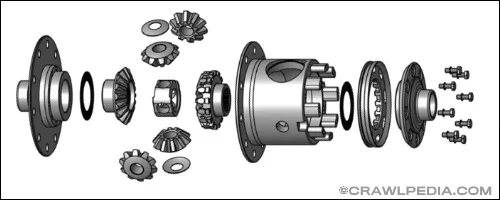

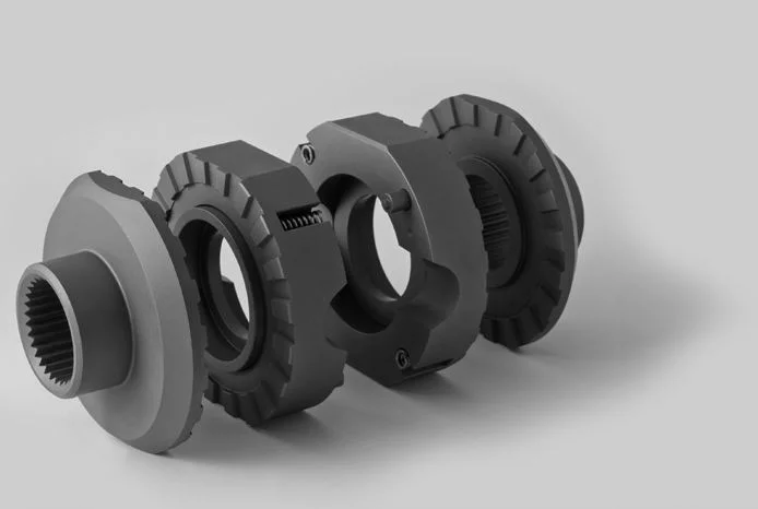

These are a few kinds of locker designs. Look for the locking plates. These need to engage each other.

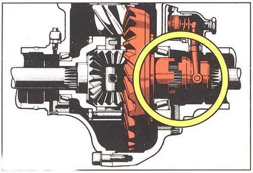

Jack up one side of the axle with the locker until you can turn the tire. Hit the locker switch and turn the tire until the clutches engage fully and do that several times after unlocking each time and turning the tire to make sure it is unlocked. You will notice that it takes from zero to several inches of tread movement to get it locked.
With it locked and assuming a mud tire, take one finger and pull against a lug with some force but no more than one finger's worth. While you are holding that, have someone hit the locker switch to turn the locker off. The tire won't move because it only takes a very small mount of side load on the clutch teeth to stop the clutch from moving. It has to be that way in order for the locker to engage. The actuator has to be able to overcome the force of the spring(s) that push the two halves apart. That means they have to be able to be compressed by the actuator force so they are relatively light.
That is how I thought it worked. Once engaged the load is on the clutch assembly with very little or no load on the actuator the clutch is taking all the force. I have not had one apart yet to really dissect it.
The actuator part has very little to do with it. The only load on the actuator is from moving the clutch to engage but that doesn't change whether it is locked or unlocked.
