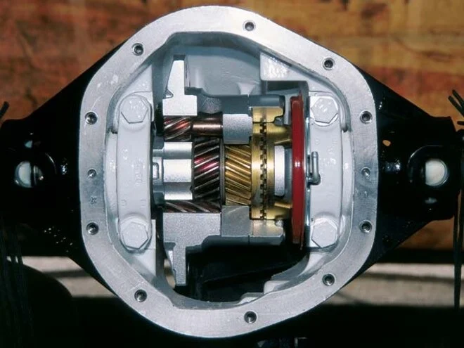

Here’s a cutaway view of the rear Rubicon Dana 44.
Slow down and pull the cover back off and follow the trail to the end. You need to keep looking at stuff.
The actuator visibly moves when pressurized. When pressurized, one wheel needs to be spun in order to get the locking plates to engage. There will be an audible click when this happens.
