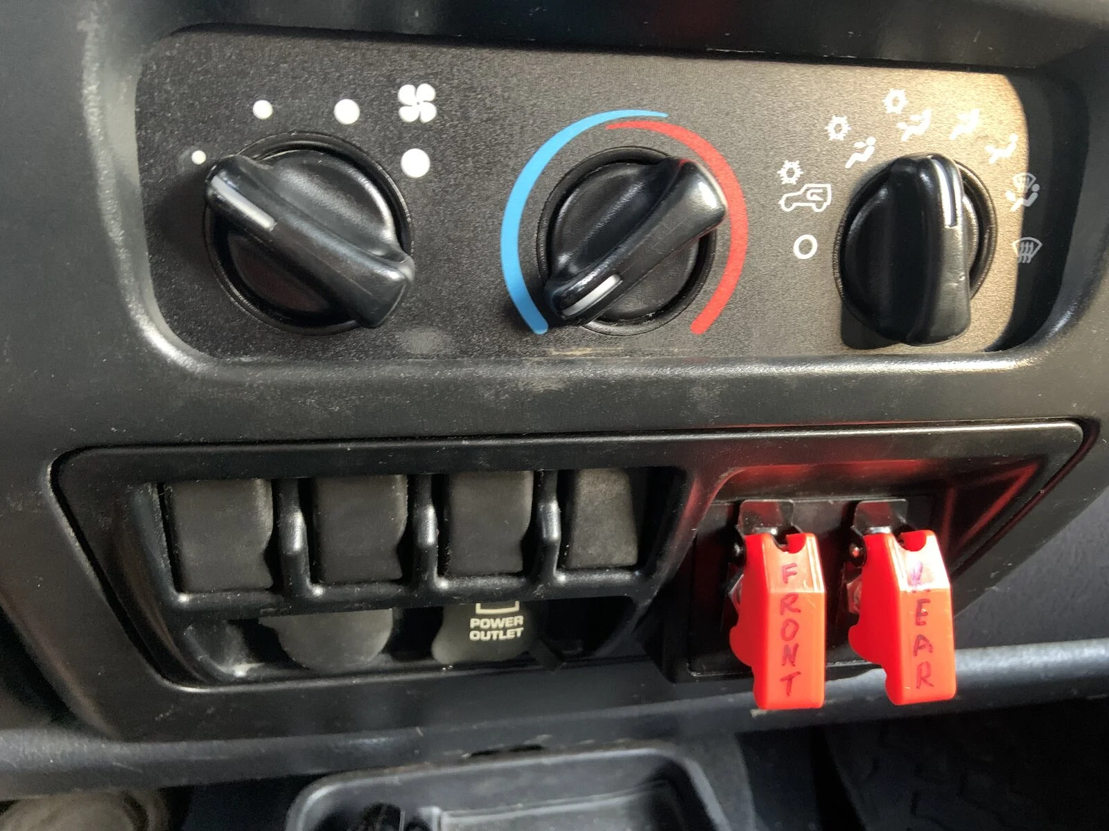

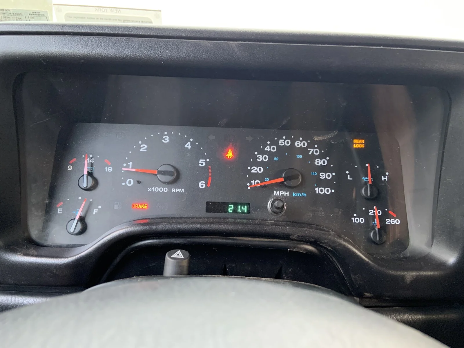

Hi Folks - I recently swapped my 2006 TJ Dana 30/35 with used Rubicon TJ Dana 44s. After making the pumps connected to both the axles and powered through two separate SPST switches, I am having some problems engaging the rear lockers. My dashboard light keeps flashing, but I hear the pump turning on and off. I tried putting the rear end on jack stands but didn't see that the wheels are spinning together. Any ideas on what might be the problem? My front one seems to be working fine although the dash light is not hooked up to the sensor since the guy cut the sensor wire at the tip of the sensor on the diff side, hardly any wire left to make the connections.
I tried driving in all modes (4 Lo, 4 Hi, 2WD) and making turns but the dash light keeps flashing. I even swapped the pumps between front and back, but still no luck.

The second picture shows "REAR LOCK" but that was blinking when I took the picture.

It doesn't matter what mode you're in. Once you flip that switch and the pump turns on it should lock. (May take a rotation or two) The sensor does nothing as far as the jeep is concerned, it's purely the pressure from the pump.
The first thing I'd do is simply swap the outlet from the front locker to rear at the pumps. If the problem reverses you know it's a bad pump. If it doesn't I'd start looking for leaks in the system. If you can't find any leaks I'd remove the diff cover and see what you can see.
It shouldn't be turning on and off if it was working correctly so I'm betting it's either a bad connection or the pump diaphragm is shot.
First back out the fill plug on the rear diff. If screwed in too far it will jam the locker.
If the pump turns on and off and on and off, you have a leak somewhere in the system. Hose, diff nipple, hose inside the diff, or actuator.
