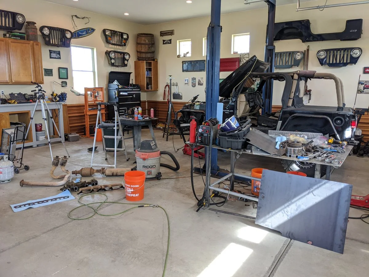

Great write up! I'm in the middle of replacing a manifold/exhaust gasket anyway and figured while I have everything out I might as well get this done too. Also got a new valve cover gasket. Contemplating on the oil pump while I'm in there. I have a lift in my shop which has been an incredible help with everything. My body and bones got tired of the cold concrete. Been there done that. One thing I told my wife when we decided to build a new house....I need a shop. Very fortunate to turn it into what I've always dreamed (y)
Thats a very good woman you have there.

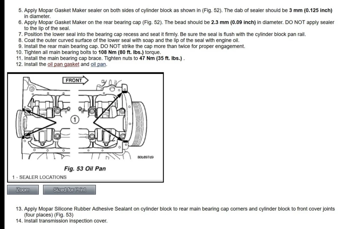

Hey there , just a small question , did any of you used mopar gasket sealer compound on oil pan while fixing RMS .Thanks
I used anaerobic gasket maker on the front and back of the pan as shown in step 14. So far no leaks on 2 pans and 15k miles or so.
I went to pick up parts today at local Jeep dealer since I found mopar oil pan gasket better and difference is $15 in price compering to Fel Pro @amazon . One of the Mechanics suggested to me to spray some of the Mopar Sealer Gasket Compound on both sides of my oil pan gasket to make installation easier so I was wondering did any of you use this Spray on Sticky Compound ? Cheers
I used a bit of black RTV silicone on each side of the gasket at the front and back where the bends in the gasket are. I used the fel pro gasket though.
I don’t understand this . Use rtv or anaerobic and what corners do you mean after installing bearing cap ?
Yes , check the picture , I did mine and it's not leaking
Reactions: BigWheel88
The anaerobic sealant goes between the bearing cap and the block. Small amounts. I referred to the service manual I found on this forum as far as how I applied it.
Then I used some black rtv at the corners of the oil pan gasket itself. I also laid a thin bead of rtv on the oil pan gasket against the bearing cap itself. So far I have great results and I’m even running synthetic at the moment.
Got it
I took it as
did you put rtv inside the half moon of the bearing cap where bottom half of seal drops in. I’ve seen people do that in videos . I know about the anaerobic on metal part of cap and on the block. And I understand the oil pan rtv too.
Got it
I took it as
No need for any sealant on the seal itself. Give it a light coating of oil before installing, wet your fingers and massage it in.
I would also recommend installing each seal portion with an offset. Leave a little bit of the seal hanging out of the block and then leave it pushed in a little bit on the bearing cap, so where the seals meet isn’t on the same seam as the block to bearing cap.

Did you install anaerobic on both bearing cap and block or just cap like Chris’s write up. The fsm calls for a bead on the block too. That’s what’s confusing me. But yes offset sounds good
Whatever the FSM said. I think both. Mine is a 2004 and actually doesn’t look the same as the one in the writeup - that type of seal can’t be offset.
I forget what year they changed over but if yours looks a little different when you take it apart, don’t be alarmed.
