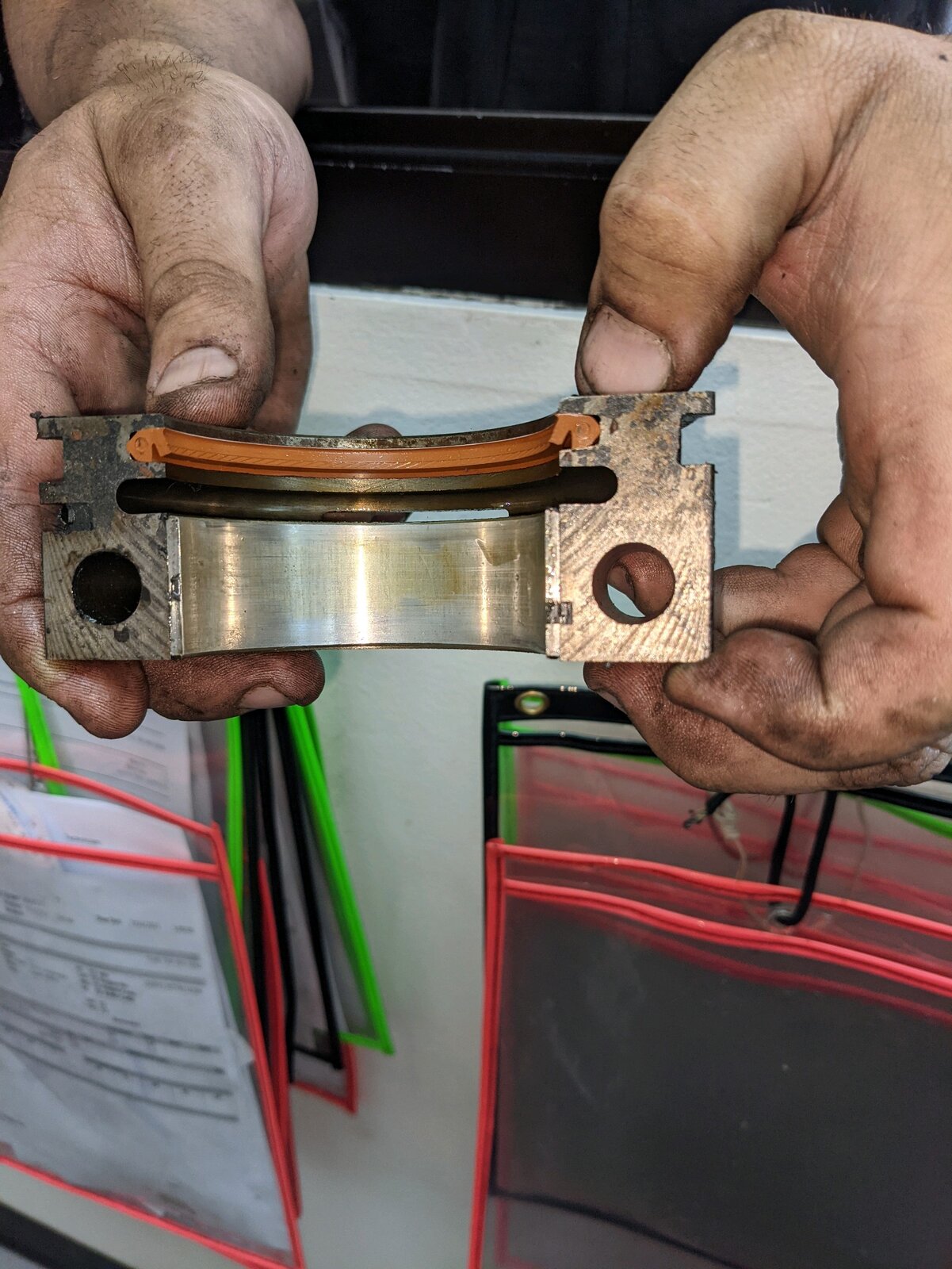

Im so frustrated, he said it might be crank bearing, enclosed is a picture
Nothing really looks that bad to me. If that’s a pic after they have already tried I don’t see any Anaerobic sealant that’s an important step. I don’t know how bad it’s leaking but if you keep oil in it it won’t hurt anything but your driveway lol. Lots of people are running around with leaky rear main seals
