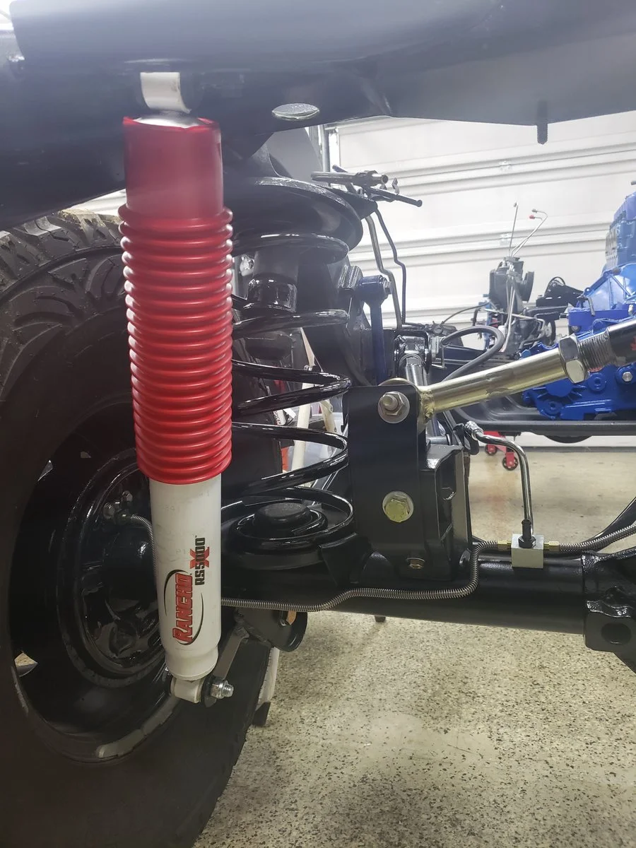

Hello all,

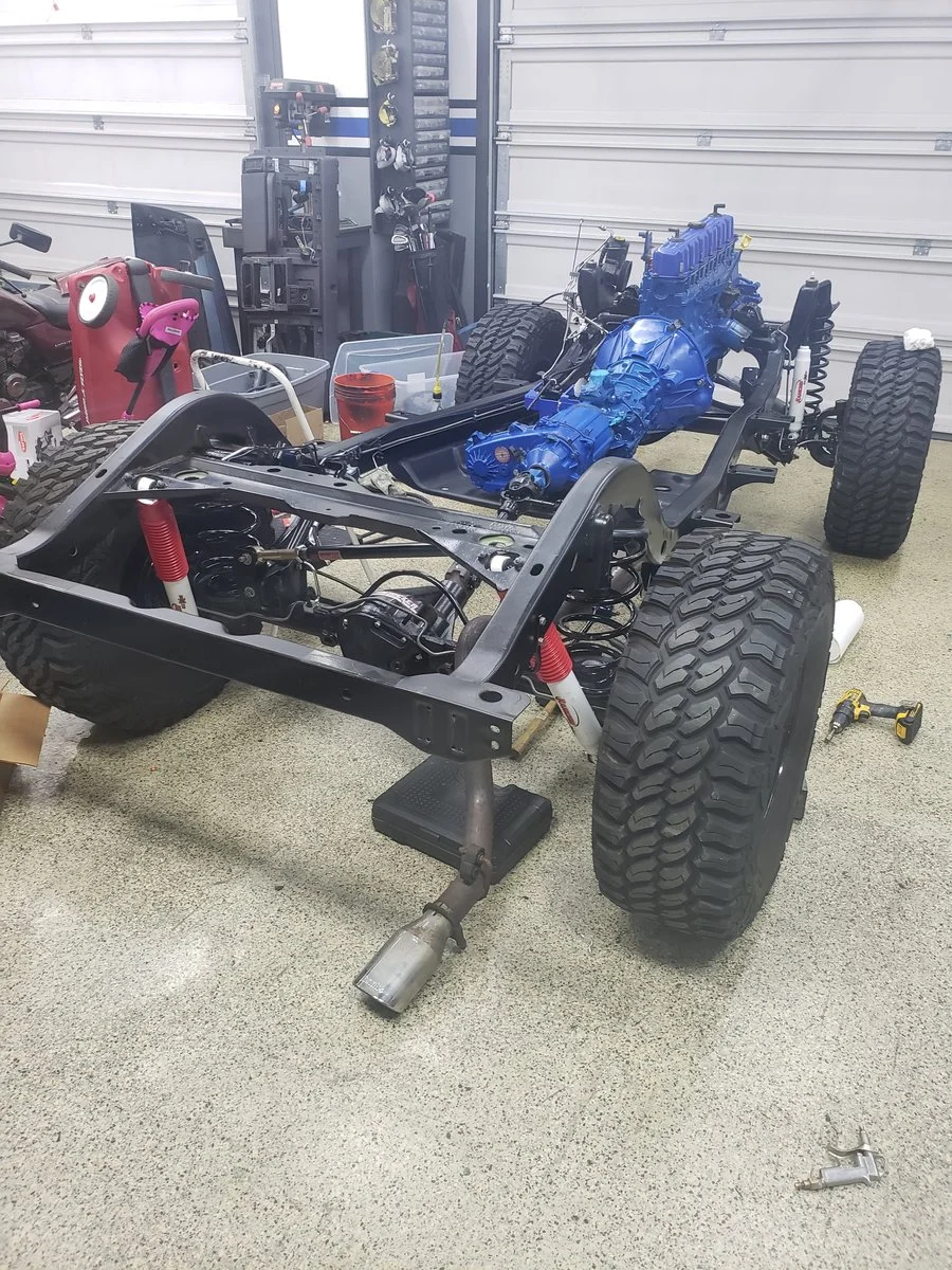

I'm currently rebuilding my 1999 TJ down to the last bolt driven by the need for a new frame and replacing the torque boxes in the tub.
I installed clayton offroad resr shock relocation brackets on the new to me dana 44 because it was missing any shock bracket at all. I have 3 inch lift springs and installed ranco rs5000 shocks for a 2-3 inch lift. When I installed the rear shocks, I had to put weight on the rear frame to get the springs to compress about. 5 inches to be able to get the shocks to bolt up. So now, at neutral state, the shocks are fully extended and there is no more uptravel... in fact springs are slightly compressed.
Now there is no tub on the frame yet or gas tank which would help to compress the rear, but I do not recall this when I took the Originals off.....
Is this typical? Is it bad to stroke oit the shocks...how much additional travel should the shocks have when at a neutral state? Do I need to buy longer shocks like the rs5000 for 4 to 5 inches of lift?
Thanks in advance for the advice.

This is probably the closest you can get without having the body on to check for tire clearance
