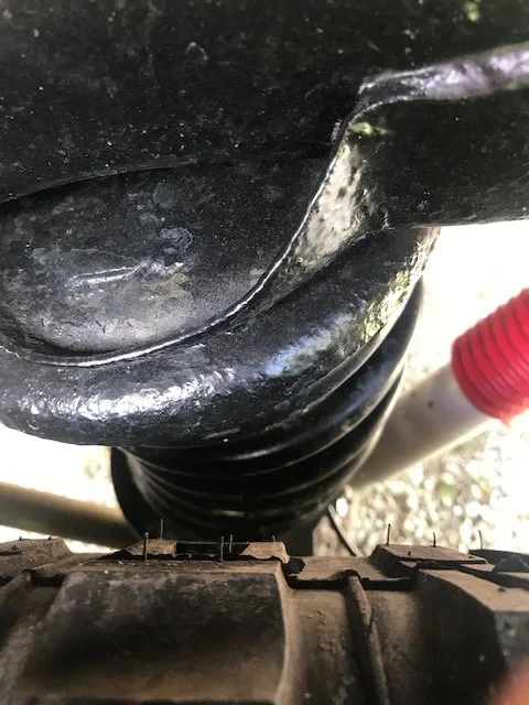

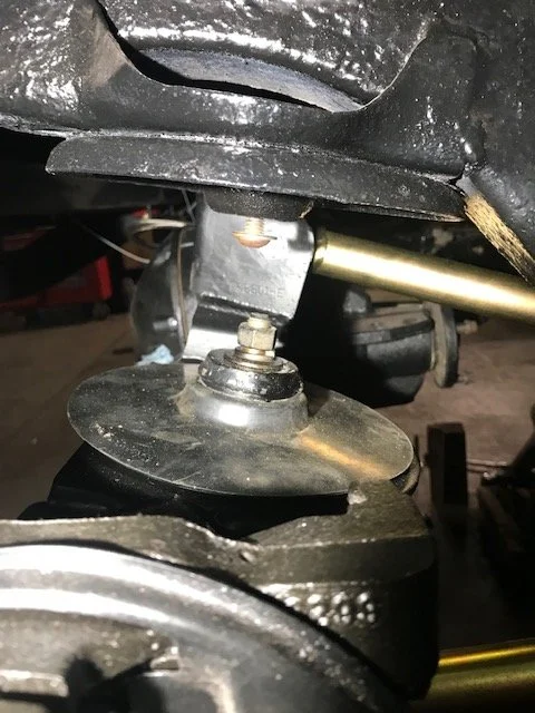

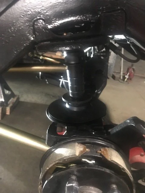

Here is a pic, the track bar bracket is about to hit the tub so I had to stop. What are your guys thoughts with what you see here?
I'm not expert, but I think if you extend your bumpstops, you won't have a problem getting the to make solid contact.
Yes. I agree. The question is if these need to be in line with one another, or if the perch angles look goofy.
Get the pinion set. That will change the bump stop alignment (for the worse). Splitting the extension between the upper and lower can help make the the bumps touch. There comes a point where the upper spring seat needs to be moved to make it work again.
They need to be inline together enough that they make good solid contact and can't slide off one another. You'll have to answer that after pinion angle is set... If it's not already.
