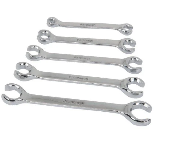

Can you get a flare nut wrench in there?

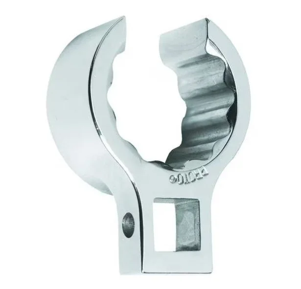

Or a 12 point crows foot?
