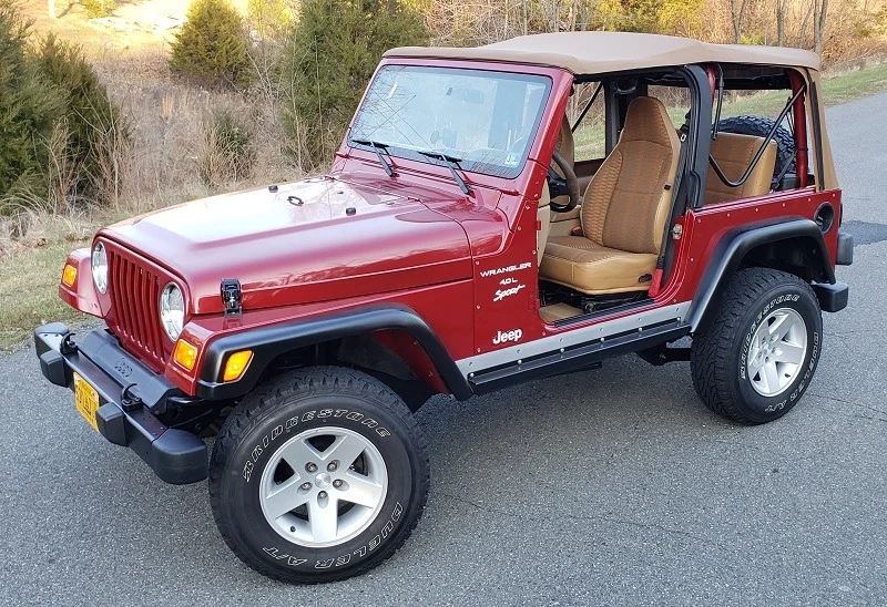

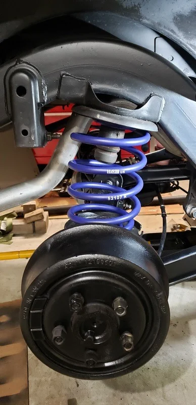

As an example, this was my last build, which had H&R springs, 1.25 BL, and 31" tires. At one point it had a Savvy TT, with 17" of clearance at the skid, on 31" tires.
As I ended up using mine more for driving and hunting, I’m almost convinced to undo the PO hack job of fitting 35s (with issues such as rubbing everywhere that I haven’t fixed) and go to something like this. Thanks for the pictures. Good inspiration
