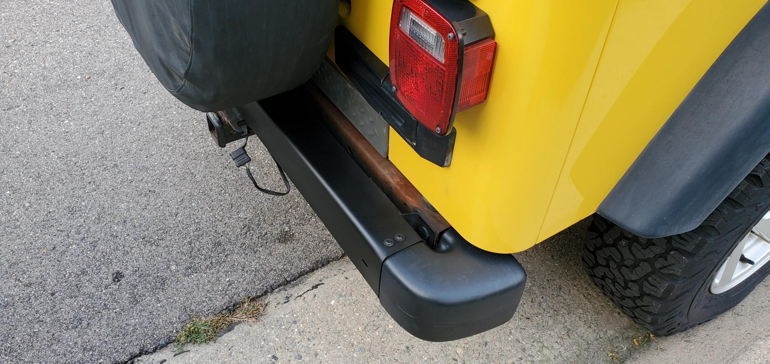

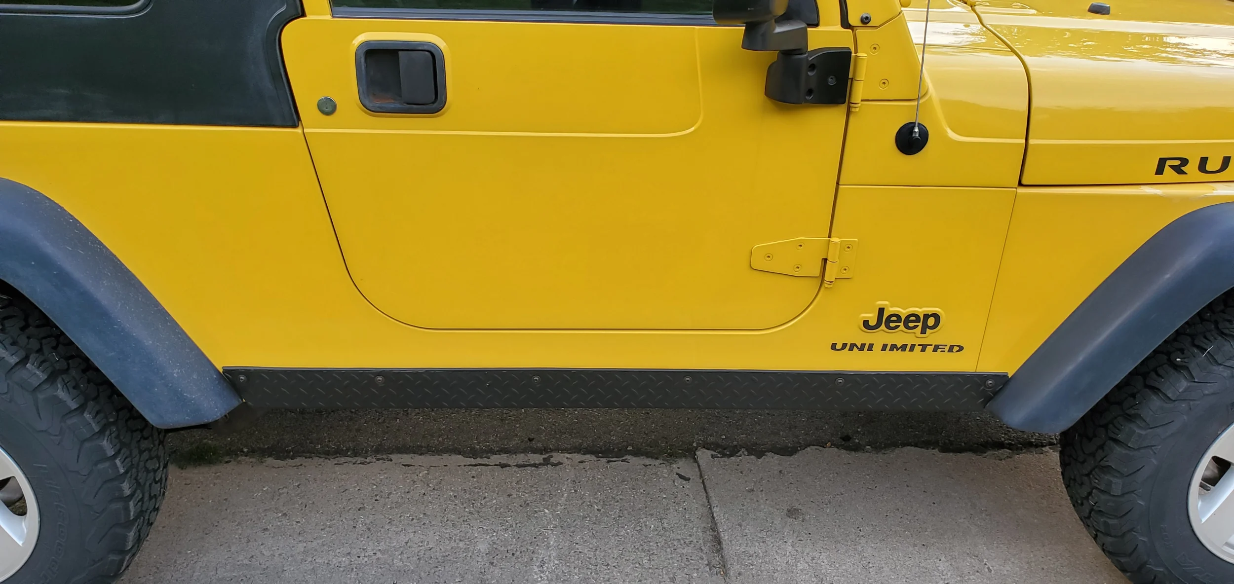

Eastwood's 2K epoxy - rat rod black is a really good match for the black on Rubicon flares, the rocker panels etc. But very expensive for rattle can paint. Does not require a clear coat. Painted my dad's bumper and rocker guards for him in September last year and they're looking great. I'll be doing my rubi flares, rocker guard and maybe bumpers.

View attachment 696807View attachment 696808
