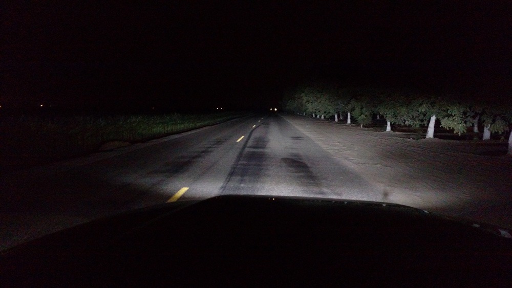

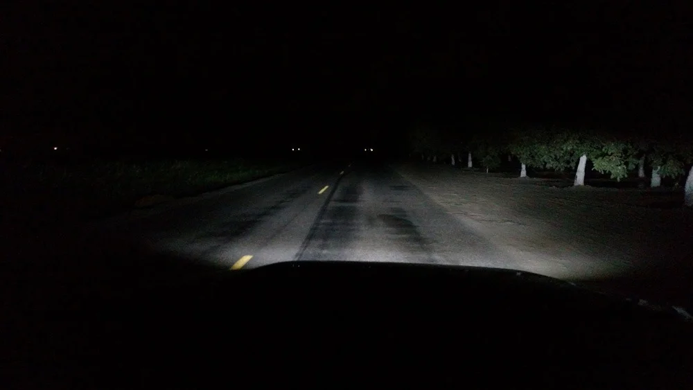

A video and some pics of the headlights in action
—-> VIDEO <—-
Low Beams
High Beams

Did you have to make any major aiming adjustments, or were yours pretty close after installing them?
What you see is them installed without any adjustments. As long as you don't touch the alignment screws when removing the old lights you shouldn't need to touch them. Mine might need a small tweak since I didn't touch them after the lift installation, but I'm going to wait until after I install the winch to get them dialed in perfectly.

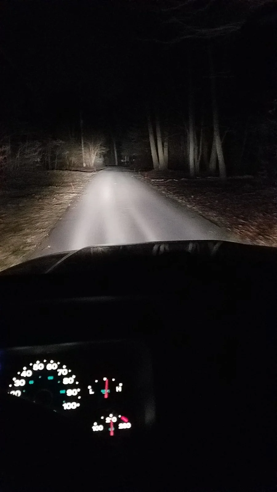

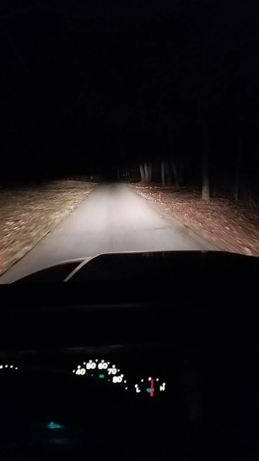

For those of you who live in snowy/cold climates, look into an H4 conversion with relays. For about 150, you can dramatically increase the output of your headlights and stick with a halogen bulb to help melt snow. I did it and am very happy with the results.
Dim
Brights
